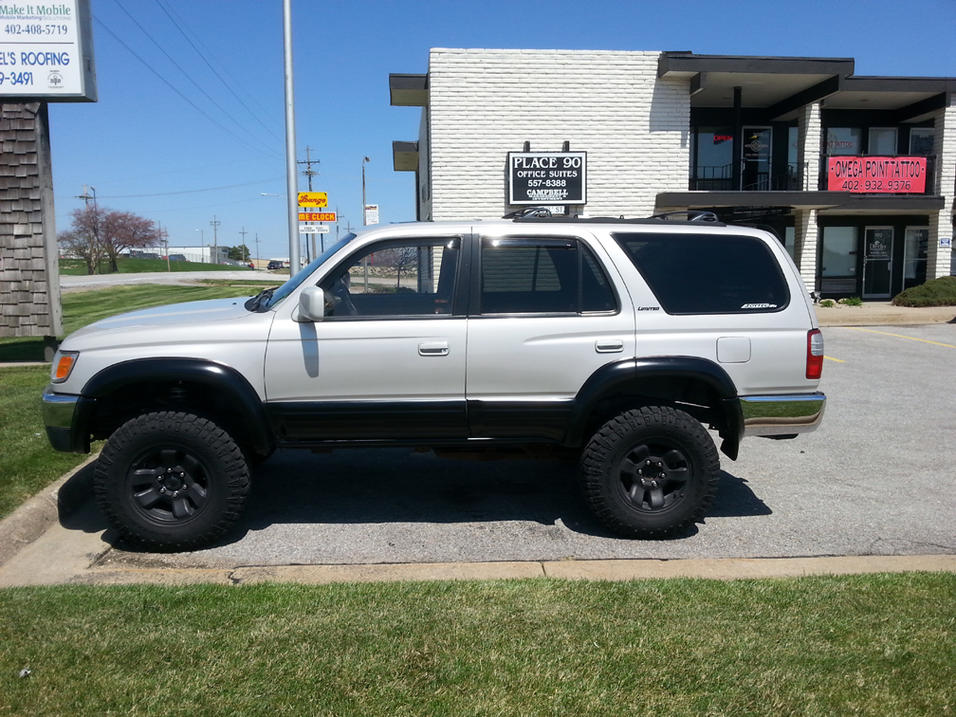

You have any pics of your runner?
Thanks for all the input. I'm going with the 650's up front because I am going to add a bumper and winch. Here's a pic of last weekend.
