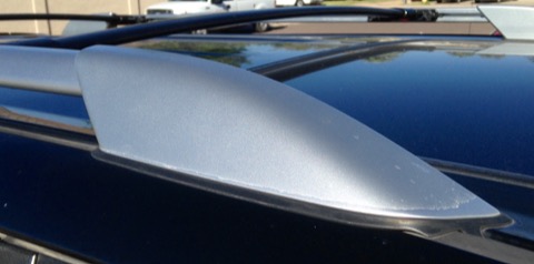

Any Tips to remove Front Limited Roof Rack Caps
Az4runnin
Senior Member
The Backs come off pretty Easy. The Fronts dont have the Gap the Back ones have to Slide under and Lift. Just dont want to Break them. Finally cooling down to do the Swap to the Sport Tube Style.:cheer2:

OLD thread, but quite useful, helped me remove all 4 end caps without breaking a single tab.
i went a step further, and used a heat gun to get the plastic, a bit malleable, used a flat screw driver to pry out the front tabs..and to push out the inner tabs as well.
