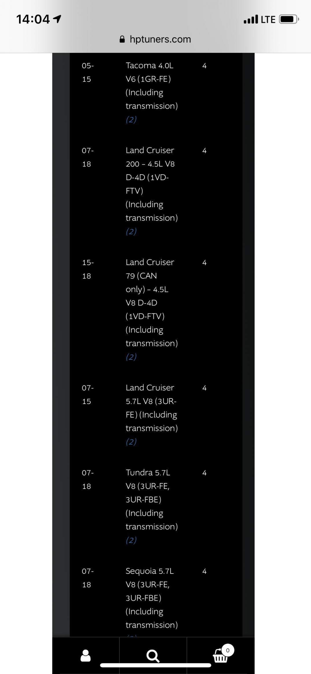

There's no complete plug and play tuning system for Toyotas. HP tuners has been able to crack some models and years but nothing for Runners. When they do, you can show up to a dyno and have it tuned however you want. Until then it's canned tunes and most require a new ECU to go back to stock. You may not be able to tune the way you're thinking.
