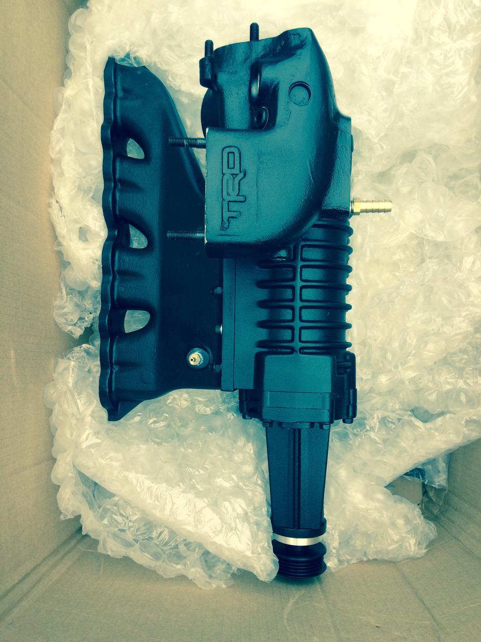

See above but for you S/C'd 5VZ's I'll have to pull this TRD/LCE high boost kit out of it's box. :moon: :flamethrwoer2: :car:

Darn it...I really want to boost my 3rz now! I'm going to start looking for used supercharger kit.
I looked for 2 years, they are rare in the used market. Best place to look is Tacoma World & Custom Tacos. I bit the bullet & bought a brand new one from LCE.
Hard to find as Scramble said, I got mine from a member on TacomaWorld.
Magnuson rebuilds them just in case you find one with some miles on it.
Mine was given new bearings, oil, nose cone, rotors, and have been running it for 50k without trouble.
