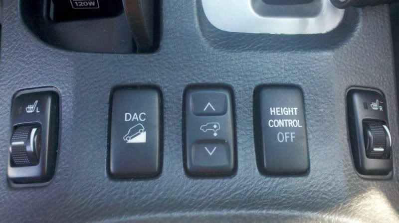

smokers accessory kit.
RAS switches
Thank you for the response bossman but what I'd like to see is the connectors underneath.
I didn't see any pictures, but if you have the towing package there is a connector for an electric brake controller. I am not sure if it is in the same area or not.
[MENTION=136099]Ratubbs[/MENTION] The upper one in your picture that has the 2 wires is for the optional inverter Power Outlet 115v and the bigger one in the lower portion of your pic is for the optional Smoker's Kit.
