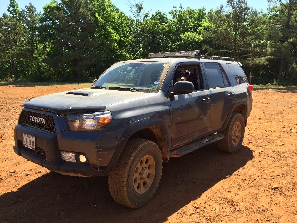

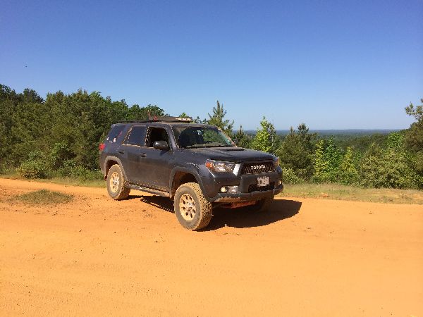

Sorry to double post but I found a pic on my phone. Ironically, the same day I learned how bad they are in the mud. LOL!!

Thanks for the informative post and the visual! Your wheels are the exact ones I will be buying, the MK6 17x8 ET-10. With just my slight lift at 1.74"(might have to bump up to 2.5"F) and the fender forward mod, I hope they won't rub on the uca's.
When you originally had these tires installed, pre-lift, was there any rubbing on your factory uca's?
No worries! Factory UCAs were good to go. However, I only ran these wheels and tires for a week (like 5 days) before the lift went on. I did the UCAs at the same time as the lift so don't have any lifted with factory UCA info for you.
lol did you even air down? if you did, it would have done a lot better, mine have done great in mud, even muddy snow
Actually yes. They are sitting at 17 psi in that photo. My set is E rated due to all the rock here in central Texas. They don't really deform much until they're actually on an obstacle. They're like freaking Velcro when it's dry (which is 99% of the time).
EDIT: In the pic you can clearly see the tread pattern complete clogged.
All depends on what type of mud I suppose. For the stuff we have they're no good and I stand by that. They get too gummed up and don't clear leaving no tread for traction. More aggressive AT tires like Duratracs do *much* better here. That will be different that what's in DFW, the panhandle, East Texas or the wide variety on the coast.
