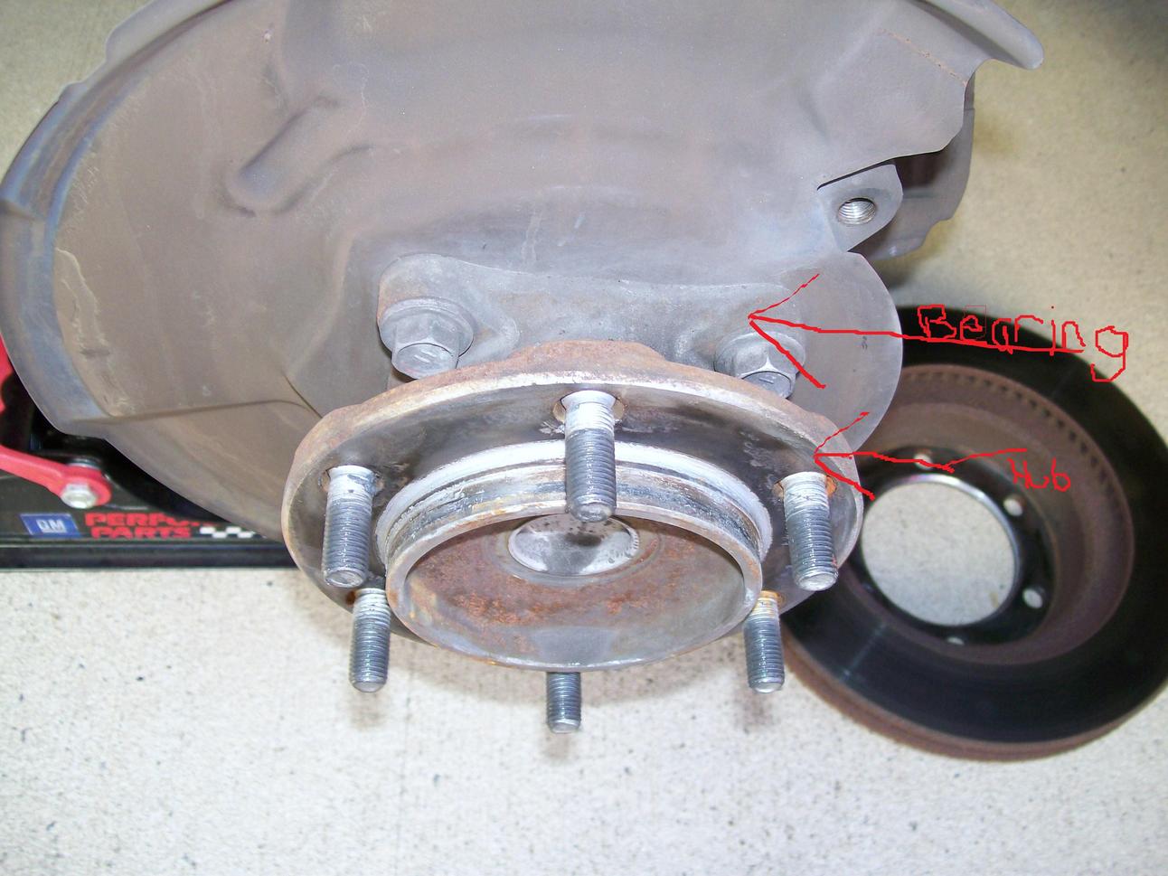

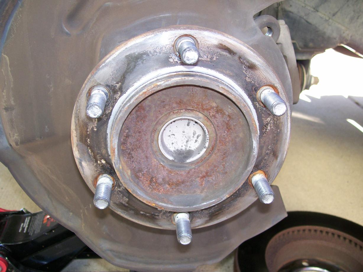

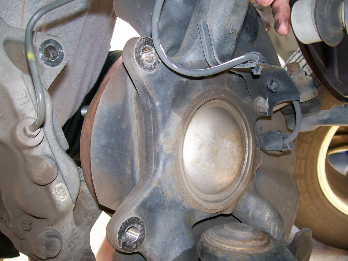

Well it is not as easy as you would think. My 04 is a 2wd. It is slightly different than the 4WD. The Axle adjusting nut that is holding everything together comes off from the inside (where the CV axle would be on a 4WD). No obvious axle nut like a 4x4. (see pics) The outer hub portion is pressed into the (bolt on) bearing assembly. I have not found where you can get these as one complete piece (Hub and bearing). I was considering taking the the steering knuckel in and having the press work done at a shop.

Looking harder at the parts and rechecking the Timken replacement, I see what you mean now. Couldn't you just take the whole assembly off (the bolts behind the hub will remove the assembly) and take it from there to a shop? A lot easier than taking the whole spindle in.

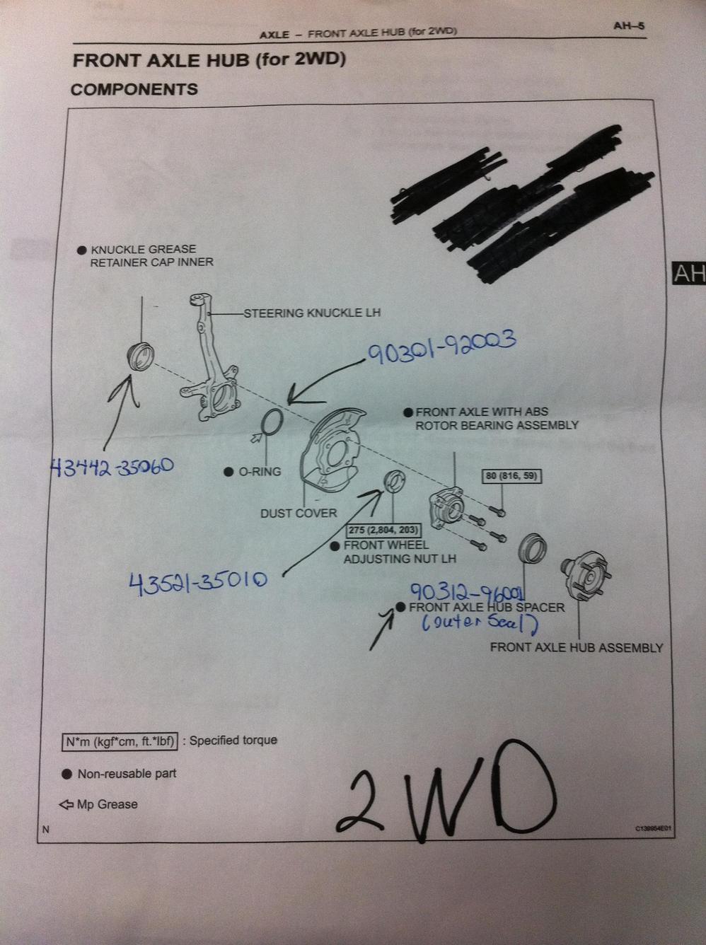

I Got a Bearing assembly for $41.00 Shipped off Ebay (a Carquest part). You can get a Toyota part for $125+shipping off Conicelli Parts Center
I also order odered:
Knuckle Grease Retaining cap inner - Toyota P/N 43442-35060 - $12.65
O-Ring - Toyota P/N 90301-92003 (seal between the brake dust cover and the steering knuckle) - $3.51
Axle Bearing nut - Toyota P/N 43521-35010 - $11.97 (This is a "Staked" nut and hense Non-reuseable)
Outer oil seal - Toyota P/N 90312-96001 - $10.49
Ordered above parts from Conicelli Parts center for a grand total of $47.12 Shipped. The Local Toyota Stealership (Fred Anderson) wanted $78.80 for the same 4 parts. All 4 parts are listed in the Toyota service manual as "Non-reusable) That same dealer want $800 to do the entire job for just the front left wheel. No way in hell!!!!!
So Grand Total at this point is $88.12 into parts. I have a local shop (http://www.performance-chassis.com/) that does alot of track cars suspension and has all the right tools to pull and press in the new bearing assembly and remove and install the Axle nut (Which requires 203ft lbs of torque). They also did the alignment after I installed my lift on my 08. You also need a 4 pin spanner wrench like this one (http://www.amazon.com/OTC-7941-Toyota-Bearing-Locknut/dp/B0002STS0I) to remove the axle nut. The Shop is going to charge me a straight hourly labor rate for whatever time it takes them to remove & install the new bearing and remaining parts into the Steering kunckle I am going to bring them after I remove the entire steering knuckle assembly from the vehicle. (maybe $80)

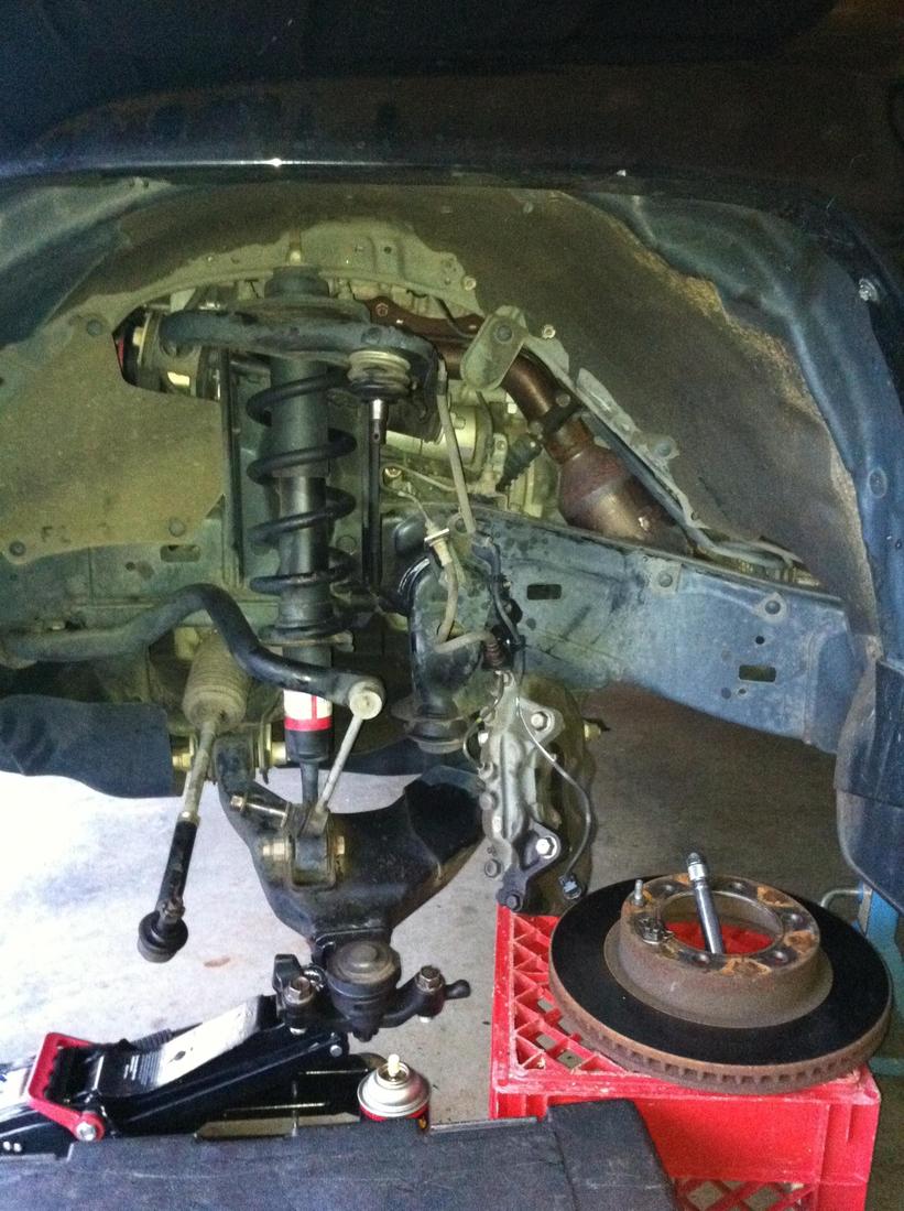

The Steering Knuckle is at the shop getting the Bearing and all seals replaced. I Should have it back in the next couple hours. It only took me about a Half hour last night to remove it from the vehicle. I can say a pitman arm puller was a big help. Much less pounding to break the upper ball-joint and tierod-end loose. Just tightened it down good and snug and smacked the joint with a hammer. I suggest using a small wrench to tighten the puller so you don't crush the bolt. Also multiple days of liberal amounts of P.B. Blaster to all parts involved helped to. Here is a pic after removal.
