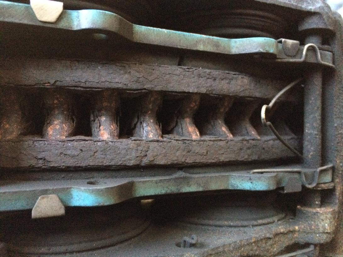

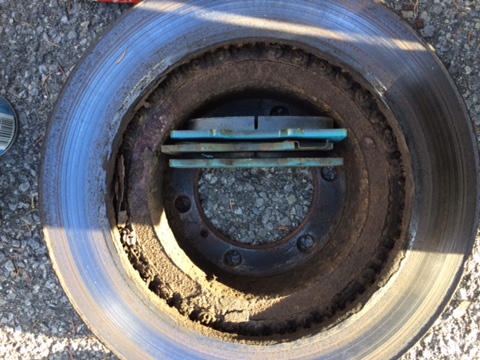

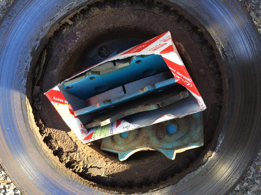

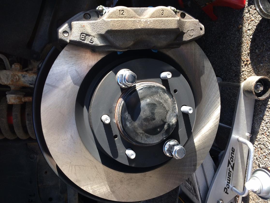

These are the joys of living in Canada, where cities and towns use road salt like syrup on pancakes. These brakes are just one result after a mere 30,000 kilometres (19,000 miles) on my Ltd.
I'm hating all you Californians and Texans right now.
That [MENTION=65614]Antman[/MENTION] and others are close to 160k kms on originals is hard to fathom.
