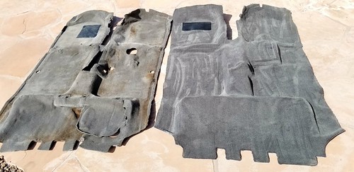

Stock Interiors .com Medium Grey Ultra Plush with Mass Backing
2018-02-11_09-51-17 by Park City Rich, on Flickr
Should last another 16 years
