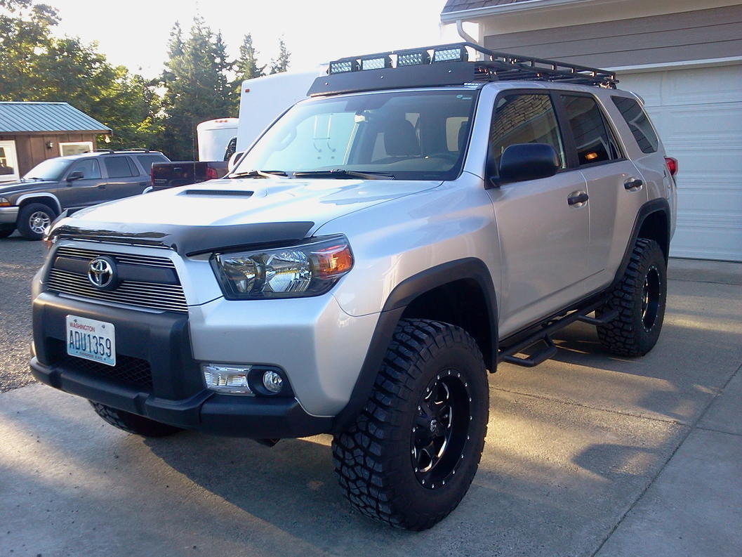

Here is a before (only one I have, sorry) and after from my phone. I will get some more and hopefully of a comparison with a twin at my gym.
BEFORE:
<table style="width:auto;"><tr><td><a href="https://picasaweb.google.com/lh/photo/mXbVQ6ssh3Flnoiy5VIWTg?feat=embedwebsite"><img src="https://lh5.googleusercontent.com/-7e8OJyjLAHs/TlQ3N9np53I/AAAAAAAADH8/yNXhIlTkAGk/s800/IMAG0619.jpg" height="478" width="800" /></a></td></tr><tr><td style="font-family:arial,sans-serif; font-size:11px; text-align:right">From <a href="https://picasaweb.google.com/will.ream/4Runner?authuser=0&feat=embedwebsite">4Runner</a></td></tr></table>
AFTER:
<table style="width:auto;"><tr><td><a href="https://picasaweb.google.com/lh/photo/z1zPb23ZdSgHjSD3yGEQIg?feat=embedwebsite"><img src="https://lh3.googleusercontent.com/-CwCExi-PAcA/TlQ3NyRDFUI/AAAAAAAADH4/kS7H5e6w5ok/s800/IMAG0630.jpg" height="478" width="800" /></a></td></tr><tr><td style="font-family:arial,sans-serif; font-size:11px; text-align:right">From <a href="https://picasaweb.google.com/will.ream/4Runner?authuser=0&feat=embedwebsite">4Runner</a></td></tr></table>

Not planning on going crazy with a heavy load but will definitely be adding a Gobi rack on top and am considering the storage drawers in the back. Might be a little over kill for the heavy coils, but I like a stiffer ride, especially with no dive while braking. The tech I spoke with at the shop recommended the stiff as far as ride and he was running heavies on his Tacoma, so not a ton of weight, and said he hadnt expirenced and major problems.
And as far as the apparent sag in front, that was user error...I didn't get the spacer put in so that's why it still doesn't look level. I am sometimes a little dumb, but will get that corrected on the next time in. [Point and laugh]

I had the stiffest spring rate on mine and couldnt come to terms with the 2" rake. I just installed my Gobi and also went to a medium spring rate on the rear. The stiff spring is as if you are constantly running a 450lb load all the time, medium is 225lb load. (Per ARB Renton, Wa) I kept the front stiff and love the ride. Still has a slight rake but it will probably settle in a little more. Here is a pic.
