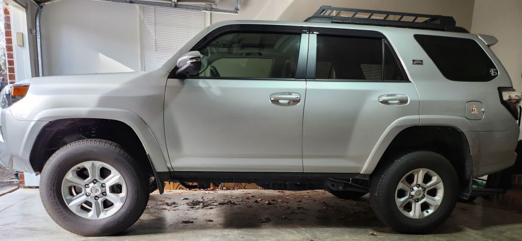

Been debating myself what OME set to get. 4 runner with no roof rack, no winches or new bumpers planned. Off Russ premium keeping it stock.
Looking at the following OME set ups.
884/895e
884/895
885/895
884/889
Also considering going 90016/60086 softer valve shocks compared to 90010/60080 regular valves shocks.
Mudify puts softer valve shoxhs with their standard load 884/895e and 885/895 set up.
I like to keep a little rake, as I hate the look of when the front is, or appears to be, higher than the rear.
Hard time figuring out, cause seems many of the suppliers sell complete OME kits with different set ups.
Well gaVE ARB USA a call. They recommended for a 4 runner with no added bumpers, winches, racks etc the 884/895 set up with regular valved nitro shocks.
If went with 895e rear would level it out more so but run the rush of having the front higher than rear if ever loaded up the rear with gear.
So looks like 884/895 is the way I’ll go.
Front looks higher than the rear. What number spring and shocks did you use?
Could be the camera angle, the front wheel looks bigger than the rear wheel too, am sure that's not the case.
Look at the blinds behind the drivers side view mirror. They angle down also to the right. Not sure what caused that to happen to the picture.
