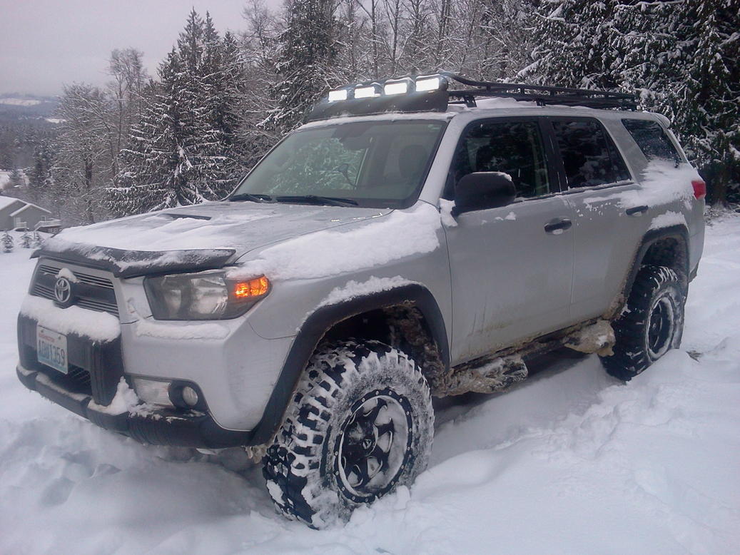

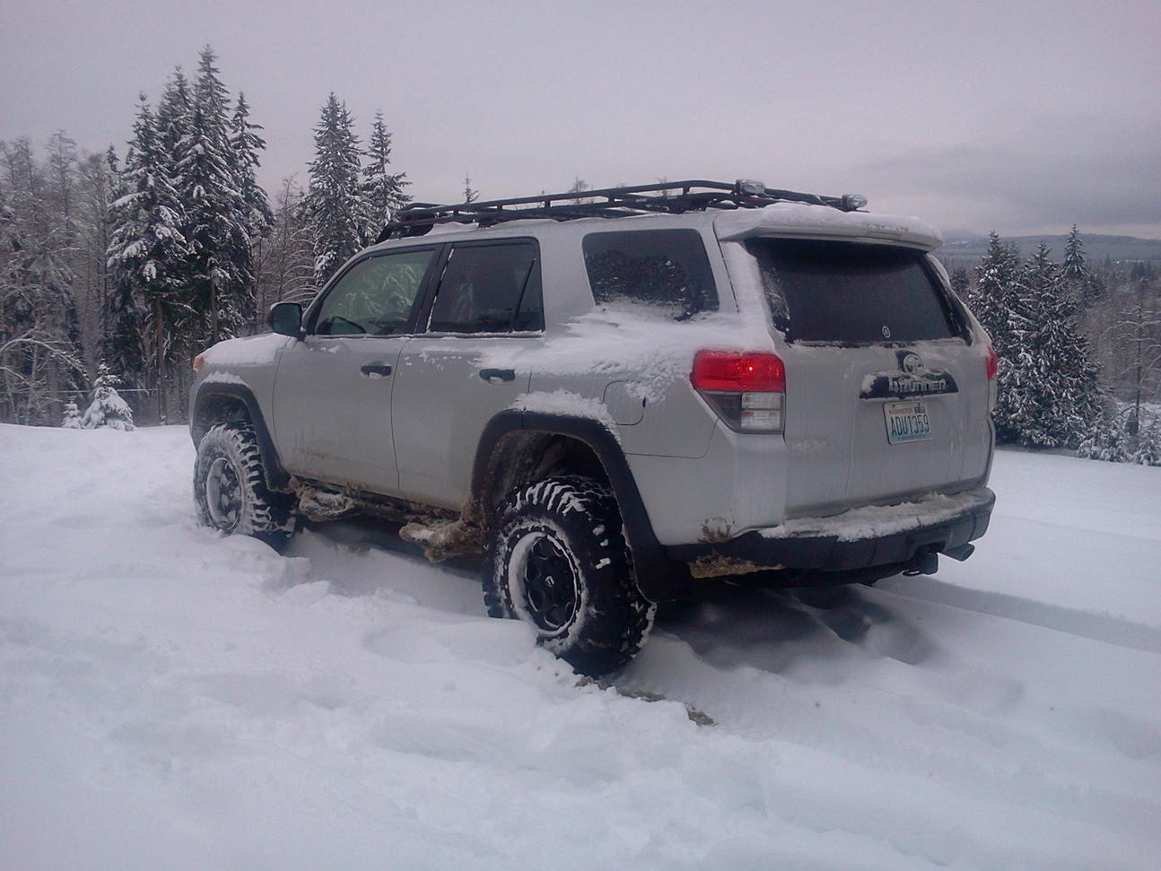

Would love to see pics of your truck.

Here's a side shot but not totally level. The front does actually sit just a tad shorter. I will work on getting a picture tomorrow at work (if I remember).
