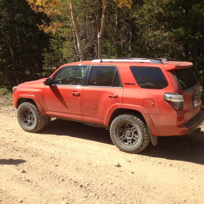

I have about 2700 miles on mine and love the look. But I am tired of the weight and how twitchy/vague the steering feel on the highway. Curious how much better the 265 in c load range feel.

I'm in Littleton and I have the c load 265 on my TE and they feel great on the highway. Let me know if you want to dive mine to feel the difference.

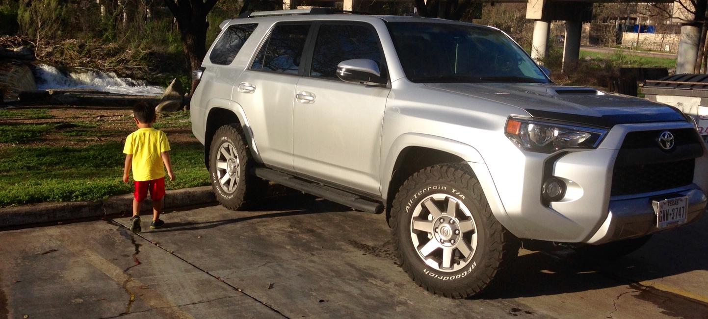

A few weeks on mine
I had my tires on for a few weeks now. The ride is great I believe the performance is great but the mileage is not as great as I would like it to be but I consider that a trade off for the great looks. I run my tires at 44 psi and my mileage is roughly 17 mpg. my truck is completely stock and I have experienced absolutely no Rubbing with these tires.

@ socalrunner - Have you done any offroading on the new 275's? I see a lot of people with no rubbing issues, but nothing is said in terms of rubbing issues when off roading.

The truck looks rad though! Looks like youve done some wheeling and the suspension looks stock, any rubbing when the suspension is compressed? Also, did you notice much difference in performance, acceleration, and MPG? The engine isnt exactly a powerhouse. I had an 01 with 285's and that thing was a SLUG.

I have done some off roading and the tires performed very well and with NO rubbing. Full cranks and articulation, didn't see, hear, or feel a thing.
