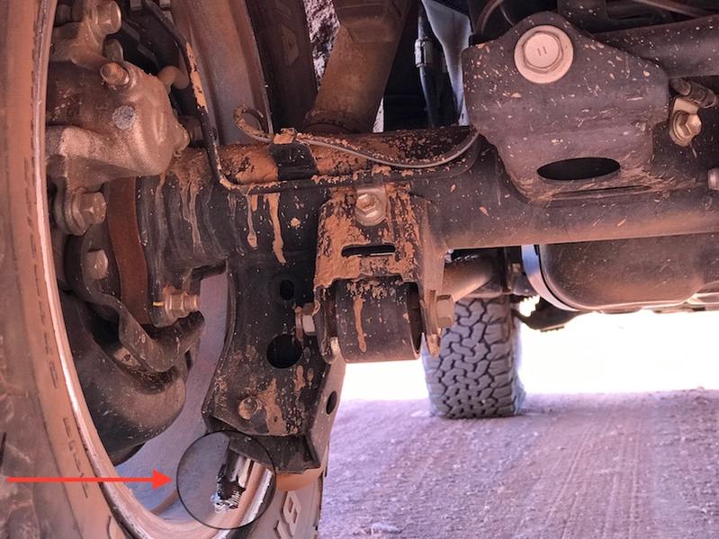

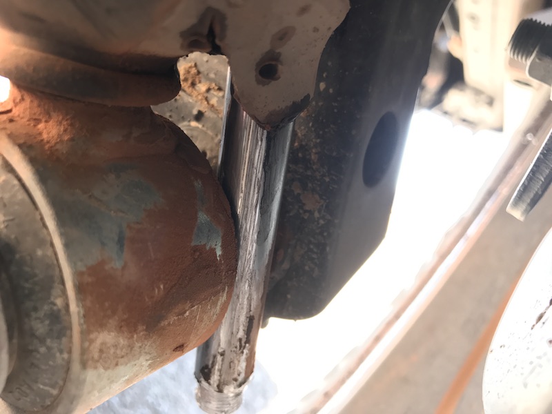

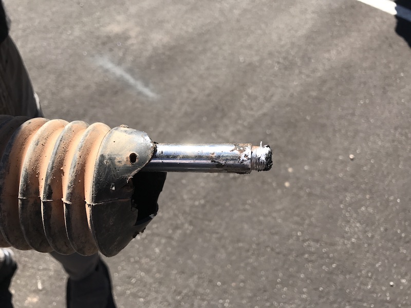

I'm in the middle of an amazing road trip / camping / overland trip in the Southwest and had a Bilstein in the rear break*. Specifically it seems like shaft came loose and then ground itself down once it was out. Being in the middle of nowhere I've been able to get a local welder weld them back (everything was straight...just some grinding to clean things up). I'm working with the vendor now to figure out how we can resolve this issue. Has anyone seen this?
First the good pic and then the carnage.

Interesting... It looks like maybe the shock ended up acting as a limit strap too much? It was mentioned in the other thread as well.
I've seen the exact same failure on a 3rd gen. The 5100s are just not that beefy in that spot. It won't see much pulling force there in road use. It's only going to happen fully articulated.... which most people don't do very often.
But is that because the shocks themselves are maybe too short or not valved well to dampen that sudden droop or because they're just that weak? The factory units are a bit "lesser" than 5100's and the 5100's should be better valved and slightly longer. But it seems like this failure is from the shock maxing out at full droop too regularly and too violently, which shouldn't be the case.
Like I said above I haven't seen this failure of the rear shocks in a factory unit being used (even with say a spacer lift) but I have seen it with aftermarket shocks that should be stronger than factory.
I saw this exact thing on my buddies 2007 TRD (W/ the Bilstein) Taco. Driver side rear sheared in the exact same way. It was actually much cleaner - and looked to me like some type of over-extension. They have a lifetime warranty against defects and this could easily be one. Assuming you were not abusing the vehicle, a replacement should be warranted. If the vendor will not help, hit up Bilstein.

i've seen this exact failure in many cars with many different shocks.
At times it was an overextension, but - most of the time - it was due to an incorrect install (but it was in slammed vehicles)

Since I'm in the middle of my trip and loving every second I'll keep this brief. As previously stated you buy these parts to reach a certain end goal. And that's certainly how they're marketed. Having said this nothing is impervious and certainly abuse can destroy anything. In my case you can argue both ways depending on your optics. But I will say car has 110lbs worth of sliders, maybe 120lbs of cargo evenly placed behind the front row. No passengers, bumpers, roof rack...etc. the roads traveled are back country roads, mostly graded but with the typical surprises. Also had one or two technical and somewhat difficult roads that required very slow speeds and constant spotting.
The failure here I think could be prevented if that joint was welded instead of screwed. Since welding I've put about 70 miles on it. Maybe 45 on highway and 25 graded dirt. No problems yet and frankly I don't expect any. I have a bunch more driving to do so we'll see.
