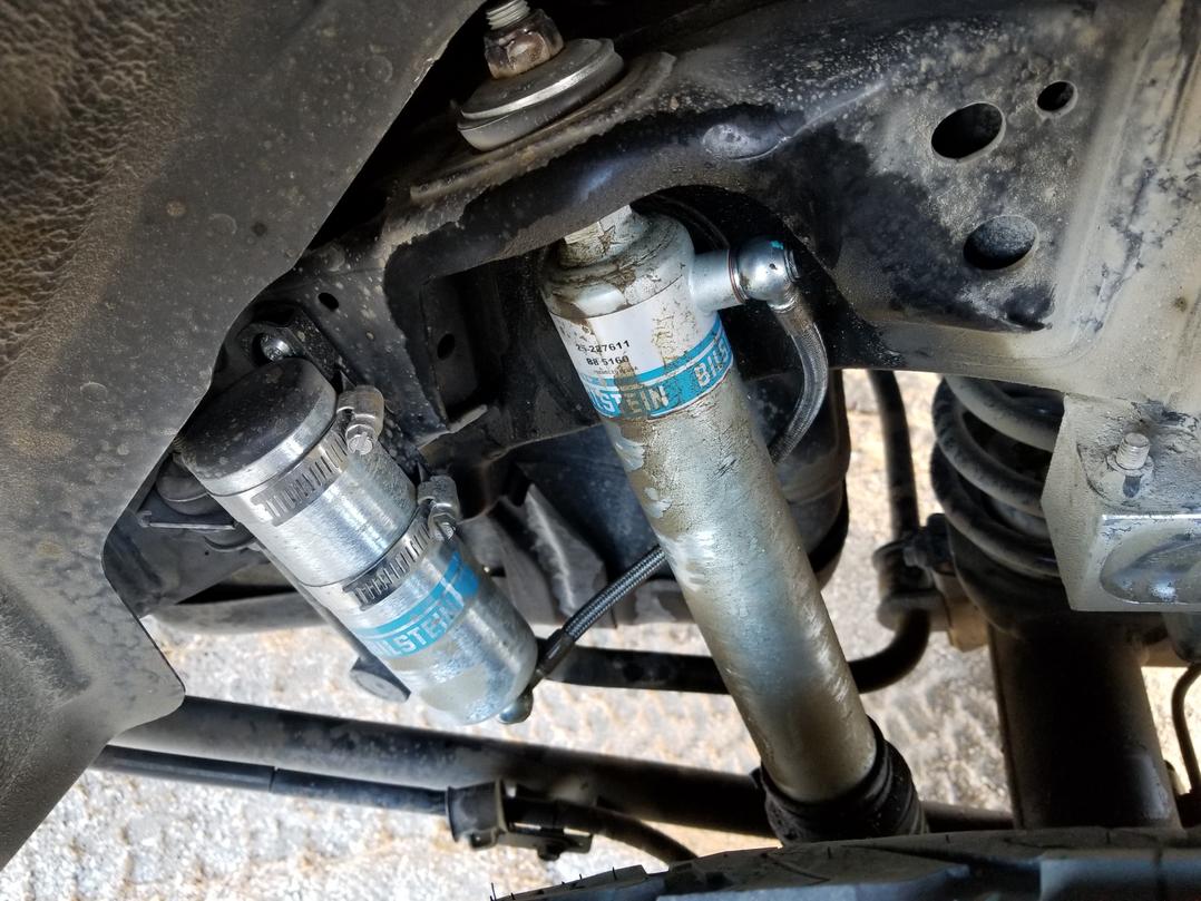

I have extended bump stops on mine & the driver rear just started leaking like crazy this past weekend on a mild trail this past weekend in Joshua Tree. I was extremely suprised for 1, I just installed these things 2 weeks ago, & 2, the trail I was on was extremely mild as noted earlier. I have the 2" Toytec Super Flex coils, bump stop drop, & 5160's (which I gather are a little longer & offer a tad more flex over 5100's). Currently in talk w/ Wheelers regarding a replacement pronto.. fingers crossed

I had this exact thing happen Saturday. Ground the sh*t out of the inside of my rim. It seems like the shaft came unscrewed from the mount a bit then wiggled until it stripped the mount.

I had one of the rear 5100's come apart like the OP, bought them from Wheeler's , Dan was great and replaced it for free, he said he would have just welded it back together but honored my request :thumb3:
That's pretty rad of them. I have to wait for the distributer to OK the 5160 being sent back, then get a return slip, then send in my broken shock, then have them inspect it, then see if I can get a refund, then once I get a refund I'll have to re-order another one. Kind of a PITA but it's what you get when you dont order from a shop that'll warranty it on the spot. At least I got a spare to keep me truckin until then... womp, womp...

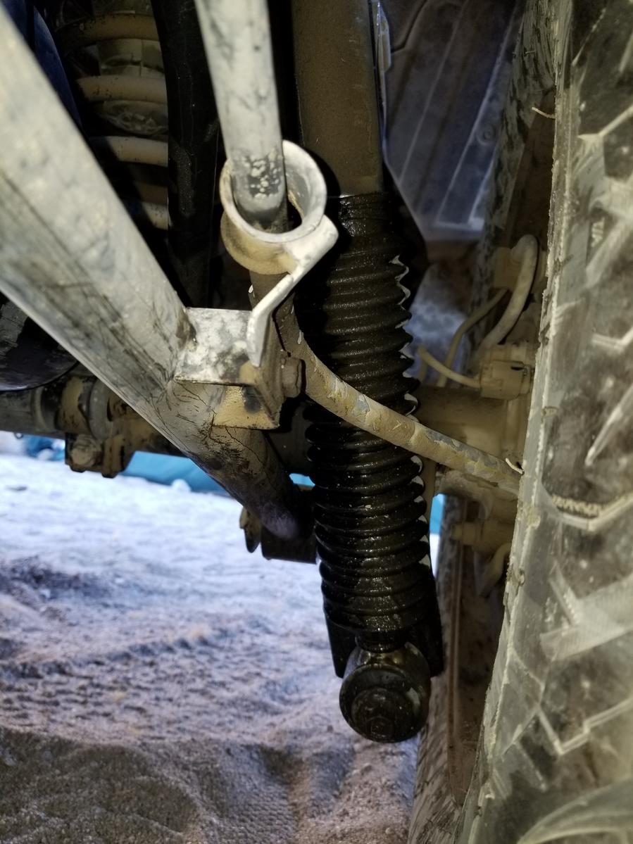

I don't get under my truck as much as I should. Today when swapping my rear springs I found that both shock boots on my 5100's had come off of the shock body and are torn. I zip-tied them both back on but there are giant holes in both of them. Wondering if it's worth it to order new boots and replace them. Anyone else had these fail or run without them? I've been pretty happy with the 5100's, had them on my 3rd gen before.
