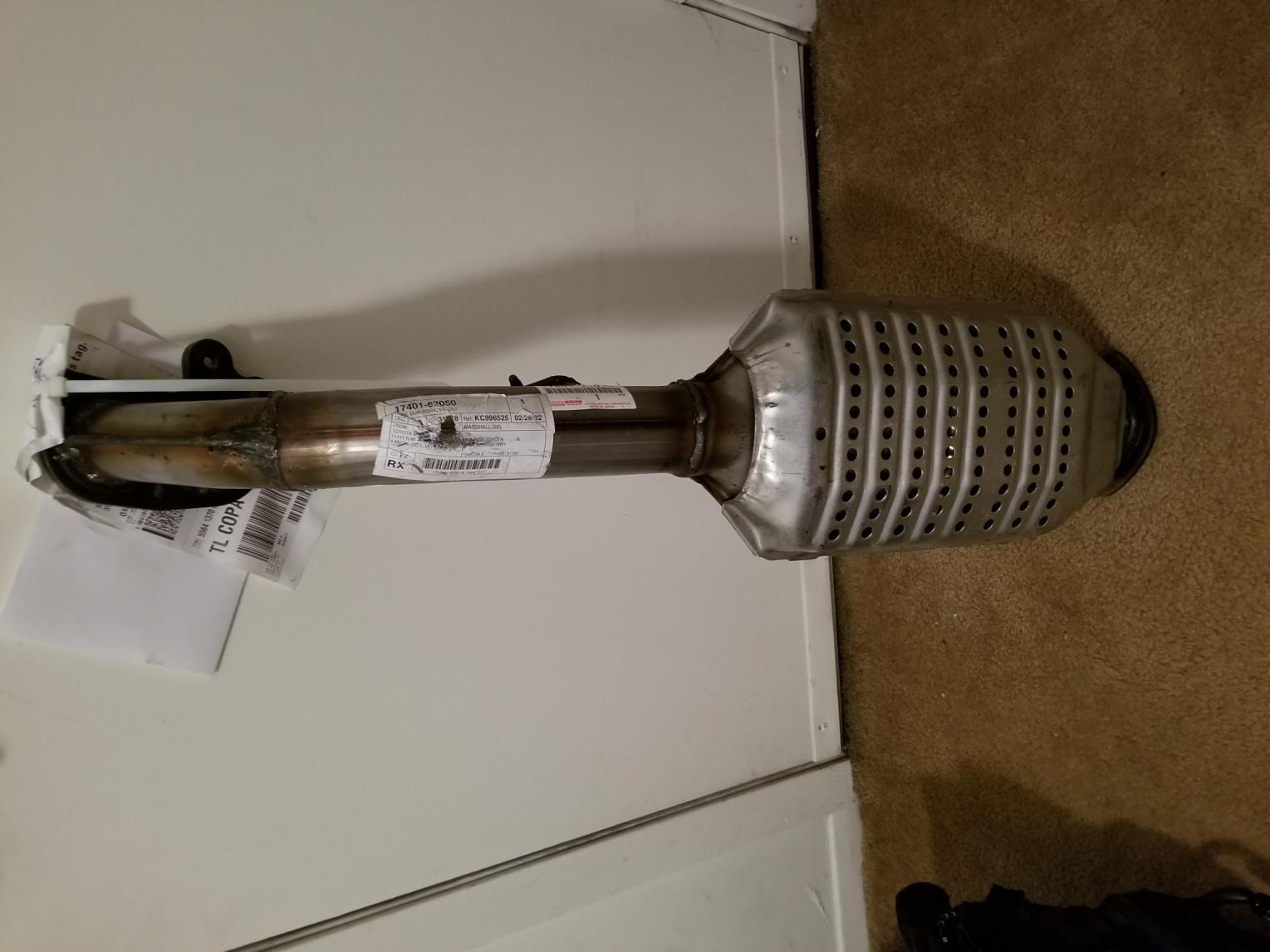

i think i paid $1900
The picture above is known as federal emissions from 1996 till 2000.
Everything went to California emmisions in 2001 and 2002.
The 1996 to 2000 with 2 cats is known as California emmisions...;)
