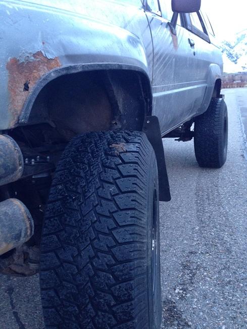

Shitty pics, but here's before and after OME on my '85. I think those are 30s on there.
IMAG0656_zps233df741.jpg~original
IMAG0660_zps020cc1f7.jpg~original
The heavy duty is just a medium duty spring with an add-a-leaf, so order the medium duty and then if you need to you can order the add-a-leaf later. The ball joint spacer will come close to leveling with the OME rears, but I wouldn't trust that EBay crap and you don't need the diff drop anyway. Order from 4Crawler or SDORI would be my suggestion.

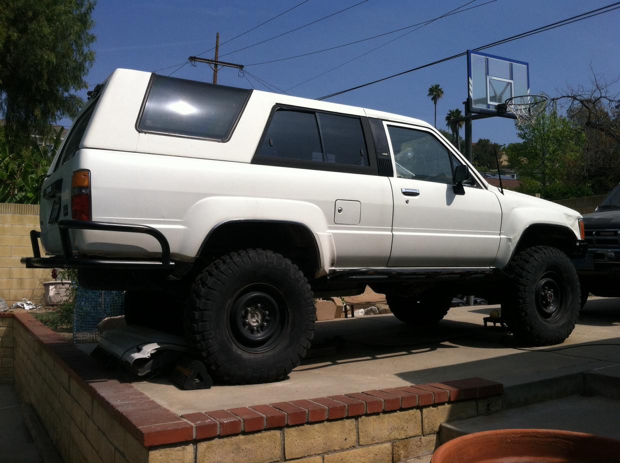

This is OME rear with Marlin Crawler 1.5" BJ spacers on the front. BJ spacers are your best bet for lift your stock IFS. Diff drops are a waste of time imo

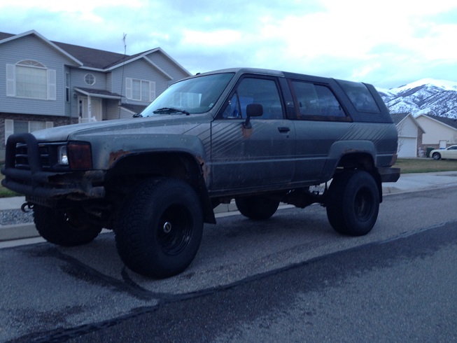

Here's mine with OME 2" mediums and 33/10.5s. Lifted it 5" initially and seems to be settling.
