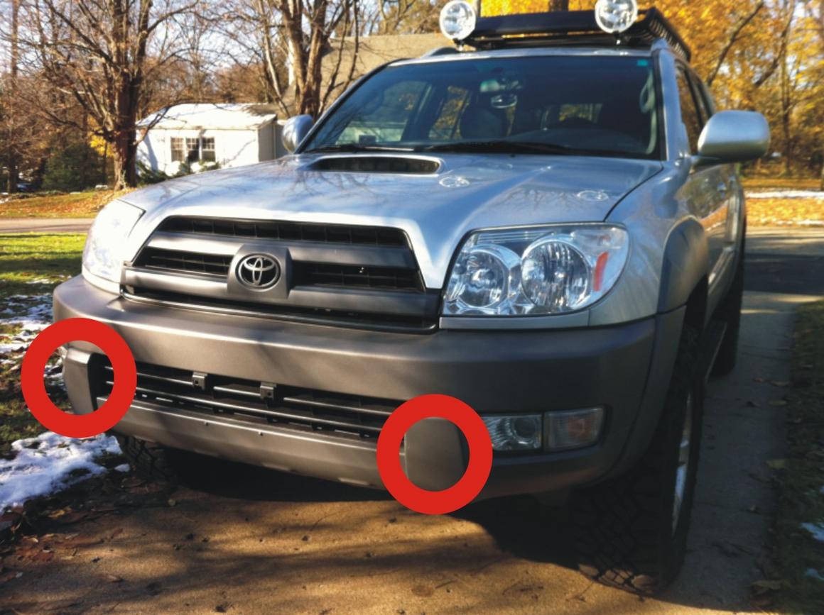

I was thinking of welding some D-rings to the bumper structure and then cut through the bumper to push those through. then hang some recovery shackles.
I'll have to draw up some pictures and post later today. I am not sure if my explanation makes any sense.
Here is a picture of the location I was thinking of having the d-rings with shackles. I am thinking this is the poor man's solution to creating recovery points up front without shelling out all the cash for an expensive aftermarket bumper.
Thoughts?
Thoughts?
You're better off with just sticking to the factory recovery points at the end of the frame. That steel bumper behind the cover is very thin metal and won't support the stress during recovery. Also the location you're looking at looks pretty close to the end, if not beyond the end of the steel bumper. You could also replace the factory steel bumper with a more robust piece of steel if you had the material source and fab skills.
Better yet, for $279 why not just get this CBI Front Receiver Hitch and put a recovery hitch on it.
