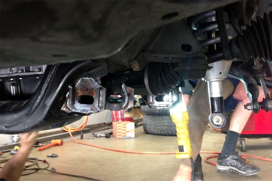

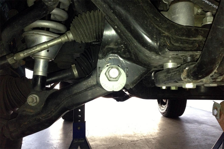

Basically to do this mod/fix requires taking most everything off your front suspension or getting it out of the way, removing the old tabs, cleaning everything up, welding new tabs, and putting everything back together. They took the wheels, brakes, disc rotor, lower control arm, camber/caster bolts and knuckle to connect to UCA off the truck or moved out of the way. Quite a bit of labor - if you do this mod you should also consider other parts like new rotors since there really no added labor...technically you could almost do most of the front suspension too!

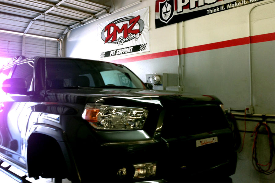

DMZ Fab
Old tabs

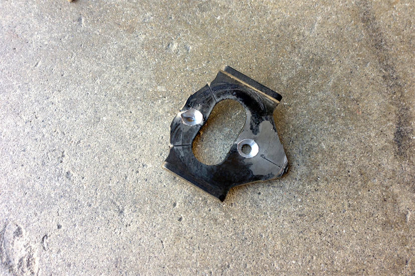

Old tab drilled off

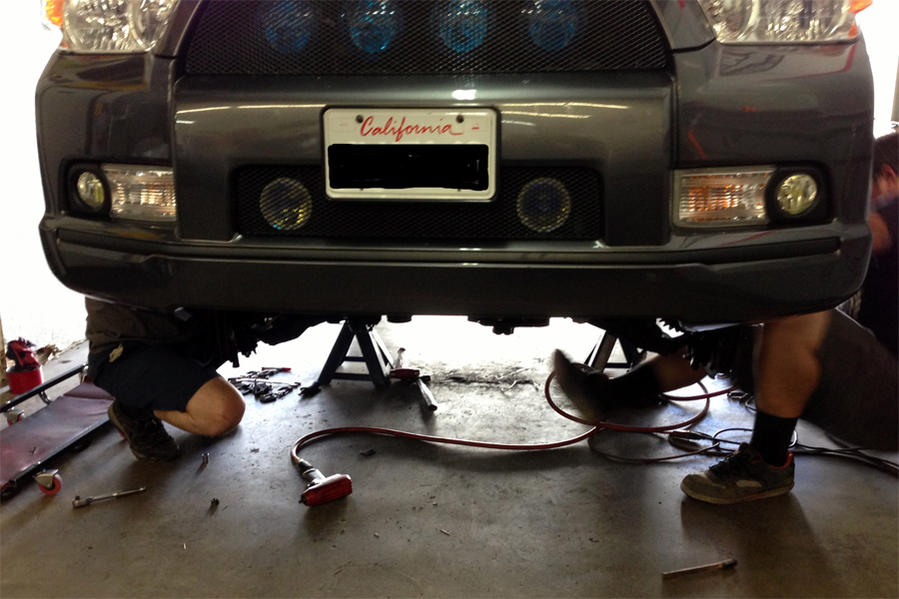

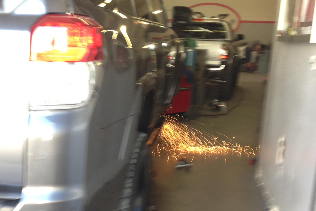

Grinding fireworks

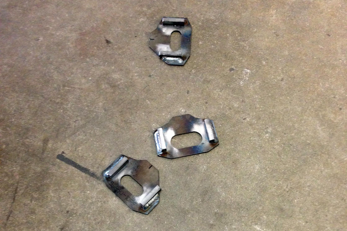

New tabs

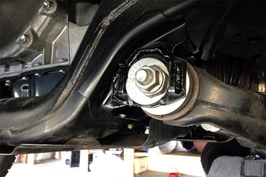

Finished welded tabs - there are four per LCA (front only)
Putting things back together - that is Tim the owner on one side getting busy - he also does most of the welding.
Finished tab - this isn't bending anytime soon!

The parts (tabs) are $85 - everything is in the install cost. So if you can weld and take apart suspension then it is a cheap upgrade. The original shop - well known btw - did refund my install costs and the alignment. This had to of happened from the alignment shop not fully tightening the camber bolt, it was coming loose, and one big dip and *BAM* - bent tabs. They argued that it wasn't them as it must have been something else - not much I can do. These guys third-partied my install out without me knowing and didn't QA/QC. They were recommended on this forum.
