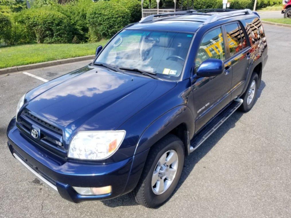

I just picked up an 03 LImited that the prevoius owner insisted I keep the family name of Blue Jello! lol.
Just scored a set of 245/75r17 Michelin LTX M/S2 for $350 on craigslist with 1800 miles on them from a 2019 Jeep Wrangler.
I HOPE THEY FIT lol.
UPDATED: A year later and they running real good still, no rub. Ready to go bigger now though : )
