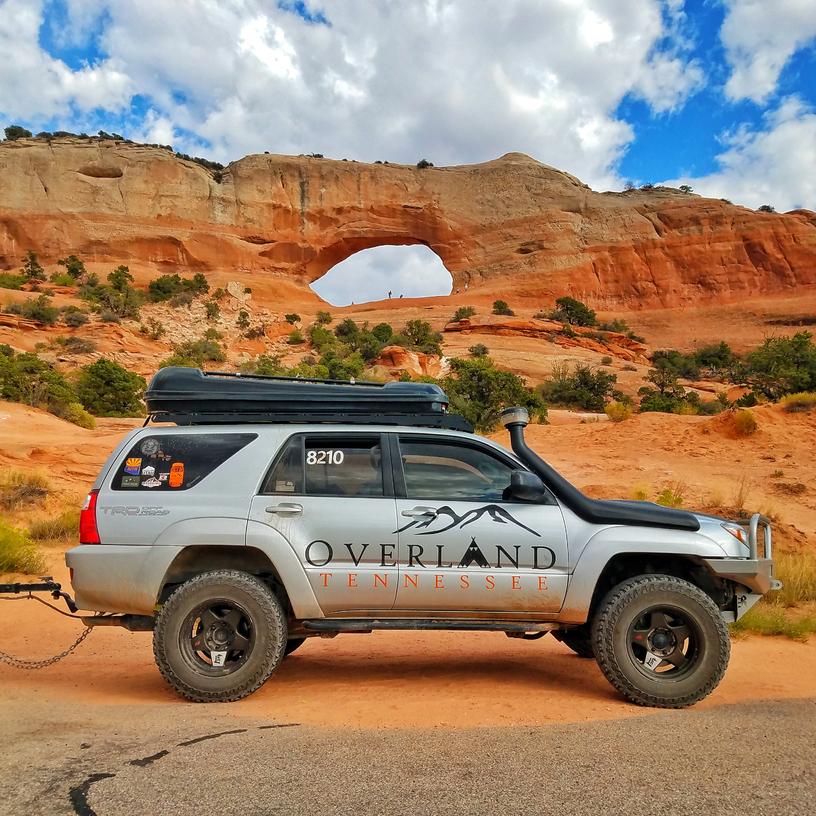

I used to run it, great stock upgrade size imo. You will need that spacer lift to make it work. You can check the pics out on my build link

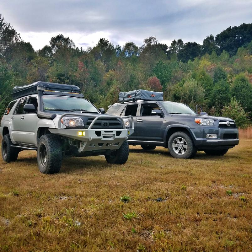

I ran that size for almost 2 years before bumping up to 255/80/17. Might rub the front bumper some and I had to push the bumper liner forward.

All I had at the time was 3/2 spacer lift.. stock everything else. I pushed the fender liner forward so it wouldnt rub offroading.. otherwise it was fine

I have over 45k miles on that tire size 255/75/17. Just bought my 2nd set of tires in that same size. I think it is perfect for what I use the 4Runner for, the only lift I have is the spring hat spacers.

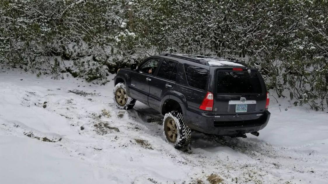

Here are my 255/75s in action. I love this size, no complaints at all. Highly recommend.
