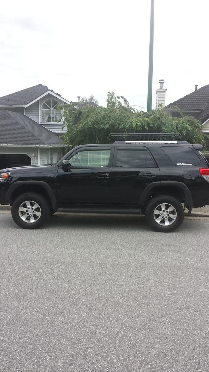

Anyone running 5100s @ 2.5" with Saw1.5" rear coils?
No matter how much I rotate the pic its always sideways . I will try taking some new pics tomorrow

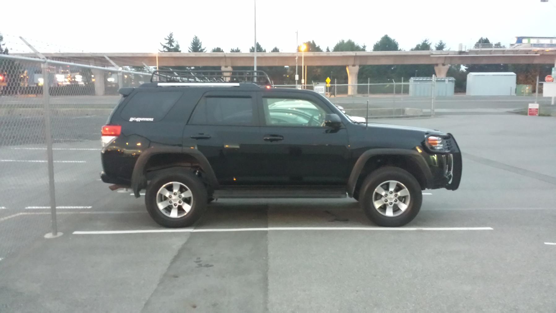

I just got them installed on Monday. Will do my alignment on weekend but inspite of that it still drives like how it should have driven stock in first place. I do have my old shocks in the trunk along with my spare tire when I took the pics , just in case if you think it makes a difference. I personally don't think few pounds matter. NSOR in north van said these icons springs will not sag, have to find out in time .

This is better....!!
You weren't kidding when you said you're not a computer guy, lol.
If you're using Windows OS, just open up the picture on MS Paint and rotate to the orientation you want and save it, easy peasy :)

thanks for that!! one second i think that having the fronts at 2.5 with SAWs in the rear will give me level and once they settle ill potentially get a bit of negative rake....the next i think 1.75 in the front with SAWs ill have too much rake.....sheesh. decisions decisions....
even if you get 1.75" out of SAWs (if they settle) you still are NOT going to have negative rake. The rear is already 2" higher stock. Look at CENTCOMPETES rig. he is set to 1.75" in the front and is running factory springs out back... it is dead level by the tape.

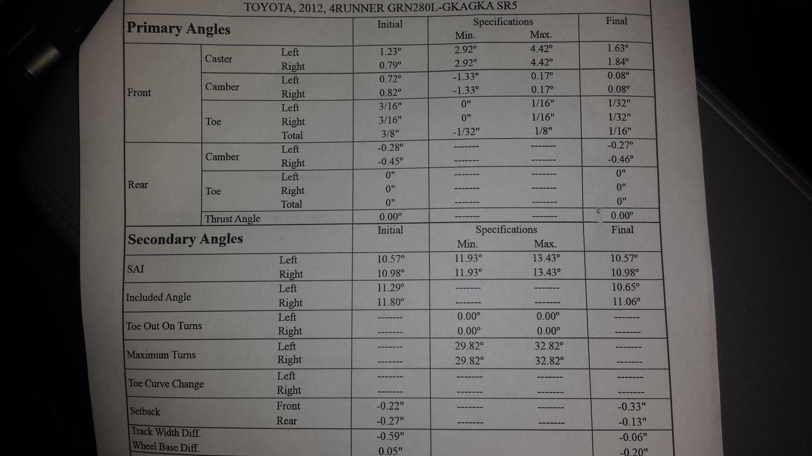

After alignment on stock UCA these are my results
