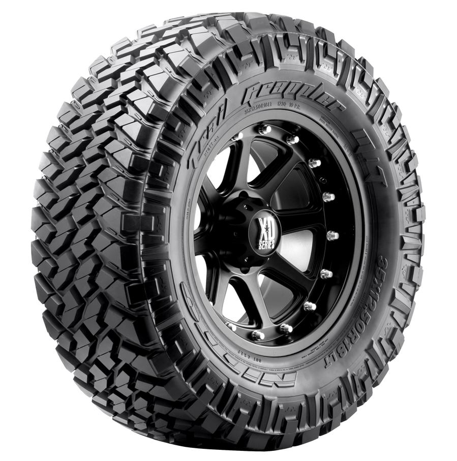

Anyone running Nitto Trail Grapplers 285/75R17 ?
Lebengeek
Hi Forum,
I've been researching tires that have a higher sidewall to tread width ratio. Im looking at getting these for my future OME lift. Anyone here running Nitto's?

I have the 295/70/17 trail grapplers, my only suggestion is to get the Body mount chop ASAP, or you'll hate your life.
Thanks for the heads up :)
Was the body mount chop needed due the the added width or increase in wheel height ? compared to your tires 33.54" x 11.97" the 285/75/17 are 34.09" x 11.57"

Those are 34" diameter tires so you'll need to do some things to get them to work or you'll have rubbing problems.You'll most likely need bump stop extensions in the rear also or they will rub on the rear fender wells(ask me how I know,lol)to go along with a BMC as adio3x said ,if you plan on offroading it. Also with 34's the gearing will be really off and lose power and will have a hard time holding 5th gear on the highway as it will keep wanting to downshift.
When I went to Ouray this summer the 34's rubbed real bad on the rear fender lips when stuffed and cut up the outside lugs and about ruined my tires. I since swapped the tires so the damaged lugs were on the inside and put on Metaltech's 2 inch rear bump stop extensions a couple of months back.
When I tested them ,they worked great and no more rubbing with barely enough clearance.My wheels are only 8" wide,although a 4.1" backspace pushes them outward a little more then most 8" wide wheels. People running 9" wide might still have a problem with a rubbing when stuffed.

Thanks for the info Harper7. Great info to consider before committing to tires. I do plan on taking the TE off road. The gearing is in the works too of course.
