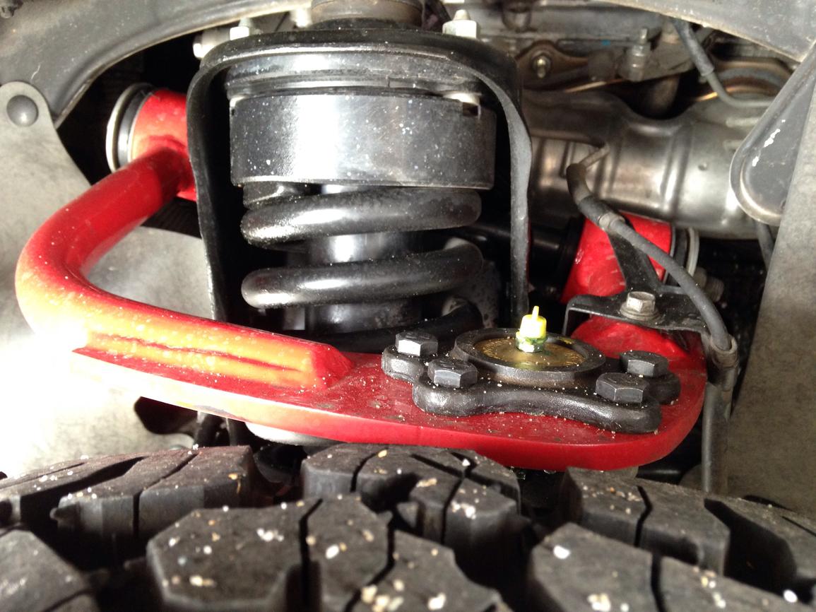

What's with that scraggly looking ground up spacer on the end of the ball joint ?you could see it even rusted in the picture , I don't understand . otherwise they look pretty good I would've mounted the ball joint under the arm but whatever.
That's not the right upper ball joint for a 5th, 4th or FJ. The Tacoma has a smaller ball joint. It looks like a Chevy or Ford full size joint that happens to be the same tapper, but too long, hence the spacer.
Also the Tacoma and 4Runner/FJ need different corrections, that is why SPC and Camburg make different versions for the different vehicles.
A Tacoma is no means a 4Runner. They are very different vehicles made on different continents from completely different suppliers.
My advise would be to machine a slug for the correct 5th gen 4Runner MOOG ball joint to be pressed into.
Yea this is a little worrisome.
Looks to be an older 2WD Chevy truck balljoint. Good to know you can get something other than the junk Moog ones.
That's one of the things I brought up to him yesterday the spacer is for different amounts of camber for different amounts of lift up to 4 inches..right now I could actually take mine off as in only at 2.5 lift but in going up soon. He is going to either look into aluminum or powder coating the steel.
Sounds a bit jumbled together. I think I'll stick with a ball joint made for my truck...
