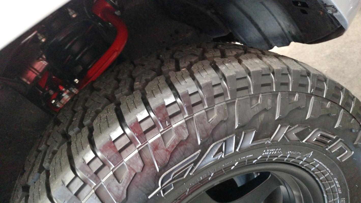

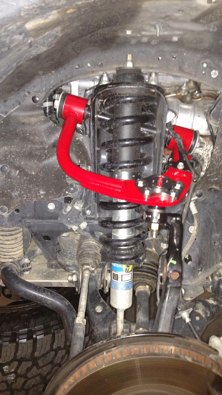

I've had mine for a few months now and I couldn't be happier. The red is bold and I love it. Caster is +4 almost at 5 with everything else in spec helps me to fit my 285s that measure 32.7 without any rubbing on the body mount (I trimmed and completed the fender line mod). Drives great and handles superbly on the trail, I'm a very satisfied customer.
