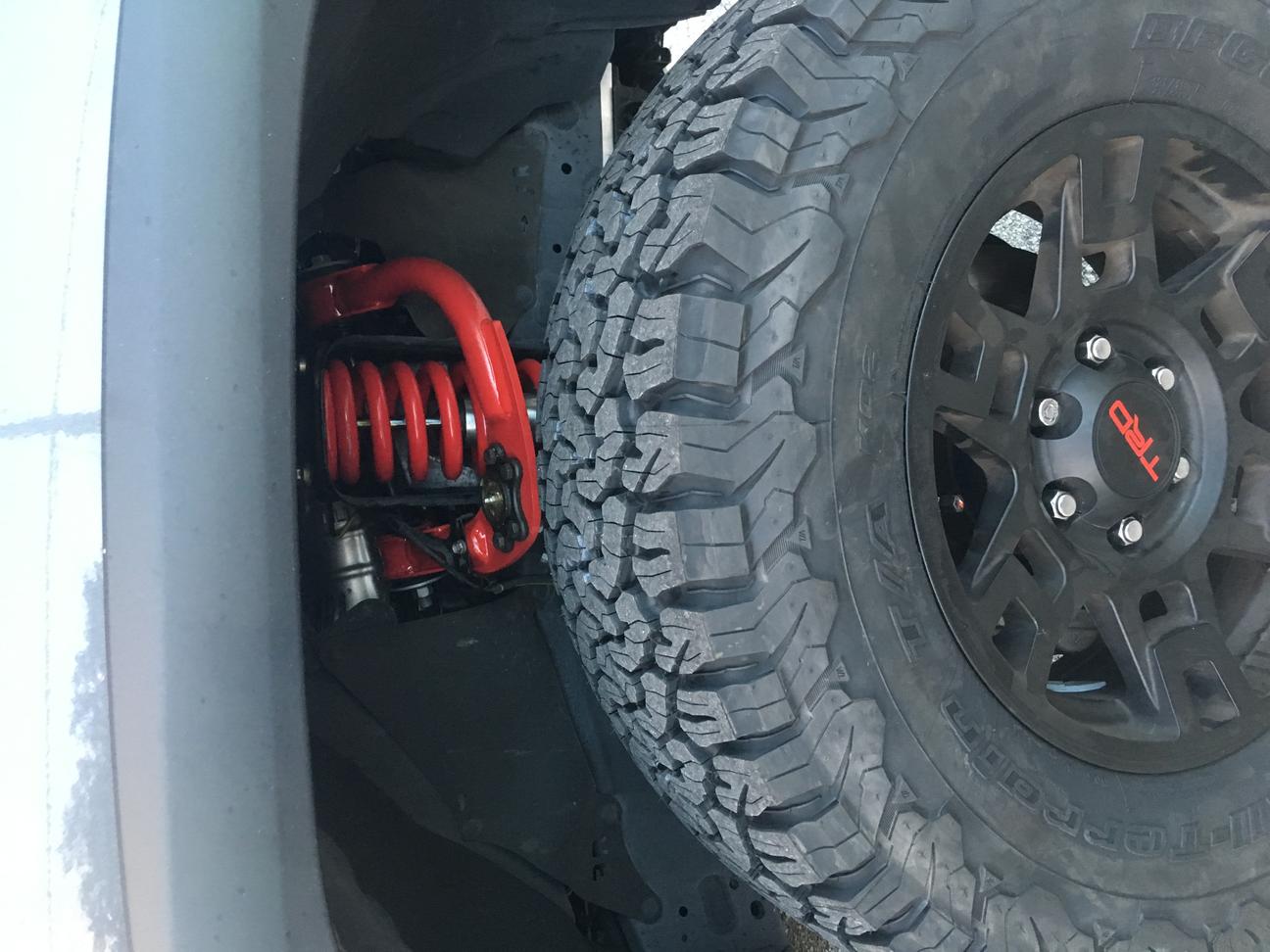

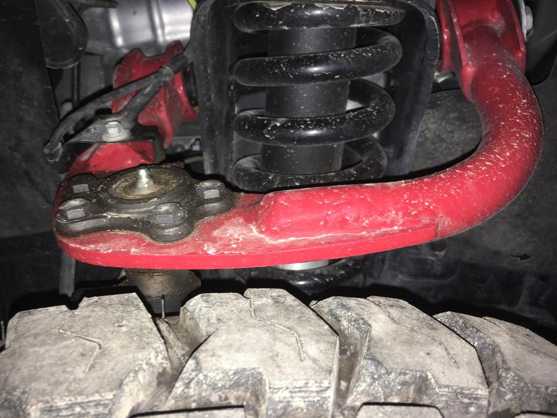

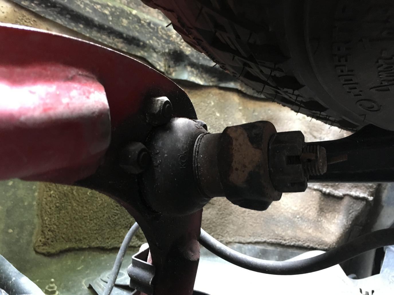

I'm still quite happy with the HD JBA UCA's. It still drives great with the Cooper ST/Maxx's. Alignment is still spot on. I like that shooting grease in them is easy. I would highly recommend these. I went with th HD version which may have been overkill, but I like the added strength factor.

I too like the added 11ga gussets and larger tubing of the HD version, although i believe the standards would probably work just fine.
reading their site their wall thickness difference is 1/32" (3/16" vs 5/32") and larger in diameter by 5/16" (1-5/16" vs 1")
Any chance i could talk you into taking a pic of the underside of the BJ?
I'm reading on tacomaworld that there is a metal spacer of some sort that some people paint to keep from rusting? (think i see the spacer in your pic)
Is there a rubber boot like other BJs?
Also looking to see how grease is reapplied.
I have about 7k miles on mine and have had zero issues with them, and I am not mall crawling. Replaced my spacers with a OME 3" and all is good so far.

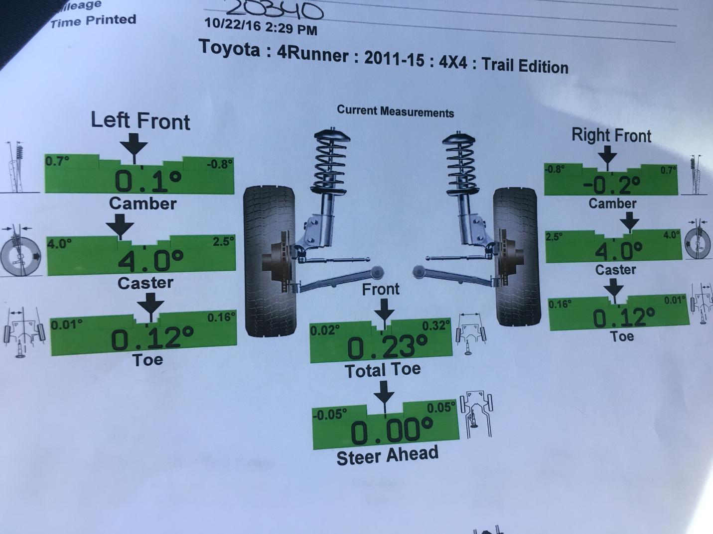

[MENTION=143901]Lightenup_bro[/MENTION] I haven't had them on for very long but as for alignment I got 4.0 caster with the other numbers in line. More stable and easier driving at hwy speeds than the stock UCA at 1.75" lift. Happy customer so far

Thanks I was wondering if anyone was able to get the 4 sweet spot and keep everything else in line. I really like these A Arms. Is there a specific reason you went with the HDs (I believe that's what you have based on the picture)?
not really, other than i thought larger diameter tubing and gusseting looked cool. I'm sure the standard option would have worked just as well.
