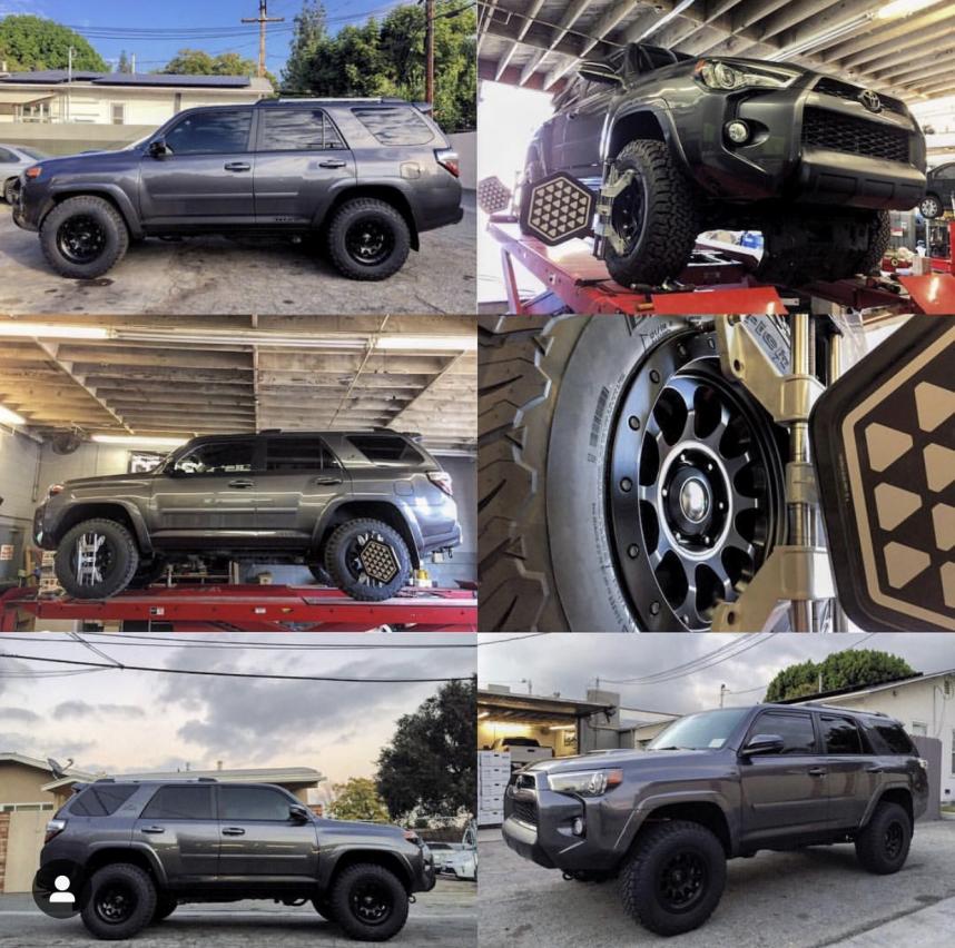

Running JBA’s with 5100/Wheelers T1-T13 lift with zero issues and straight forward installation and alignment. I will post up my alignment sheet from RPM Garage in So Cal shortly. These guys have done thousands of Toyota lifts and said the JBAs were no different than any other UCA to install.

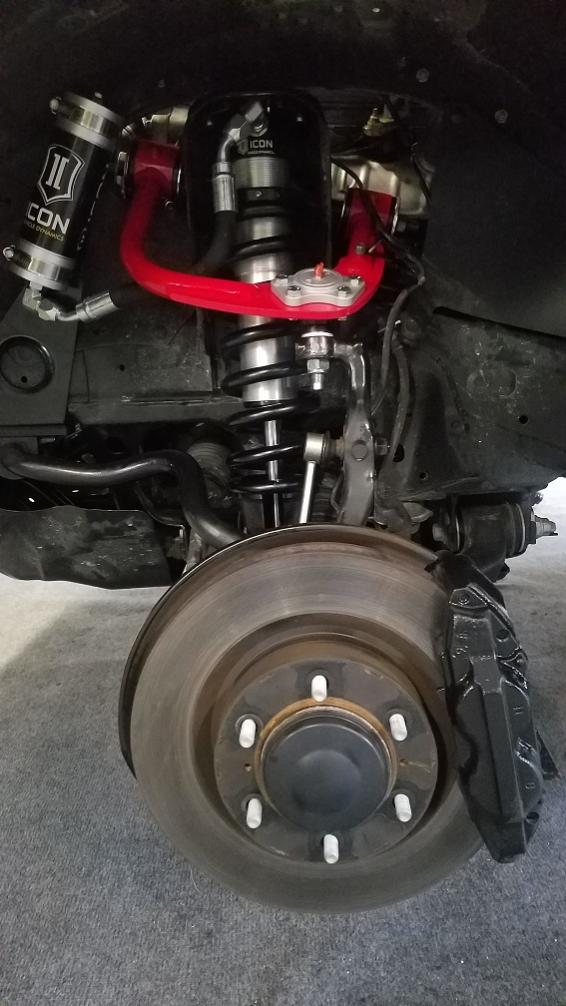

I just installed my JBAs and I love them. Seem EXTREMELY well made and the sealed (and easily replaceable) ball joint is fantastic. Plenty of clearance and angle.
I would add a pic but all my pics are too big for the upload and the stupid uploader doesnt auto resize.

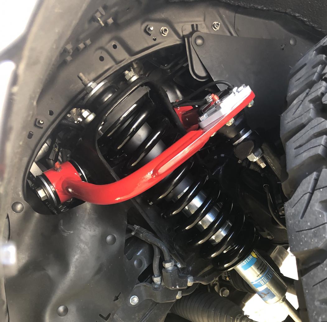

I just installed a set of these the other day and they are extremely well built and went in a lot easier than I was anticipating which was a pleasant surprise. I'm taking it in for an alignment and my new SCS wheels on Mon looking forward to it.
Just installed mine and LOVE them. Easy install (yes the washers are tight but only a few mins of cursing) and they look and perform beautifully. Plenty of clearance between my Icon at full droop.

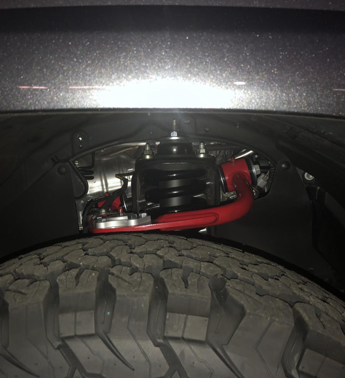

Just installed mine over the weekend and love them. Got new shoes and an alignment and the caster was 3.5 on both.
The washer wasn't too bad used a thin layer of grease on the bushing faces like the instructions asked for and just all just pushed it in from the back as it got started and went right in.
