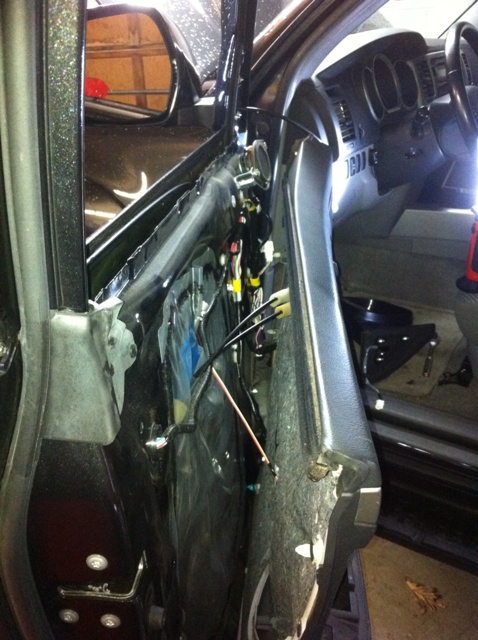

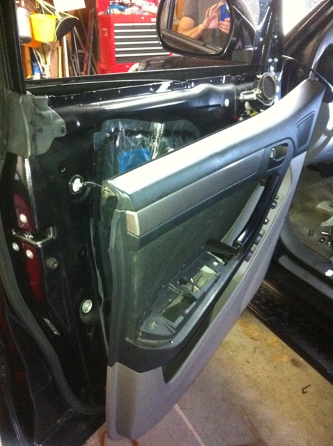

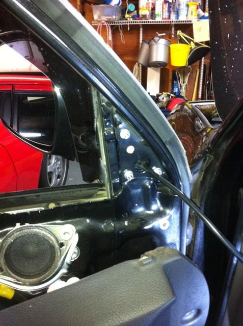

Hey guys, I installed the new heated mirror today on my 2007 SR5. All went well, I'm ready for the the snow and ice now !
I bought an aftermarket unit for about $65 (not the signal mirror), looks the same as OEM and mounted up fine, electrical connector was a match. It came with a new foam gasket as well. The OEM and also the new connector were not "clicking" into the factory wiring plug, so I used some electrical tape to make sure it would not vibrate out.
The instructions at the link provided by R.A. above for the Muth signal mirrors was helpful for removal of the door panel, the factory manual does not have any more details actually.
One you remove the 2 door panel screws and black push-pin, the inner door plugs are what is holding it on. I pried off the top of the door panel near the window scraper and then worked aroud the edge with two fingers on either side of each inner plug to losen them without tearing them out of the door panel. It was fairly easy.
Aftr that its an easy remove and reinstall for the mirror.
Next was testing, and I discovered that after pulling the negative battery cable. I had to initialize the side and back windows before the Rear Defrost would go on, which also turns on the side mirror heating elements.
It heated right up, was a rectangle shaped area of heated mirror (not quite the whole mirror area), but it will likely melt most of the snow/ice off once fully heated (not sure how the factory mirror element is placed in there?.
So, here are some pics too. Let me know if any questions.

Oh, and you can't miss which connector it is.
The wire coming out of the door/window area where the mirror mounts, just runs down about 4-6 more inches below what you see in the pic, and the connector is right there. Its not hidden or taped over or bundled with other stuff.
