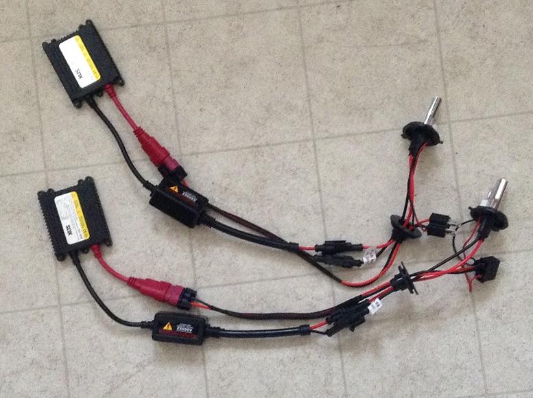

I bought these on amazon a week ago as I work 2nd shift and drive home on dark county roads every night and wanted something a little brighter. Don't know how many times Ive almost hit a deer. They get decent reviews, so I figured Id give them a try. They are supposed to be plug and play. The connections are very simple.
So I just pulled out my old headlight, hooked these up, plugged them in, and drum roll . . . . . . . . . . nothing. They literally did nothing. As in I turn the headlights to the on position, and nothing whatsoever happens. These are H4, hi/lo beam, 10000k. The connection is right (three prong) as you can see in the picture. So is there something Im missing here?? Anyone know why these are not wanting to work? Id like to make sure Im doing everything right before I send them back.

It sounds like you are doing everything right, it might just be that it is a cheap plug and play kit and is non functional out of the box.
You've probably heard this before, but I'm gonna say it again. Honestly you will see a bigger improvement with a good set of halogens rather than a plug and play HID kit. First off you don't have projectors so they're gonna be blinding to others, and at 10000k that's gonna be really hard on your eyes and not improve visibility at all. Maximum light output is about 4300k and this is the number that most OEM HID projector set ups are about because of this. I would personally get a good set of halogens, do a projector retrofit, or get some off road lights to run when you are out there this way you can turn them off and not blind others.
The fact that those are a true projector HID means they are crap, regardless of the reviews. HIDs are not meant to be used in a reflector housing.

Try reversing the HID side Connector. Just flip it around. Cheap ones sometimes need that done, I've run into it on DDM kits.

Edit; as a matter of fact, I just looked at my DDM ballasts in my Lexus and they're both reversed. I taped both of them since there's no little nub for the clasp thing to click into.
