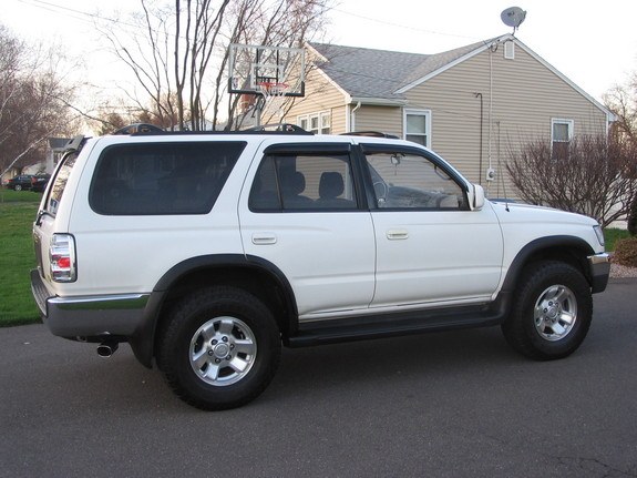

I've had mine on since 2012 and my trucks a 2011. No problems at all after the initial install. Like others have said leave the windows up for a few days and you may have to persuade them once in awhile but should not have a problem after that. I had the outside mount ones on my 3rd gen and worked for that truck but wanted the in channels for this truck. If you still have a problem, try a heat gun with the install and then if that doesn't work try replacing the tape + heat gun.
