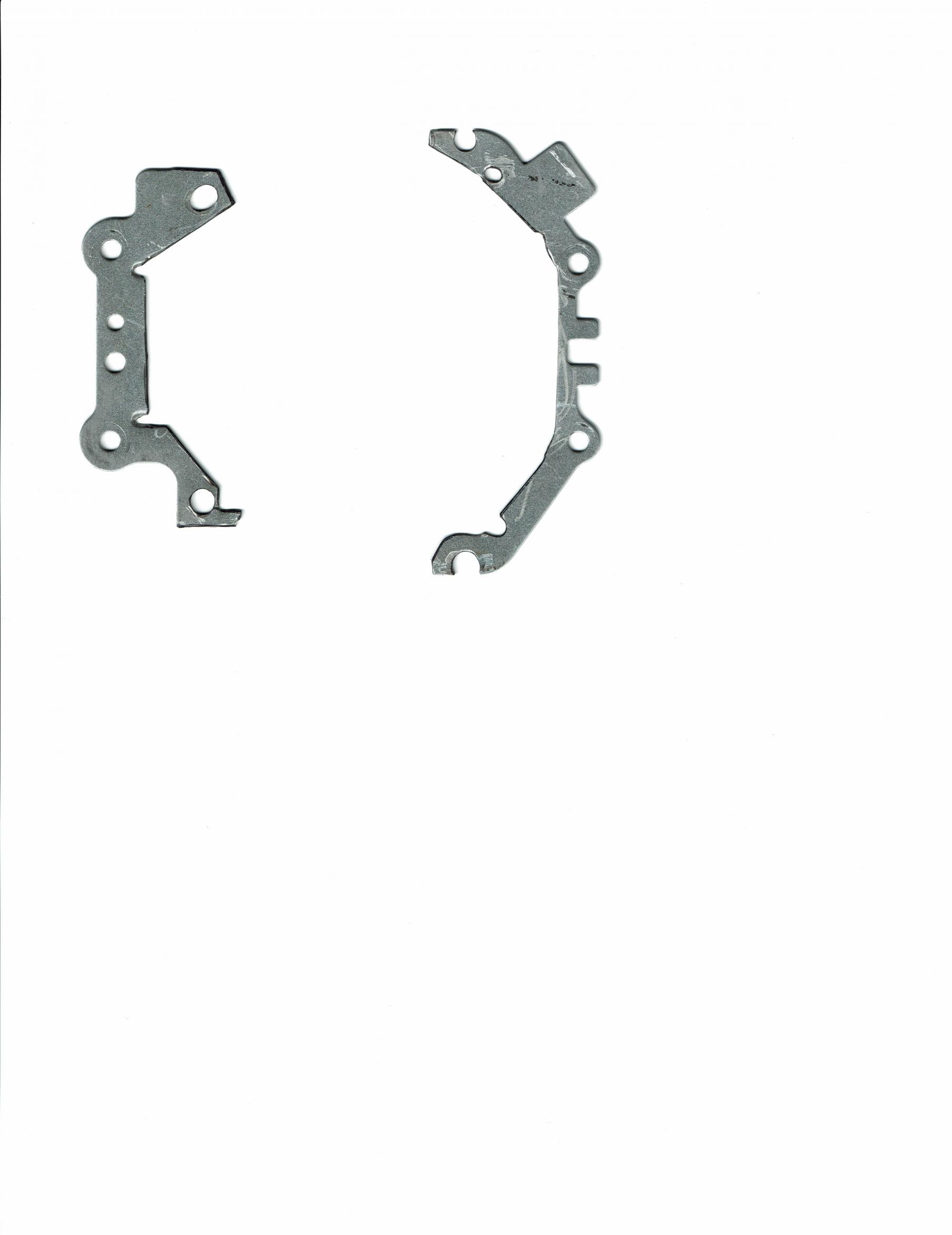

I made some copies of the retrofit brackets I made if someone might find use of them. Pretty? No. Does it do the job? Yes. Should I make my own or buy the $70 TRS brackets? You decide...
  • 4Runner Retrofit Bracket.pdf

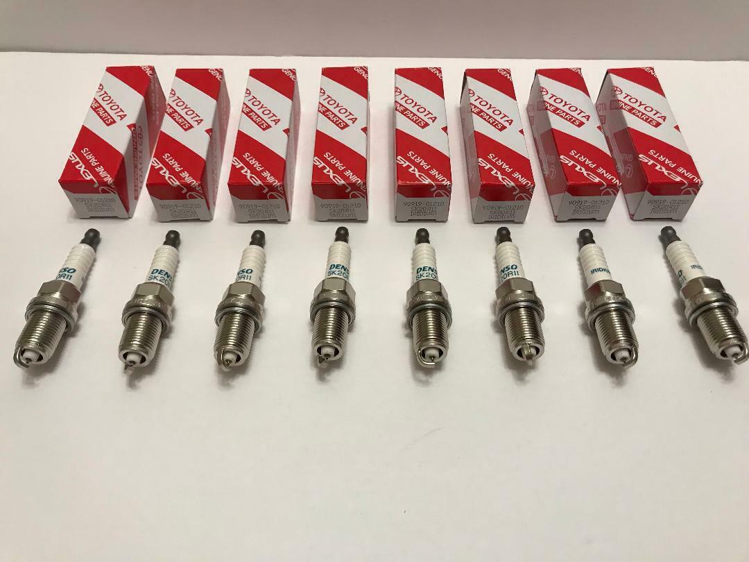

Ordered a set of 8 OEM Denso 90919-01210 (SK20R11) plugs off the 'bay. For $37 I'll taker the stab at them not being knockoffs! Figured it is a nice way to say merry Xmas to the runner...

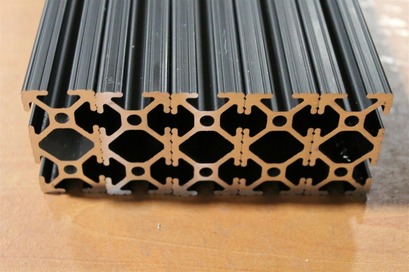

My 80/20 1020 series crossbars came in. Snagged 5 of them on the 'bay as well for much cheaper than Sherpa would sell me the cut-to-length crossbars... (sorry guys) :shrug:
I plan on cutting one to length and putting it up front to stiffen the section of the rack near the wind deflector and use two (or four) for a beefy RTT mounting design I have been cooking up!
As always, material is nice to have, and to play with.

Care to share a link?
Link to Ebay - 80/20 Inc Products
Every week or so they have been selling lots of 48" 1020 Black Series bars, which is the exact crossbar used on the racks, just 1" longer than needed. Right now they don't have any on there, but follow the search and all of the sudden, they will have a few sets again. Click on completed listings and you will see what I am talking about!
I scored an auction of 5 crossbars for $65 shipped! Cheapest I have seen was a set of 4 for ~$40...

Well, the SK20R11 plugs came in, but they be... "not lookin' right", as they say. I referenced the thread: https://www.toyota-4runner.org/4th-...spark-plugs-ex-denso-sk20r11.html#post3302737
to determine a few things about the plugs I ordered, then returned them and ordered a more expensive set of TT's from a more reputable seller (hopefully)... We'll see how those look!
DON'T BUY THESE (seller autopartconnection on ebay):
1. No iridium weld presence at the electrode tip or blue tinge
2. Incorrect laser printing compared to glazed OEM print
3. Machining defects present, including slag bridging the spark gap on one... See pics below!
8pc NEW Denso Iridium Power Spark Plugs Toyota Lexus 90919-01210 SK20R11 3297 | eBay
