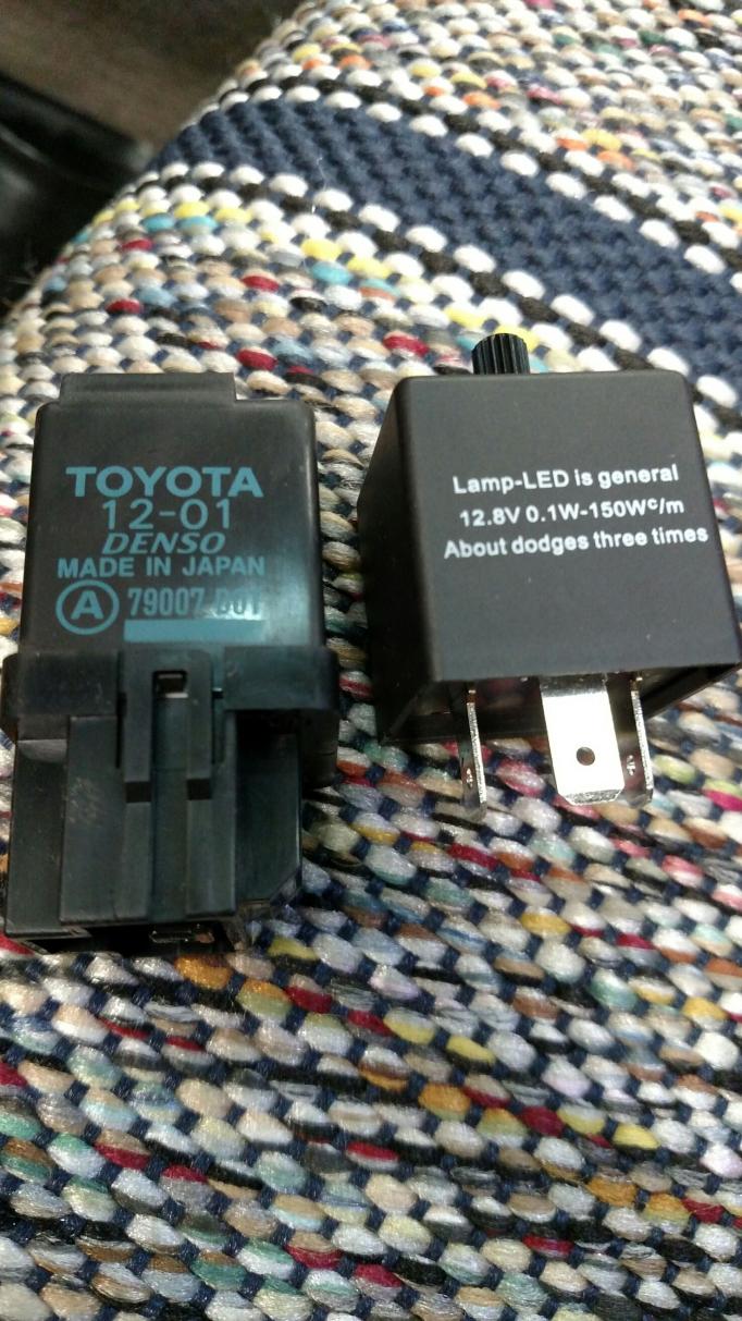

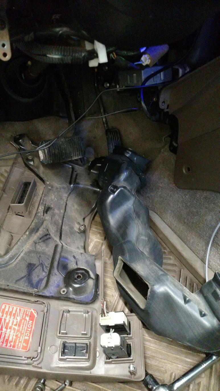

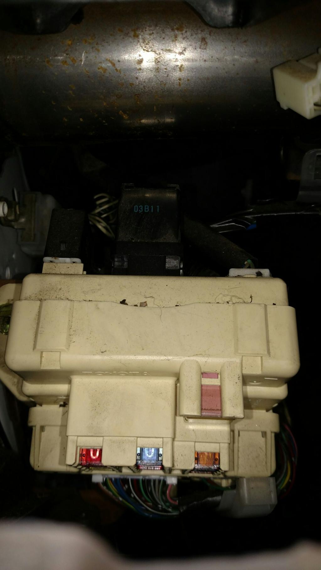

Not quite done yet- last step was to install a CF-13 adjustable flasher relay ($10 from Ebay) under the dash, behind the fuse panel. I simply removed the lower steering panel, pulled the air tube (one philips screw and loosening a bracket), and the flasher relay is the topmost relay behind the fuse panel, accessible and waiting to be pulled (see the O3B11 relay in the grimy fuse panel pic). With the new relay, I was then able to dial in my blinker speed by the adjustable knob on top- it worked flawlessly. I put it all back together after testing it a healthy amount of cycles...

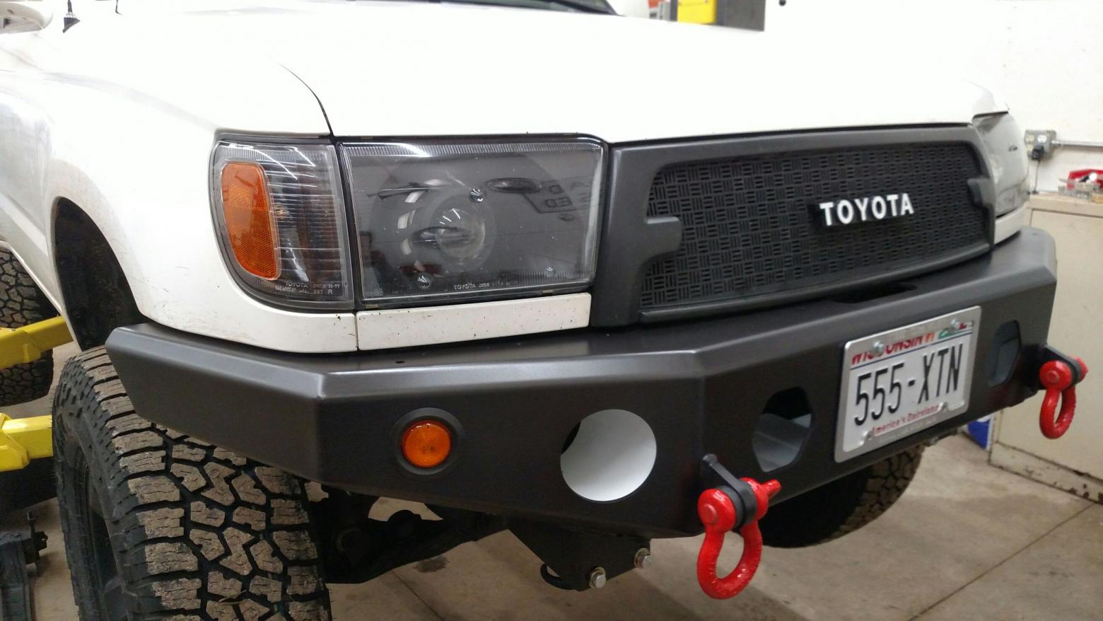

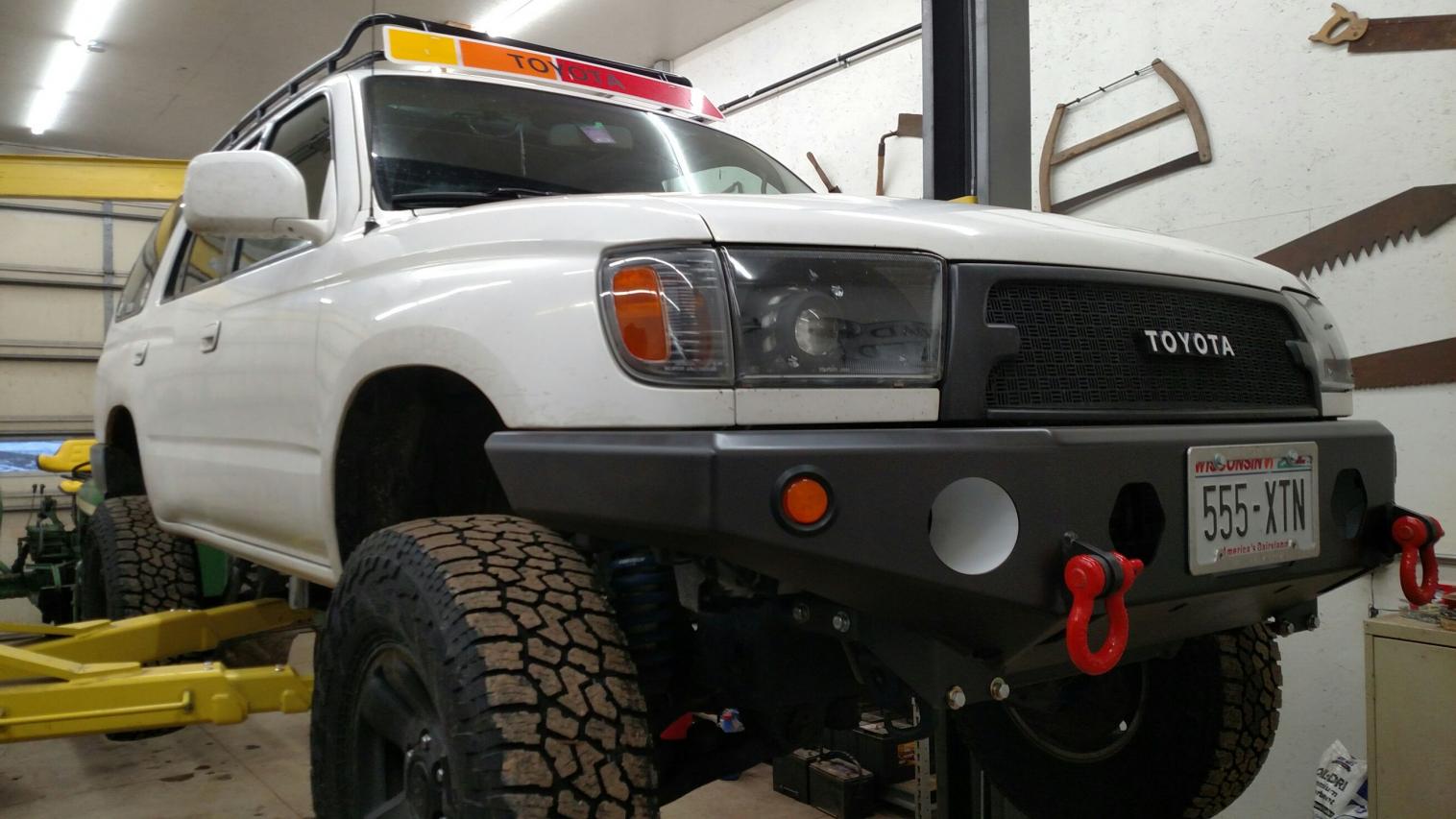

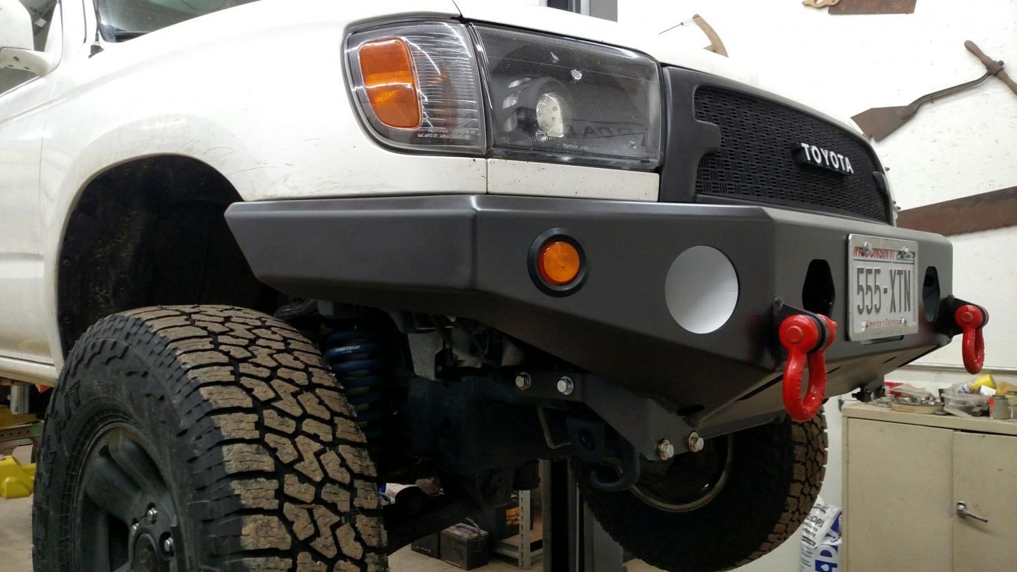

... And here it is with the licence plate, shackles with foam isolators, and LED turn signals installed!!!! Lots more pics to come, and should have the new fogs and skid plate redesigned and installed this week sometime, but it's pretty much there.
Big and special thanks [MENTION=76968]traxman25[/MENTION] at 4xInnovations for working with me on getting equipped with this bumper, hope to eventually get more armor on the rig as time goes on.

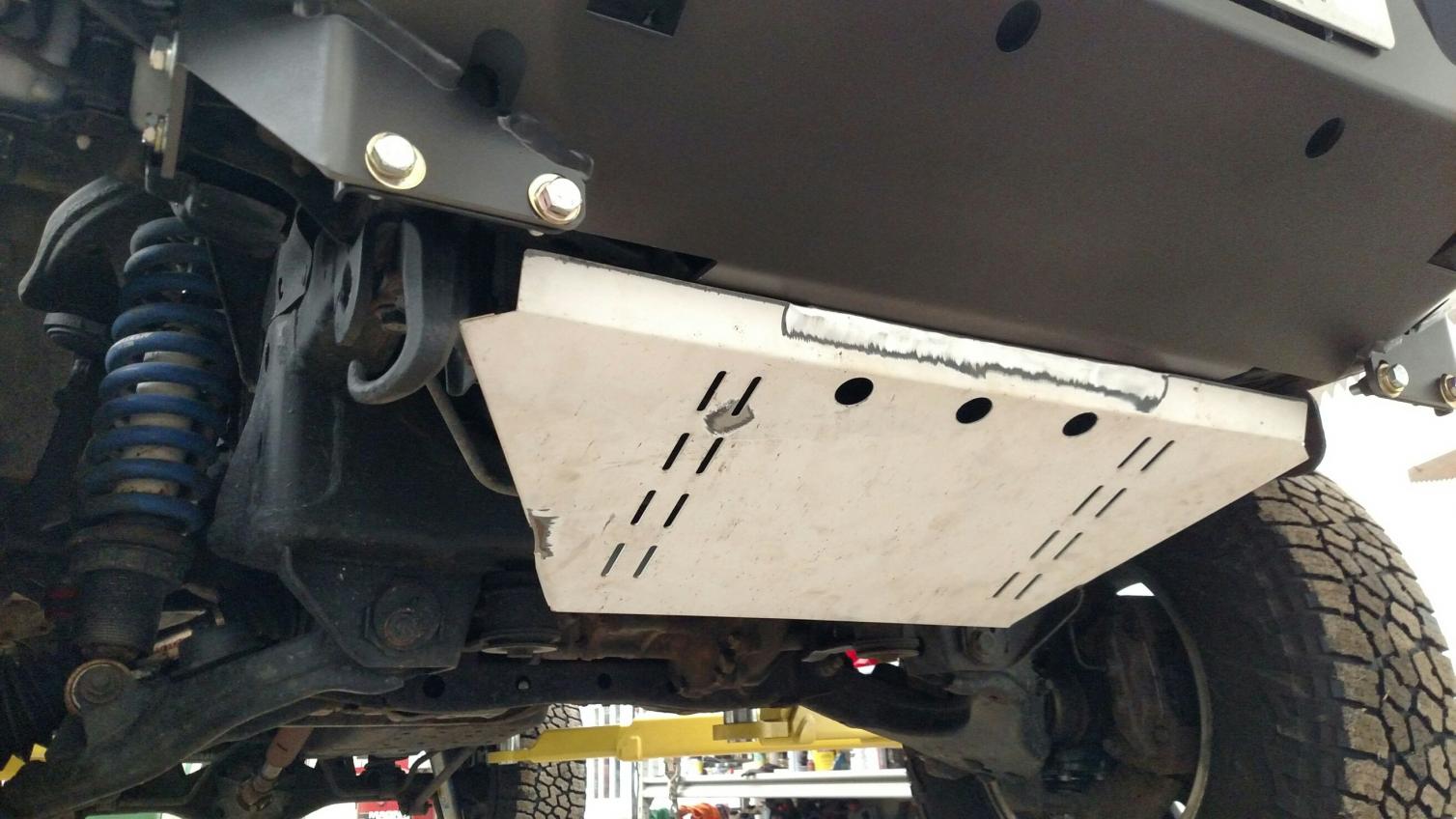

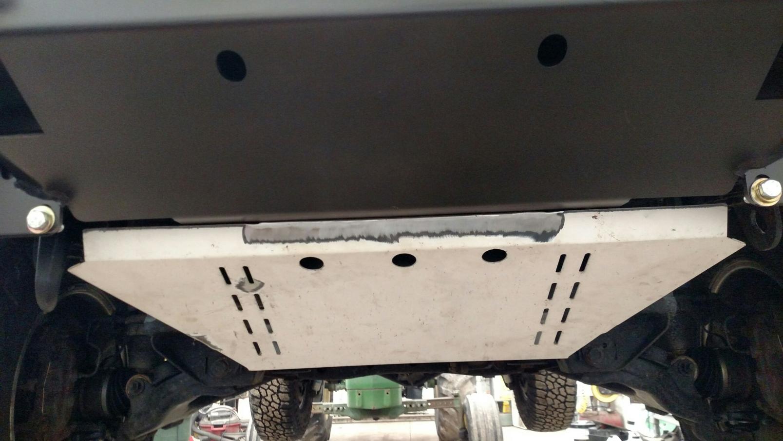

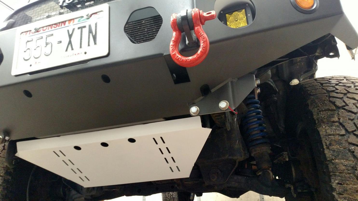

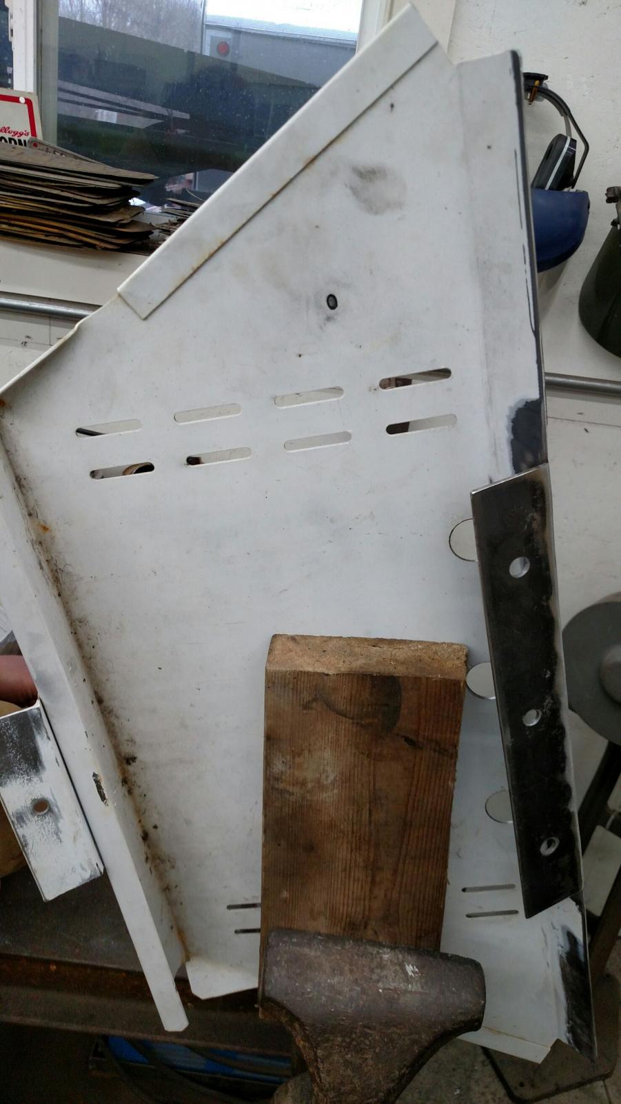

So most of you know or saw that I had fabbed a little front diff skid a while ago out of some thin cold roll plate I had laying around. Nothing too structural, mainly something for some light duty, lightweight protection. For now. Well, the 4xi bumper covered up my previous front mounting points and I needed to weld a new mounting plate on the front . I wanted to use three of the five lower skid rail bolts holding the bumper on, so started by drilling holes in the plate (PIC 1).

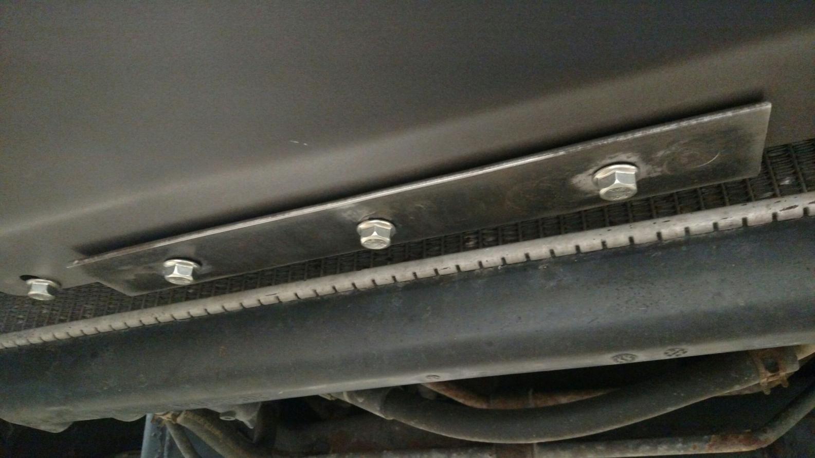

Next up, I measured my angle, ground off some of the old trashy paint (going to do it right this time), tacked it on, verified it on the truck, and laid a bead on the front face. Kept speeds and voltage low so I didn't burn through and to get good penetration. I then clamped it in the vice (wood blocks for support, brought out the flap disc, and flushed the welds on the outside surface for a clean mating edge. (PIC 2)
With that, I drilled clearance holes for inserting a 13mm socket using a 1" hole saw bit, which allowed me to access the now hidden attachment bolts, sandwiching the skid and lower lip of the bumper
Had to bolt it on now and check out fitment! (PICS 3-4)

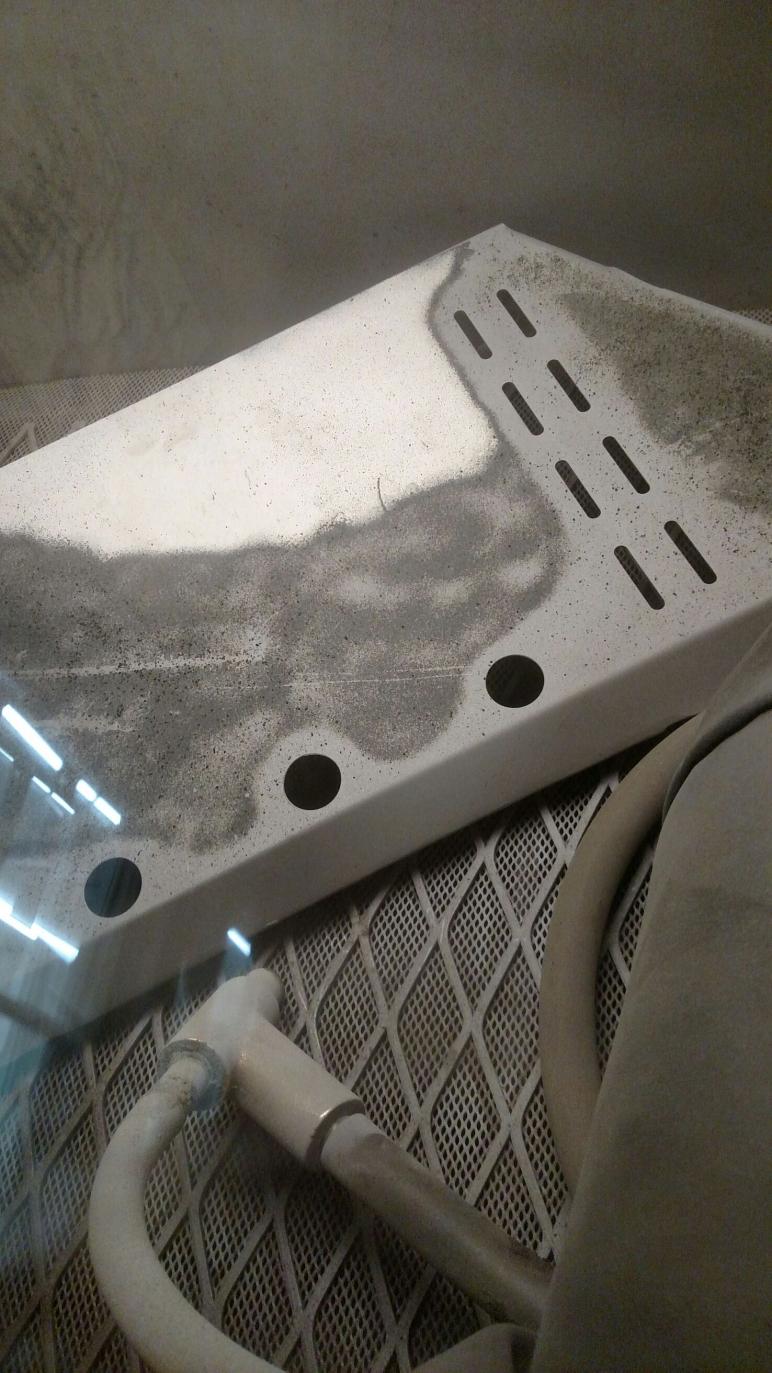

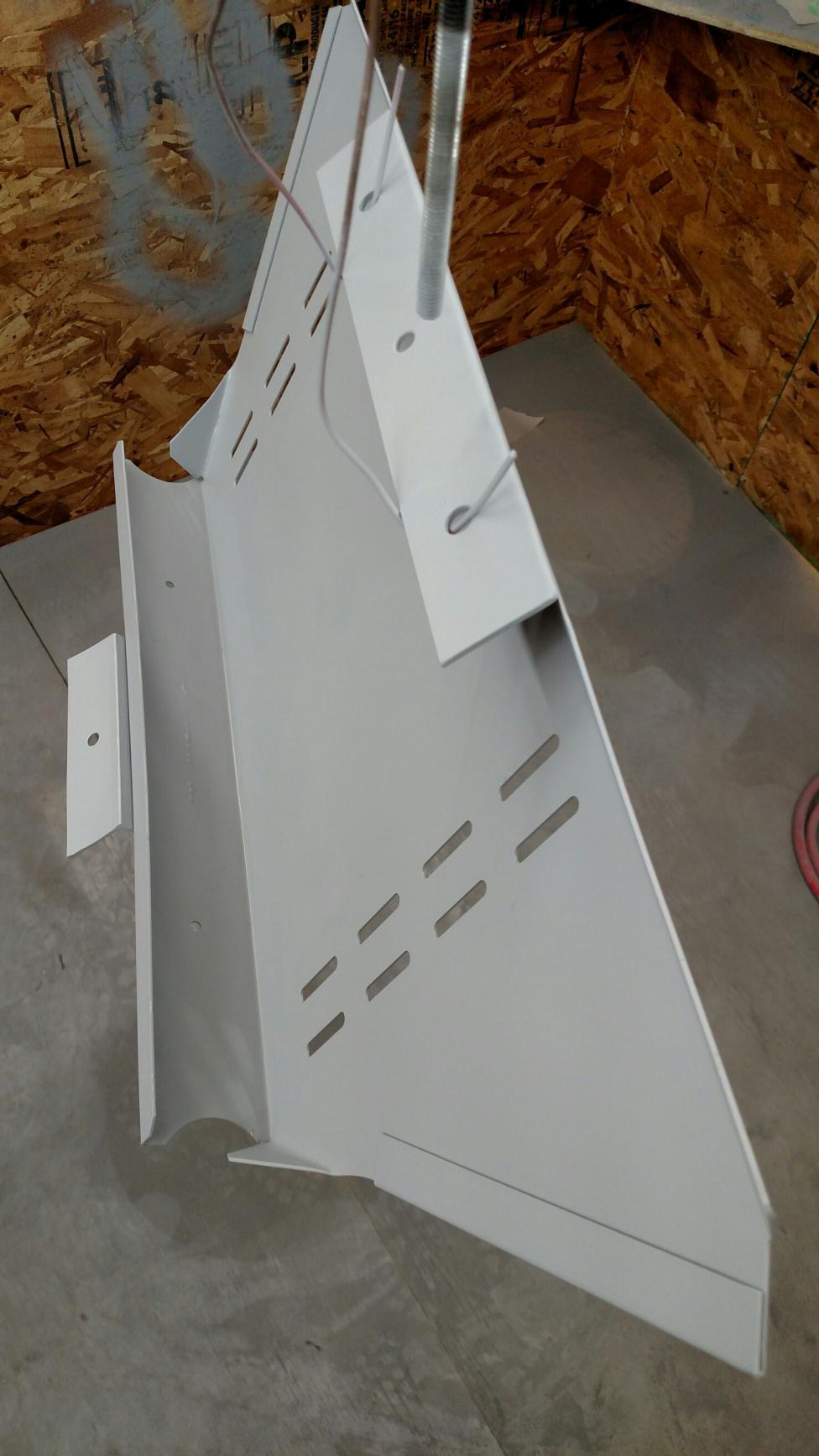

Now, since I went through all that work prepping and painting the bumper, i figured I would do a nice job on the skid. Started off by throwing it in the sandblaster and going to town... PIC 1
Then took it to the booth.... PIC 2
And slapped a nice coat of white on it as well. I was actually considering going wild with red or orange (should I have?), but I felt white was a more happy medium :drummer:
Literally all I need to do know is wait until it's dry and install. Also, I need to try to adjust my bumper down a tad because it's kinda close to hitting my drivers fender on the wing. Doesn't help I have a dent in the fender and it's likely tweaked. :crybaby:

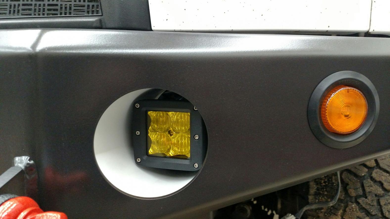

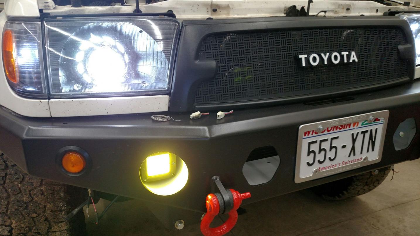

Another productive few hours last night. My skid was dry enough to install...

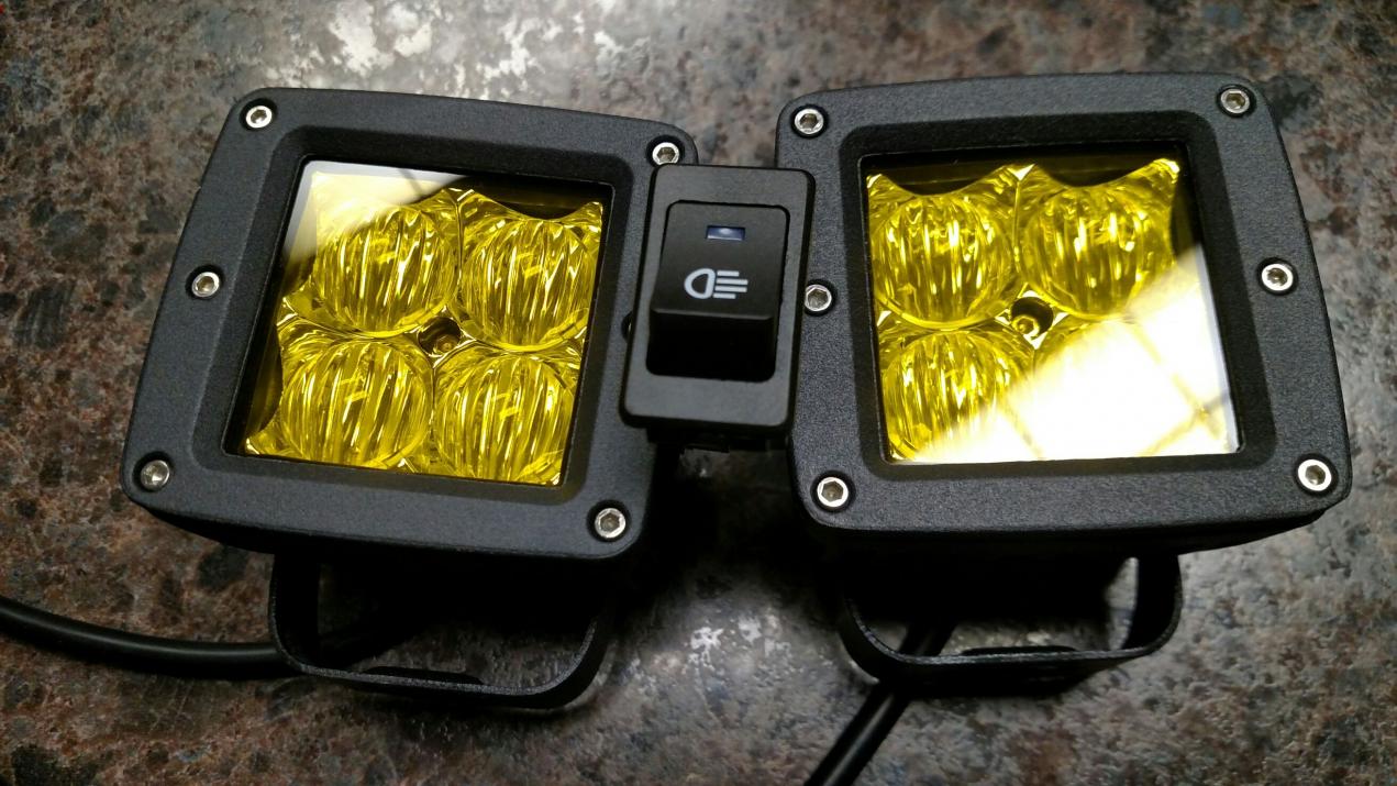

I got my 3" Amber Fog Cubes from Ebay here for a whopping $17...
They mounted up slick as snot...
And I got them wired up utilizing the factory fog harness!
Total Cost for fog implementation: $17 (fogs) + $9 (relay) +$8 (set of five rocker switches) == $34 -- can't complain here!
On a side note, since I went with the factory harness, and disabled my DRL's, I haven't figured out how I can get accessory power to these to allow these to work without my headlights on. Down the road I'll try again, but for now, they make a surprising amount of difference even with my headlights on. Hope they last a while!
Oh, and those who notice the wiring sticking out below the bumper- I'll have you know that everything was waterproofed and tidied up after the pictures were taken :beer:

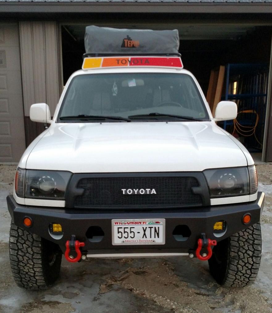

I guess I should add as well, I was able to drop the bumper 1/8" and now I'm not hitting the fenders when encountering body flex over bumps and such. Happy as a clam, I am. :hatsoff:
Took some pics today!! Big shout out to 4xinnovations [MENTION=76968]traxman25[/MENTION] again.

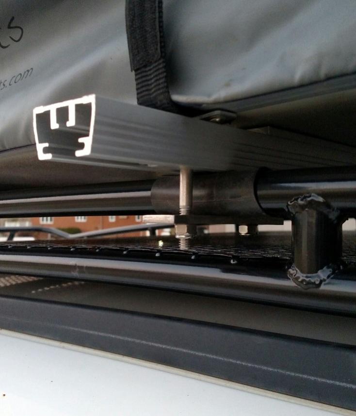

Mid-install of the RTT! I ended up running the mounting bars perpendicular to the WMM rack sides instead of utilizing another type of crossbar. Sits up there pretty nice- I really want to keep it up there but it doesn't pay for me to leave it up on top until it at least gets above freezing... I've got ants in my pants to take a trip though, so if anyone wants to meet up in a 10 hour radius of Wisconsin, hit me up!! IA, IL, IN, AR, KY, TN, KS... :cheers:

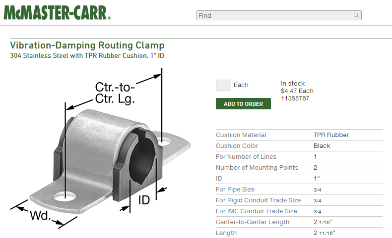

So I am not 100% on how I like the clamps that are provided with the Tepui when it comes to mounting on round rails. I was perusing a thread over on expedition portal and I came across this interesting post ... Long story short, someone utilized surface mount vibration-damping pipe routing clamps and they look slick as snot.
I might see if I can source some locally instead of going through McMaster Carr, or if not, I might make my own rubber grommets and bend myself up some clamps!
Here is the exact clamp I'd want- 304 SS, 1" OD tube. Anyone do something similar here on T4R?
