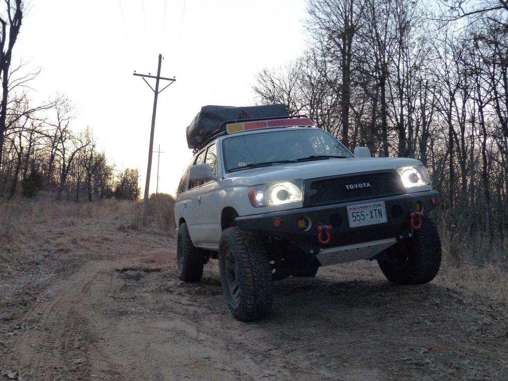

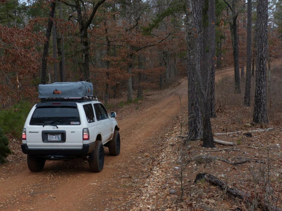

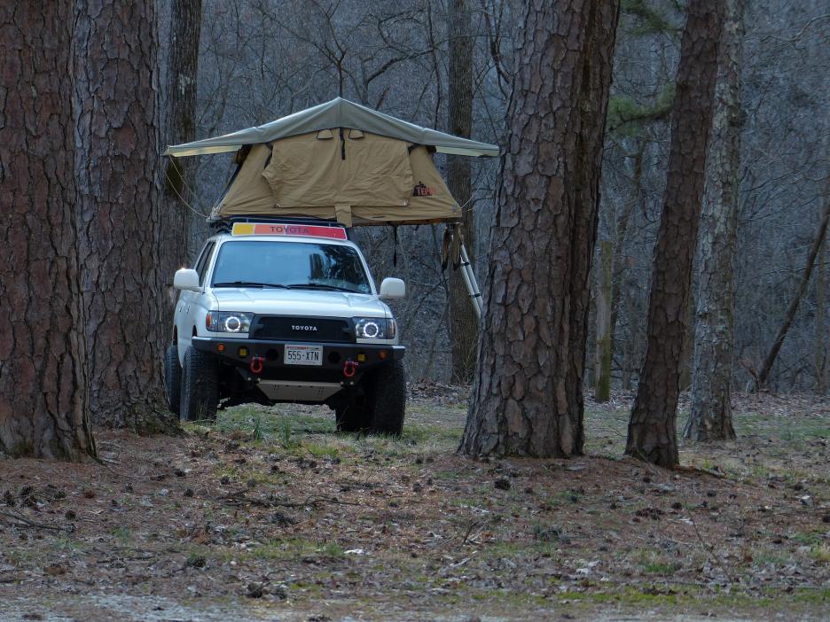

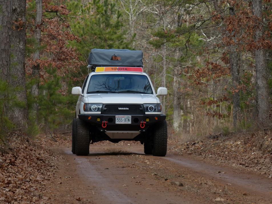

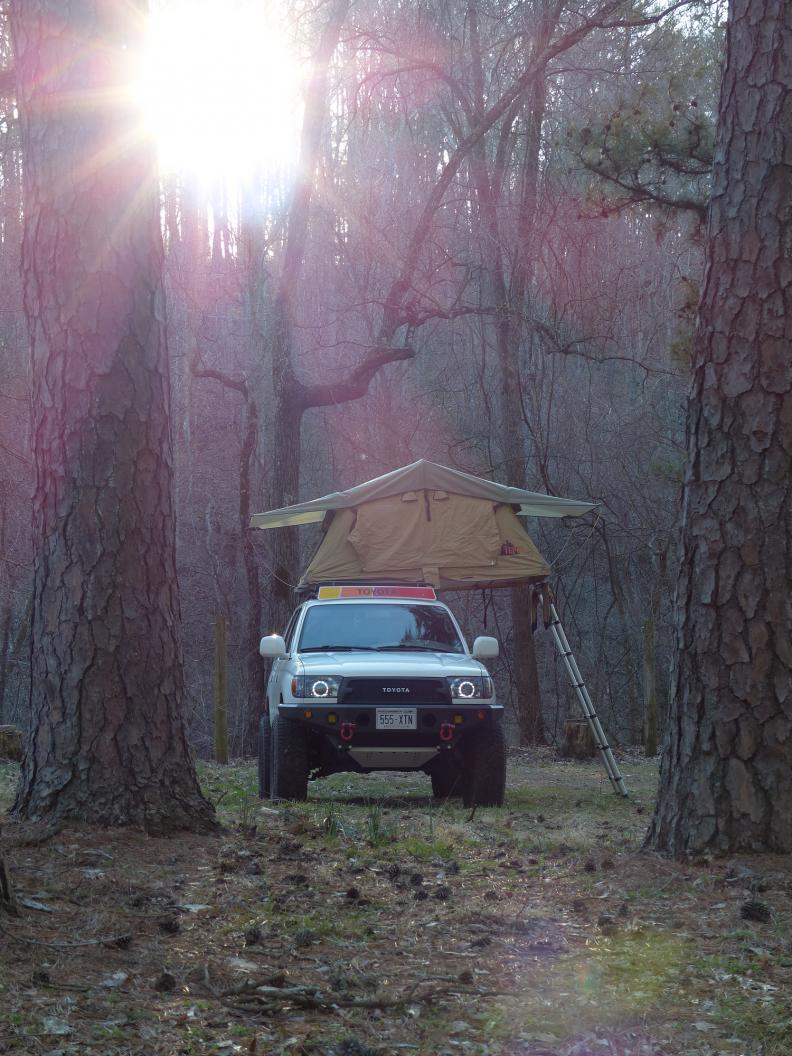

It's been awhile! Just put another 1400 mile, week long trip into the Iceberg. She handled it like a champ! Broke 220k miles, flyfished 6 rivers in Southern MO, averaged 16.5mpg, explored a couple caves, dealt with nights from 25-40 degrees in my RTT like a champ, had my first ever armadillo encounter, met up with my cousin in Kansas City for a brewery tour and visit, crossed 4 rivers, and most importantly, made a few friends camping along the way. It's safe to say I love this setup!

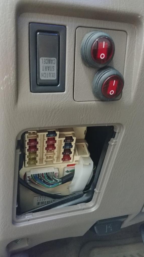

Well, I got the wiring done for the bar in between working my two new jobs... I'll have more pictures to come, but for now, just one to show how I utilized the OEM square switch blank for my two rockers, one for the amber floods, and one for the white spots in the bar.... I'm still designing a custom bracket for mounting this bar to m rack-- it's going to take me a wee bit!
Also, who likes my upside down clutch start cancel button?? :loco:
