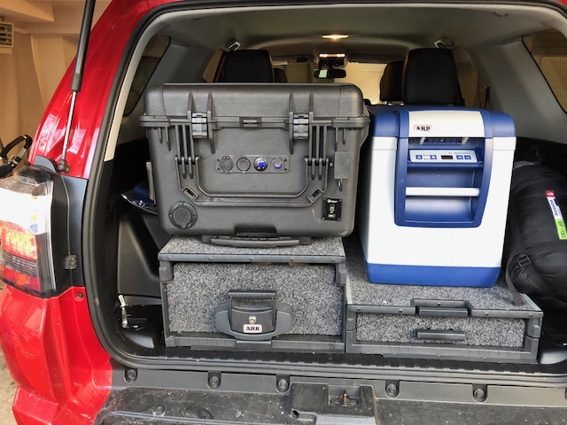

Thats great! Heres a trial fit with a portable battery pack/solar generator. Has the Battle Born 100aH Lithium battery in it. I may downsize the container, but all in weighs 65lbs. I'll work on the drawers this weekend.
what?? Ok here is a Jpeg

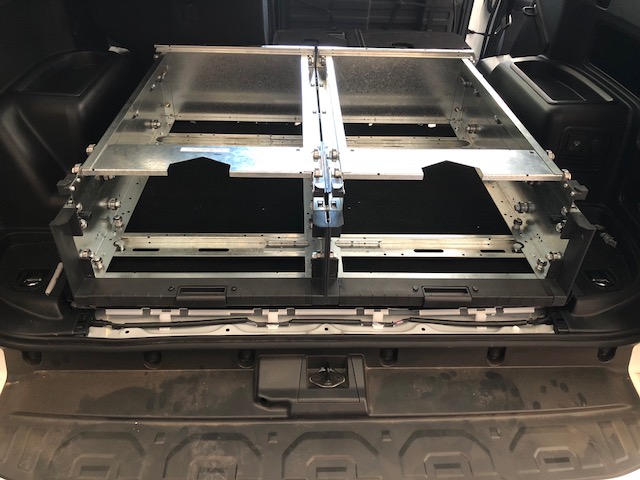

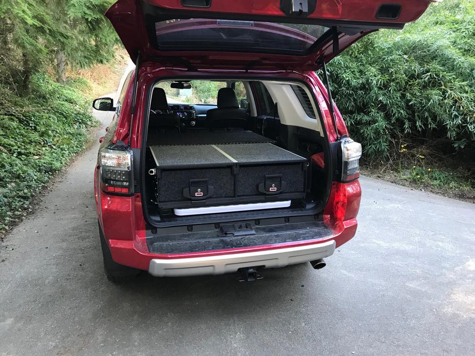

Easily removable ARB Drawer Install with table, bed
I just did an easily removable install of side-by-sdie ARB drawers into my 2018 4Runner, with a 35 inch square table underneath, and a bed platform slider on top of the drawers. The unit is turn-buckled to the load D-rings and very secure in case of a rollover.
To remove it, you slide out the table, undo the four turnbuckles, unplug the connector for in-drawer gadget charging and just slide the whole drawer unit out onto the table in the garage, and presto, you have an empty load area for hauling furniture and stuff.
If you are interested, I can take some detailed pics and write it up with a parts list. It's a great looking installation and very adaptable. Just ping me.

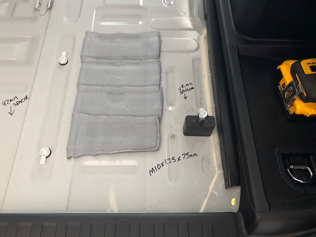

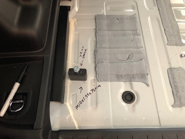

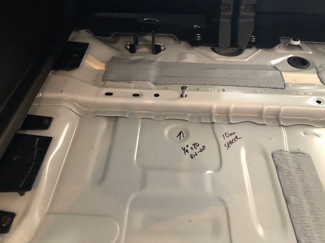

The ARB installation kit comes with 10mm, 6mm and 5mm plastic spacers. I elected to go with 10mm spacing in the back and 42mm in the front.

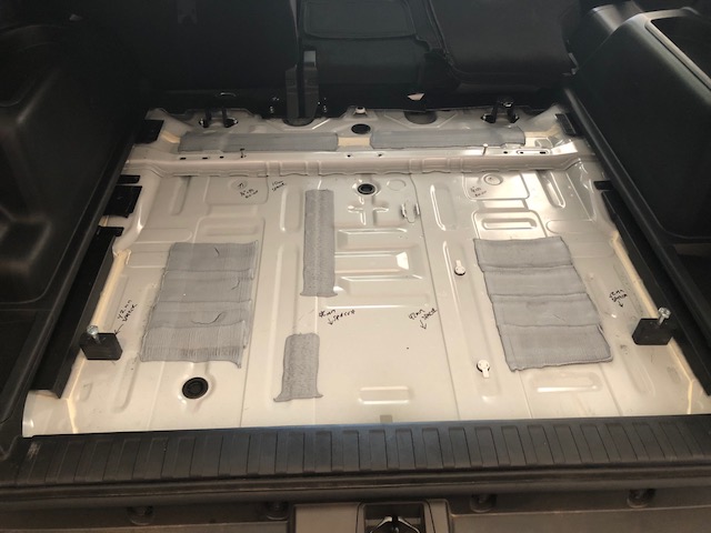

If you strip your cargo area down to the sheet metal, it should look something like this. You'll notice my bolts and spacers and bolts to the rear (of the truck) cargo area. I used previously established measurements to drill. This opened up the factory attachment points for the Toyota sliding cargo deck.

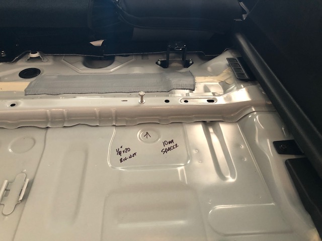

I used 14"x20 threaded insert rivets "riv-nuts" and 10mm spacers at the factory holes indicated by the arrow. This will get the above the rail is is fastened to, and flush with the foam and carpet.
If you go with 42mm spacing, in a factory truck it SHOULD level the drawers out enough so the drawer will stay where you leave it on level ground. If this is something you care about, I would suggest testing your set-up extensively with different configurations. I used M10x1.25mmx75mm bolts.

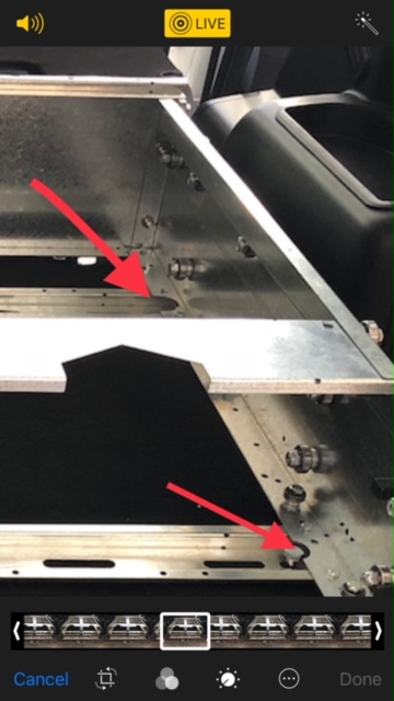

One of the most vague aspects of the ARB instructions is the "mounting hat" instructions. To make a long story short, mounting hat is the bottom rail of the drawers that run from left to right. If you reference the directions from the Slee website, you are looking for measurements for the Prado 150. Take my word for it: take the rails off, and mount them so they cover the socket notches in the frame referenced with red arrows below.
Right and left sides of the drawers have the same notches for reference.

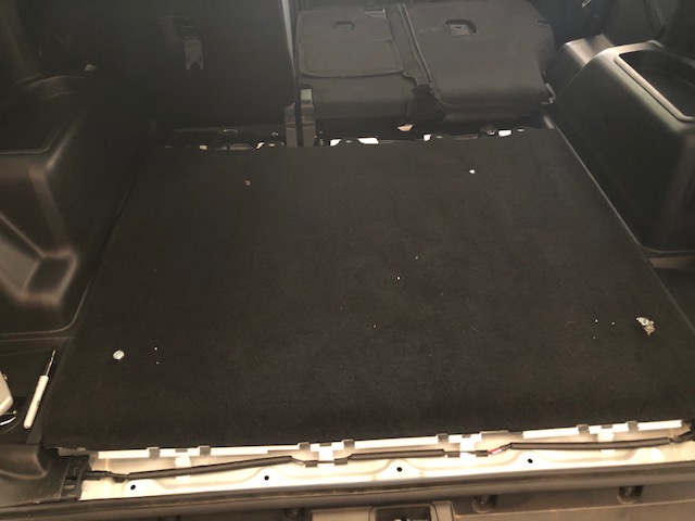

I used the drawer frames to notch out space in the factory foam to drop the spacers in. I elected to do it this way, so I could drop the spacers in and relatively expect them to stay in place. I laid the carpet on top of the bolts and spacers. I cut the carpet so the bolts would slide through.
Lastly, I dropped the frame in. I didn't fasten anything down until I could guarantee all the bolts were in. It was helpful too because I was somewhat able to lift the frames and carpeting to feel around. Not pictured is the rear trimming, and extra 42mm spacer toward the middle for load sharing, and the trim behind the seats with D-ring tie downs (they fit under this configuration.) It is tight, but it does fit. Make sure you install all this trimming before you bolt it down. I didn't, and cost myself a little time and effort.

For my set up, this sits flat on top of the factory sound deadening foam and carpet. I had a lot of 10mm spacers left over. You could easily adjust the spacing until to fit your needs.
