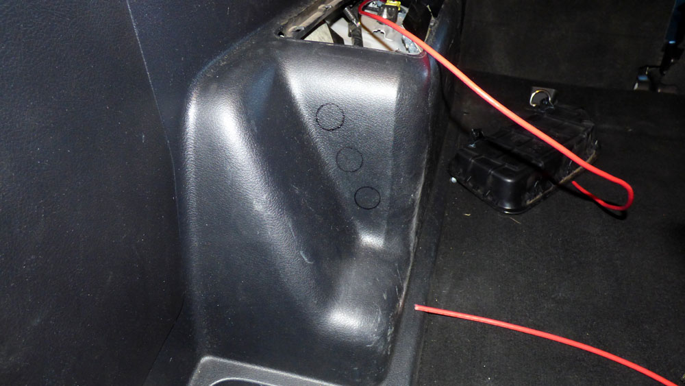

Been working on this. I didn't see a reason to go through the vehicle. So we're following the pre-existing loom we created for the rear CBI bumper rigid dually lights.
We're coming out from under the vehicle through one of the grommets under the vehicle, and installing the ARB outlet in that rear right tray over the right rear wheel. We're doing an on/off switch just for some added peace of mind to prevent any phantom draw when not using the fridge.

I ran down the driver side and mounted a new port.
