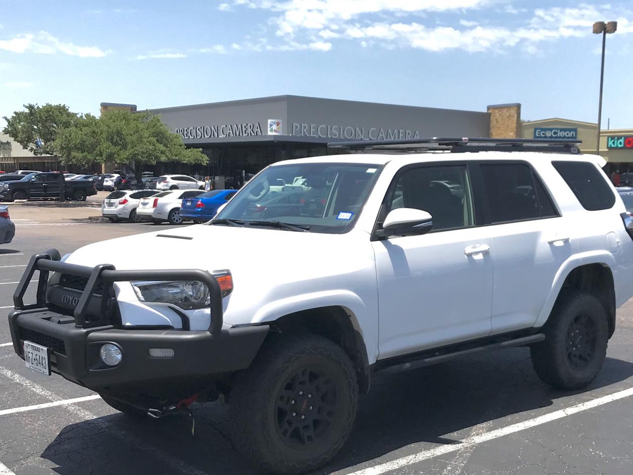

For those with the summit installed, how far out does the bumper sit in comparison to the trim near the wheel well? I feel like mine should be pushed out a bit more, but the shop who installed said it won't move anymore. If going over a bump/etc. the aerial brackets rub the plastic bit underneath.
Sent from my Pixel 2 XL using Tapatalk
Something isn’t right bud mine and all those I’ve see bumper sits flush with fender here’s a pic of mine as you can see it’s flushed bud..if you look through this tread alone you will see others
Thanks for sharing the picture. I saw a few others with side shots, not many with it straight on.
I think mine is mounted too low. There's the extra bit of the plastic bumper above the ARB bumper, where all the other pictures seem to not have this. I think if that top plastic bit is removed and the bumper is mounted higher, that would fix the issue.
Yeah you can see allpro has no factory front bumper clipped onto the fender behind the headlight. His bumper sits just below the fender. You can see the black plastic part you clip the front bumper into. Looks like it's too low. Didn't think that would be possible TBH.
It it might also just be angled down towards your rear tire. IDK if that is possible either but it looks like it's on an angle with the fender instead of parallel along the horizontal axis of the bodyline.
I think that's exactly it. I brought it back in to the shop who install and had them change the angle to point down more to clear the top so the aerial brackets weren't rubbing. Didn't occur to me until seeing other pictures that mine was too low.
