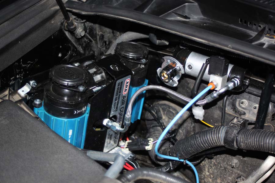

Here is my setup.... It has been fantastic to say the least. It's an extremely durable bracket mounted straight to the fender wheel using the pre existing 11mm thread bolts and then mounted to side fender wall using the pre-threaded 10mm holes that are there. It’s sturdy as a rock and doesn't move even if I try to make it move.
Pros as to why it’s mounted this way:
1) Utilizes space
2) Easily accessible to all plumbing/wiring/solenoids etc...
3) Leave space TO WORK ON and yes you need it. Lines with compressed air need tightening over time. Period!
I have tried over 5 different sources to get these made for you fellow 5th gen'ers and had no luck. It's actually quite a time consuming process as the bracket fits to the contour of the wheel well. Therefore it takes time and time is money. :(
Here she is...
Here is a picture any questions feel free to ask...

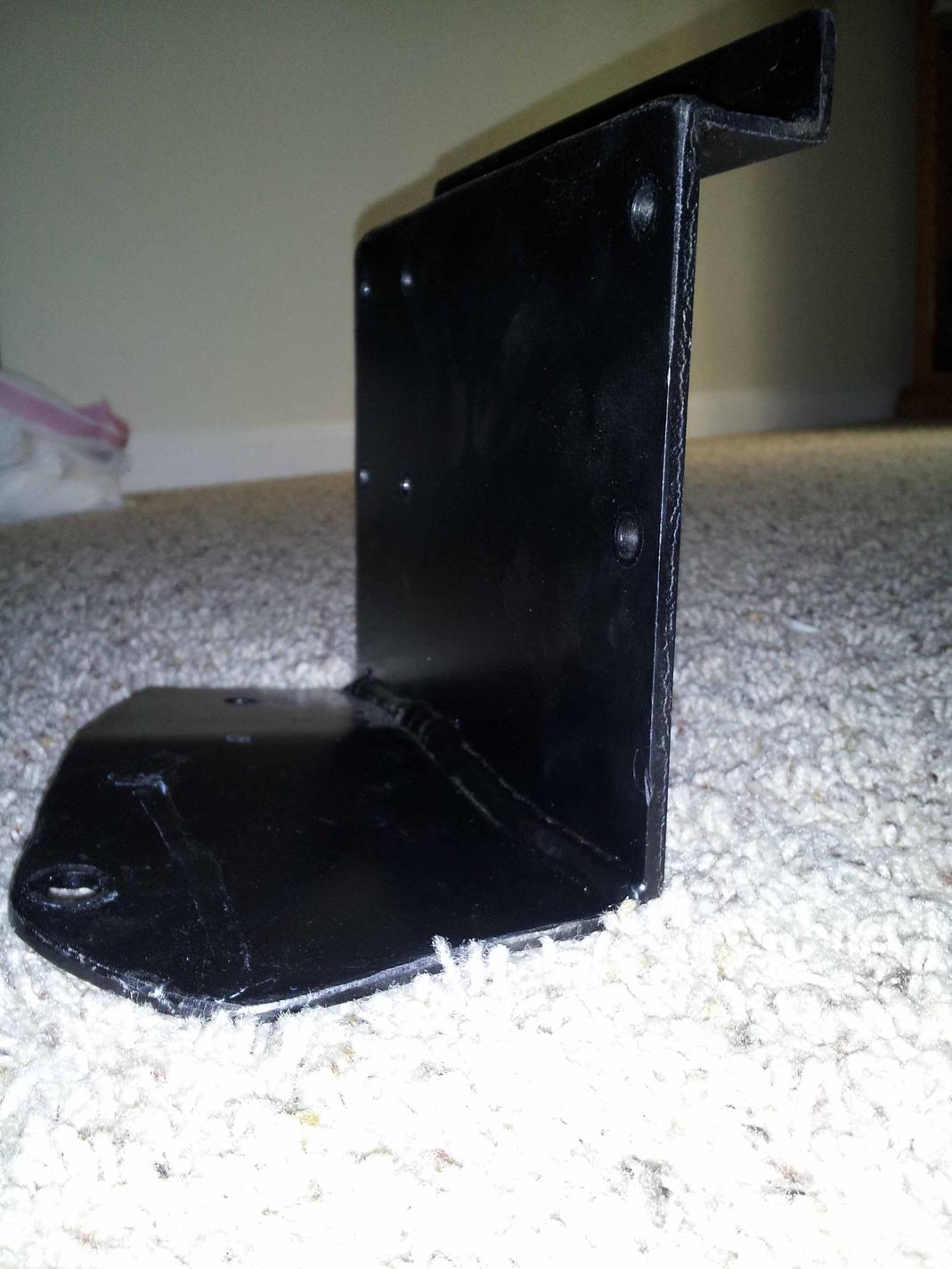

I pulled my compressor this afternoon to leak test (my compressor was coming on for about 1 second every minute to recharge the system so I knew something was off). I Teflon taped all the connections and still had a leak. I eventually found out that my air locker manifold had a leak along the bottom seam. I emailed ARB tech support and will hopefully get a new one sent out soon.
Anyway. I snapped more pictures of the bracket with it out. (it's still out by the way, so if anyone has any pic requests let me know)
Looking good Jangoforhire. I like the 2 feet (previously I though it had 1). The cross bars on the back are reassuring as well. I still wouldn't mind tying into the firewall. Did you happen to take a look as you took it out how it's positioned in relation to one of the threaded holes in the firewall or the threaded studs?
I may simply take it "as is" and add that contact point myself.
Thanks for the additional pics. Looking forward to hearing the quote.
Great pictures, I too may be interested. As I look at the mounting location on my TE, I see two connectors that may be in the way. Did you have to do anything with them to make the ARB fit, or does the mount fit over and/or around them?
You just have to disconnect the wiring harnesses from their anchor points on the wheel well and move them out of the way when the compressor goes in, thats it. I'll get a picture of the wheel well soon, mine is still taken out.
