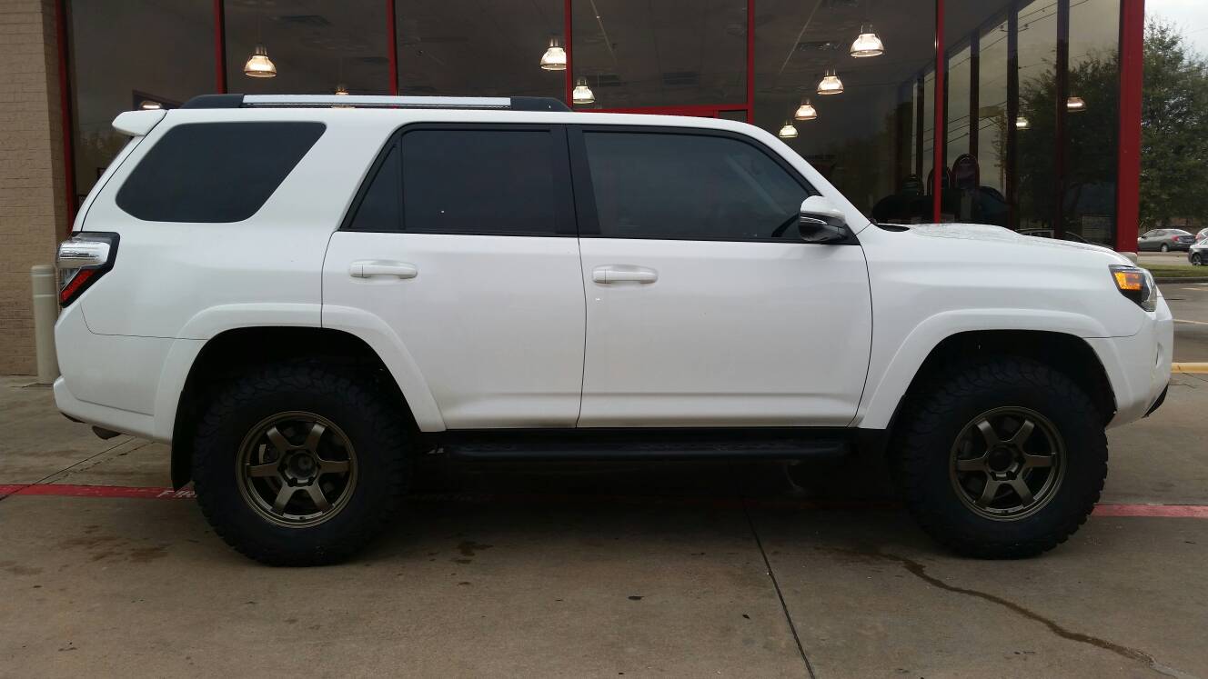

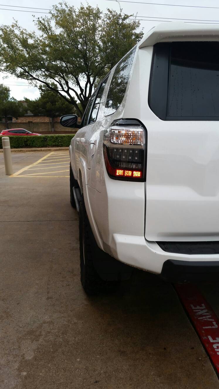

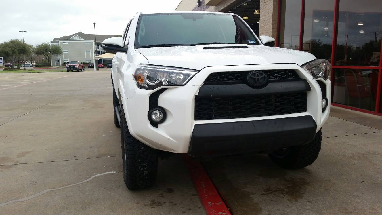

Here she is, 285 70 17, bit of a rub but doesn't look too bad. I'll be taking the heat gun to her today. I'll update with with the results in a bit hopefully itll be enough. Alignment scheduled for today and will continue to work on the liners. Enjoy!
