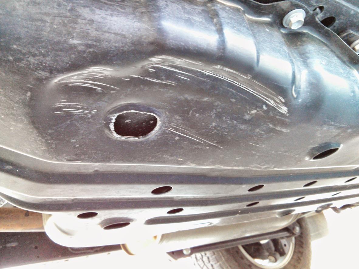

I don't do heavy off roading, but I am on fire roads and unpaved areas. When I backed up my rear end dropped almost high centering me on this dirt and rock pile. Luckily, I came off of it as soon as I heard scraping, and it was just small rock and loose dirt. Though now I see the value in true skids, that exhaust pipe is totally exposed.
<a href="http://s1113.photobucket.com/user/Frank_Rebelo/media/2015-01-25140742HDR_zpsba93c296_1.jpg.html" target="_blank"><img src="http://i1113.photobucket.com/albums/k507/Frank_Rebelo/2015-01-25140742HDR_zpsba93c296_1.jpg" border="0" alt="Close Call Skid photo 2015-01-25140742HDR_zpsba93c296_1.jpg"/></a>
