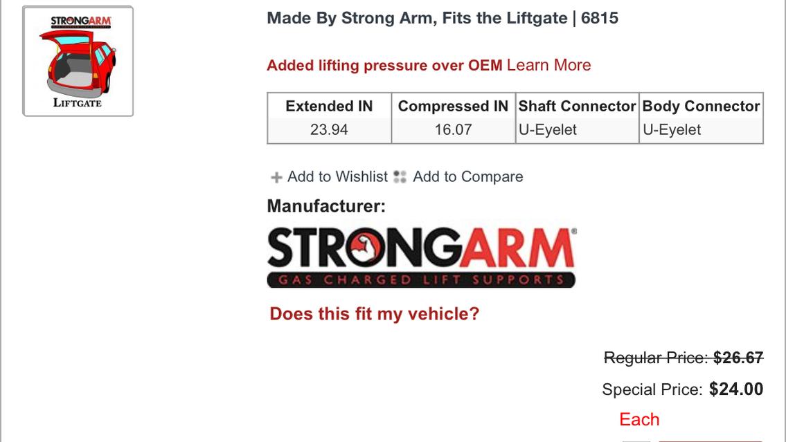

Here's what I use in the cold months.
i cant believe that no one makes a decent lift support for these trucks. I also cant believe that the OEM ones are over two hundred a piece, that is insane!
Well this sucks, how does everyone deal with not having there rear door raise in winter??
Qty (2) Toyota 4Runner 1996 To 2002 Liftgate Lift Supports (Added Lifting Force) | eBay
I haven't gotten these but I will. Strong Arm lists 2 types of supports for our truck one set is "added lifting force" which supposedly is better in the winter months. Now whether it will clock you in the chin in the summer months I don't know.
I think I'm going to order these and I'll report back how they work.
No way in hell I'm paying over 400 dollars for oem ones..
I bought the eBay strong arms a couple of years ago and they have so k d ok up until now, but it's been really cold here. I'd buy again
