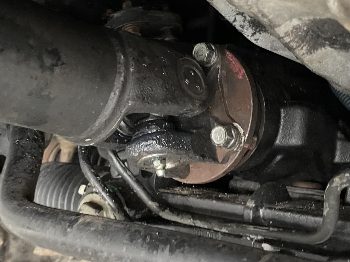

By the way, is this how the front driveshaft connection is supposed to look? Wondering about the metal piece just sticking out there. Thanks.
If your asking about grease zerk no that is not normal on 4Runners that is after market U joint. That type has caused vibration problems when I've used them. toyota u joints have zerk fitting in the center of spider look at the others you'll see what I mean.
That's an aftermarket U-Joint, so the position of the zerk fitting is normal for that. Toyota tends to tuck their zerk fittings on serviceable u-joints in the middle on the "smaller" drive shafts (the 2nd gen Tundra, Sequoia, and LC200's have them on the edge like that).
