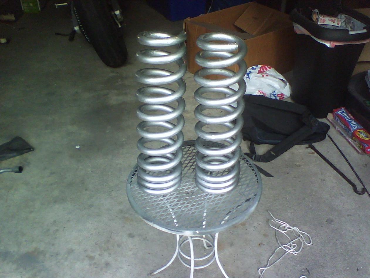

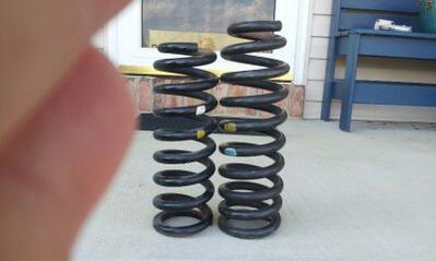

I bought these springs from someone on here and installed them this past weekend and didn't really think about it until now. The springs on the left are the stock 2001 springs and the one on the right is the TRD tundra spring. Aren't they supposed to be progressive? They don't look like they are. The color codes are correct but I wonder if I've been ripped off. Could someone please tell me if this is what the TRD tundra springs look like because they sure don't look like progressive rate to me!

I think thats what they all look like. Whats the color code on the other coil? I have tundra coils and they look the same. They can still be progressive if the coil is tempered differently from top to bottom. My guess is that the bottom portion (opposite of how its standing in your photo) is harder, and toward the top the coil gets progressively softer. I know people say theyre progressive, but Ive never seen that info. Not saying I dont believe it, but out of curiosity Id like to see where Toyota says it
Should be y/t and y/b. They look like my Tundra TRD springs. I never knew you could tell a spring was progressive by looking at it.
The springs are yellow/yellow and yellow/blue. The color codes were right just wasn't sure if they were standard Tundra springs that someone changed the paint codes on to make a few bucks. Usually progressive rate springs you can tell because the distance between the coils changes from top to bottom or bottom to top. They are tightly wrapped which makes them soft in that area, and then larger spaced which makes them stiff.
It's too late now as the springs are on and I'm not about to take them off unless they ride like crap but just wanted to confirm what I had. I would also like to know what the difference between the TRD springs and the standard ones really is.

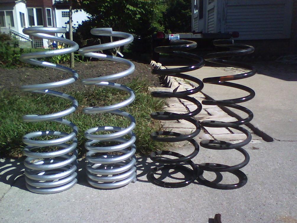

Heres what progressive coils usually look like. These are my old performance products coils.
