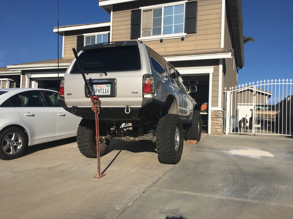

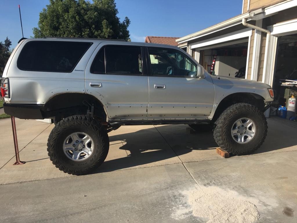

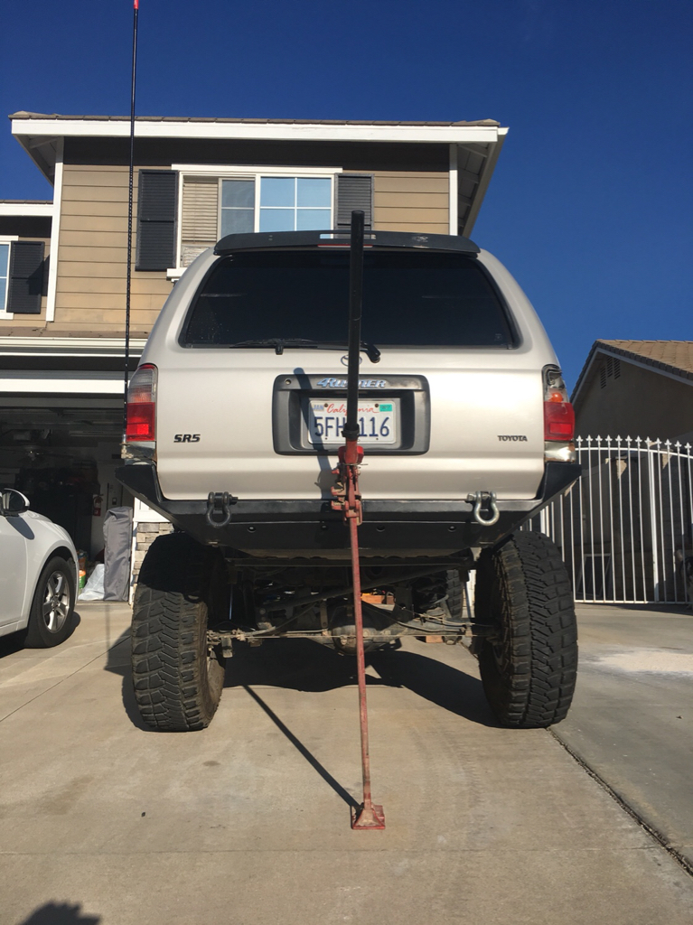

Just a couple pics I took throughout the process. Used my Hi-Lift to jack it up since it was already out and took a picture at full droop because why not.

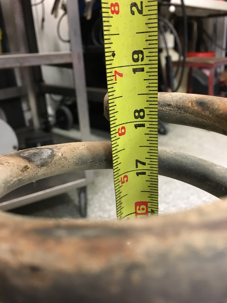

Measured the free height of my rear 8 wrap coils since they are extremely loose at full droop. Enough that I can pull them by hand. I am hoping to find a taller set of coils that provides 3” max lift while unloaded. Obviously can’t go with 7 wraps at this point and I don’t want 9 wraps because I don’t want a higher ride height.

Fyi i went through the same search with my rear springs.
Ride height was my lowest priority behind spring rate and free height. Ive had all the springs on this list at some point and preferred the superflex. Considering the weight you have (2nd tank, no tire carrier) id say you would be at about 3.25" of lift with them.
OME 890 : 190 lbs/in - 16.7in free height
OME 891 : 210 lbs/in - 16.5in free height
Superflex: 210 lbs/in - 19.5in free height
OME 861 : 250 lbs/in - 19.2in free height
Most are progressive spring rates of course, so the values listed are the rates at normal load conditions according to toytec and OME.
Thanks for the info 4-Ripcord! It sounds like the Superflex coils might be just tall enough to keep my coil seated properly at full droop. Spring rate should be pretty good too for what I need. I’d prefer something a little taller free height and softer but that might be only doable custom spring that I don’t really want to deal with.
They were the tallest and softest springs i could find. Id say its worth a shot at least! I just hope ride height doesn't get too tall.
My Superflex coils sat high for the first few months and was perfect for my weight, but after they settled it dropped to below three inches of lift and started to cause issues for me and all my weight. So if my theory is not flawed you may sit high for the first few months then settle to a perfect ride height. I also never had issues with the coils falling out/being loose at full droop.

I just measured up my Toytec 9602RC's. That's there standard 3" lift coil. They are just under 18.5 as well. So you can probably cross them off the list. If you want to try them anyway your more than welcome to if you ever make it up to Bishop. There sitting on the shelf since I tossed the 861's on.
Since the springs are inboard of the rear shocks, your springs cannot get to full droop unless the rear end is in the air. When articulating, the springs will be slightly more compressed than full axle droop. I think you'll want to check with articulation, not full droop to verify your current springs are ok.
-Charlie
Based on the info that you guys provided and the info on ToyTecs website. The Superflex coils might be the best option. I wonder how tall a set of used Superflex coils will sit at their free height? If they are under 19", there really isn't any point in making the swap. My ideal setup would be only 2.5" of lift since my front is already pretty low and once I go to coilovers, I'd like to drop everything down another inch or so. With a full tank and no load, I am sitting around 23.75" Hub to Fender in the rear. When fully loaded with camping gear (Maybe up to 400lbs) I sit about an inch lower. So in reality the superflex coils will only help with preload at full droop. Not sure how beneficial it would be to spend $200. My coils don't fall out on their own yet, but they are really loose. I bet if I keep doing what I'm doing they will sag enough to fall out on their own pretty soon. I'll keep an eye out for a used set.

You sir need a bigger jack, good gawd thats some nice droop
I thought the same thing when I was almost maxed out on my 48" jack. If I go to the 60" jack, I won't be able to use my current mounting setup.
