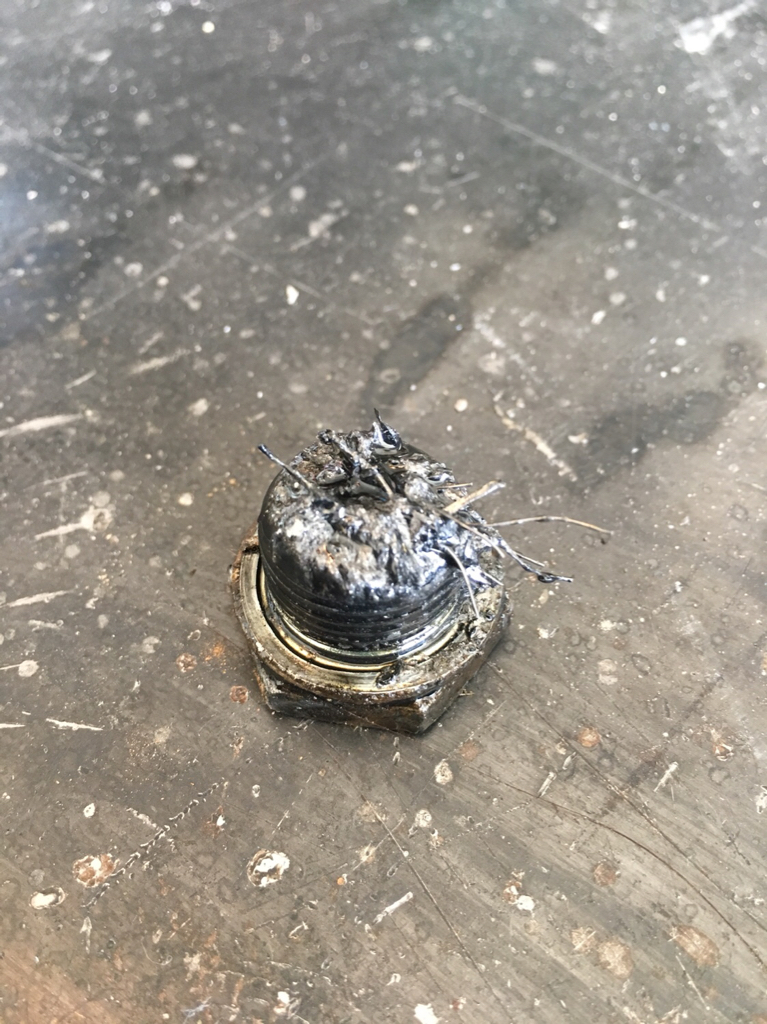

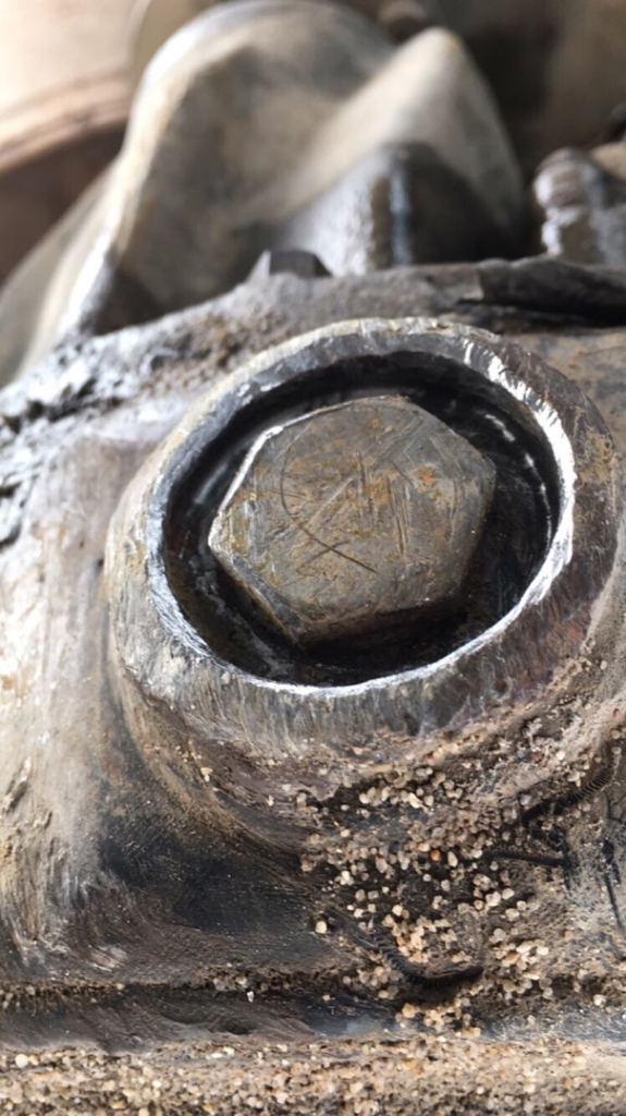

Draining the diff was more work than it should have been. The ring around the plug was so mangled I couldn’t get a socket on it. Cleaned it all up with a Dremal and rounded the edges to help keep it from happening again too easy.

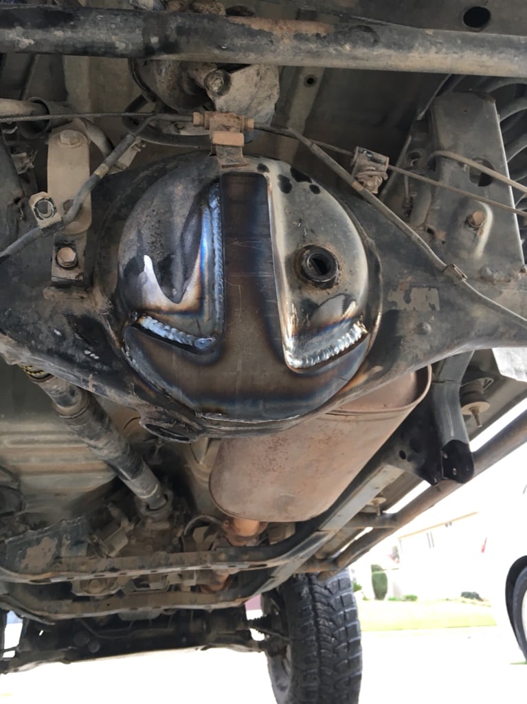

While I had the fluid out, I figured it would be a good time to weld on the diff protection.

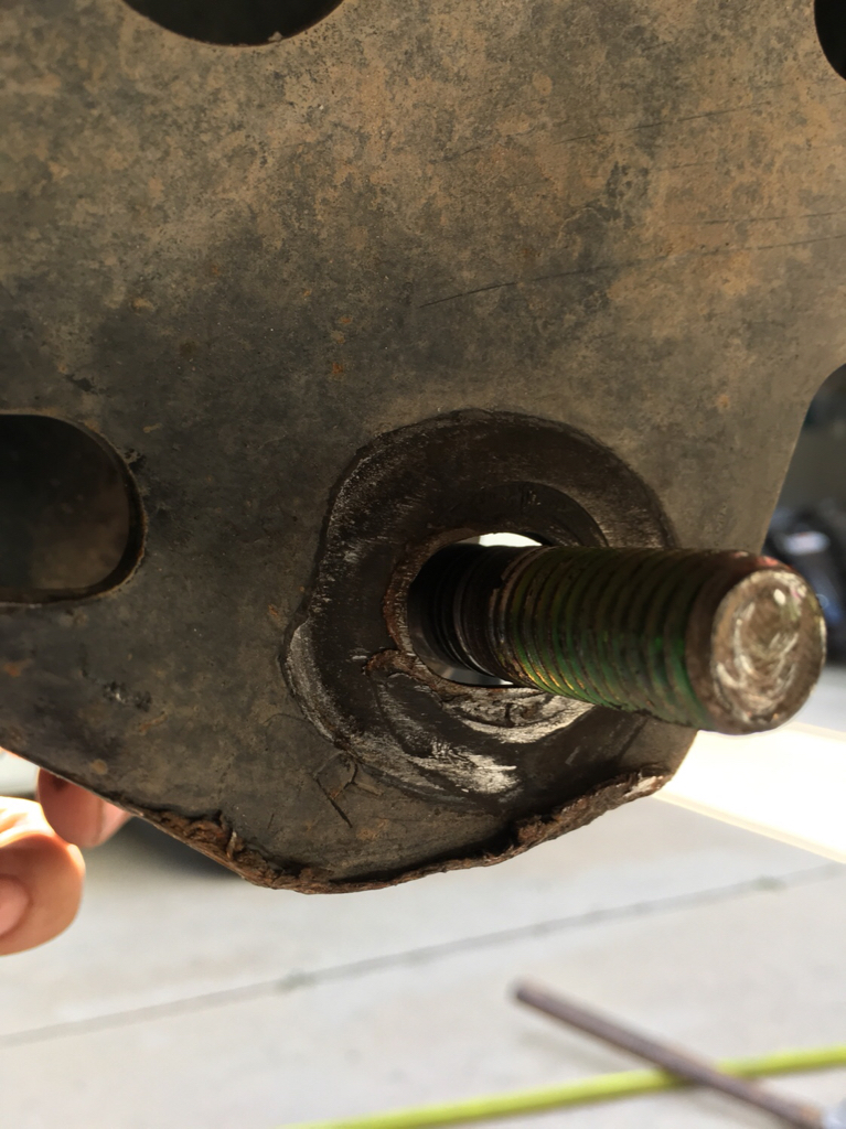

My lower link mounts were starting to wallow out so I bought some Ruff Stuff weld washers to fix it. Great product for a really good price. Didn’t get any after pics but the passenger side was pretty bad.

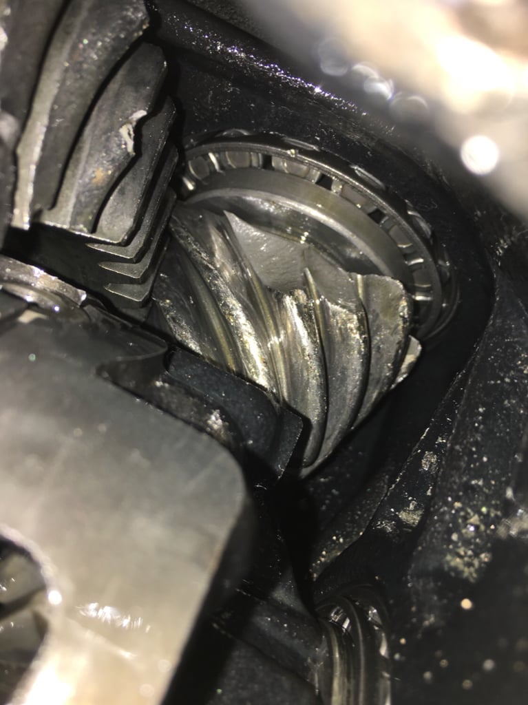

Dude! How did you get home? What are the plans now? I don't think I've ever seen a diff like that.
Holy shit! that's by far the worst Ive seen someone strip off a ring gear. Looks like you went after it with an angle grinder. I thought my front end that is still spitting out chunks of spider gear was bad but damn. Seeing this kind of stuff is what scares me off of the thought of ever going to 35s

[MENTION=84643]JBurt[/MENTION] I drove down to Running Springs and called AAA. The plan now is to try to warranty it through ECGS. This is the second time I've done this now. Last time I went through ECGS and they have a 5 year warranty on all rebuilt 3rd members and Differentials.
[MENTION=121903]Black798[/MENTION] It wasn't so bad when it first happened. I think at first it was just a couple teeth on the ring gear but the pinion gear felt fine. After driving almost 2 miles through the trail then another 10 miles or so to the nearest town with cell service it looks and felt a hell of a lot worse than it did when it first happened. Make the jump to 35's and don't drive like an ass and try to do stuff in 2wd that requires 4wd and you'll be fine.

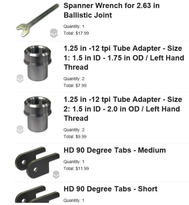

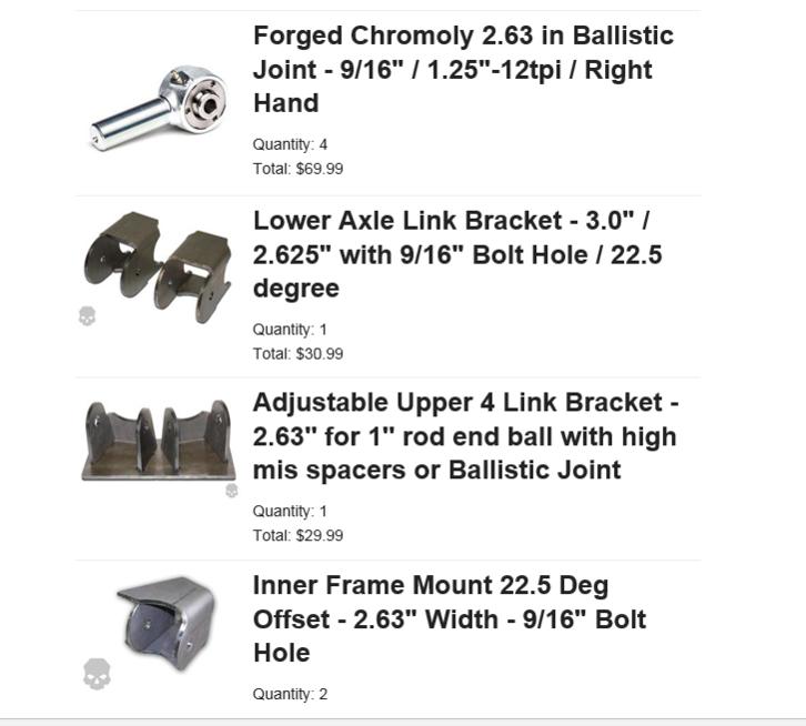

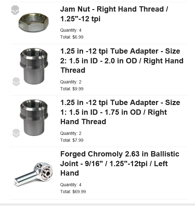

Second thing is I just placed my order for all the parts needed to start my double triangulated 4-link. I was able to get most of the stuff needed from Ballistic Fab. I ordered all 8 Ballistic joints with jam nuts and tube adapters (4 sets of RH thread & 4 LH thread), link mounting brackets and tabs for all corners, and the spanner wrench for the joints. Only thing I need to buy is the material for the crossmember and the DOM tubing for the links themselves and the hardware for the links and removable crossmember. For the crossmember, I will probably just get some 2" x 4" x .120" square tubing tucked right below the transfer case yoke. The stock rear crossmember will obviously be cut off. Super stoked to get all the parts and start working on it all. I need to move/replace my muffler, and eliminate the rear catalytic converter first though.

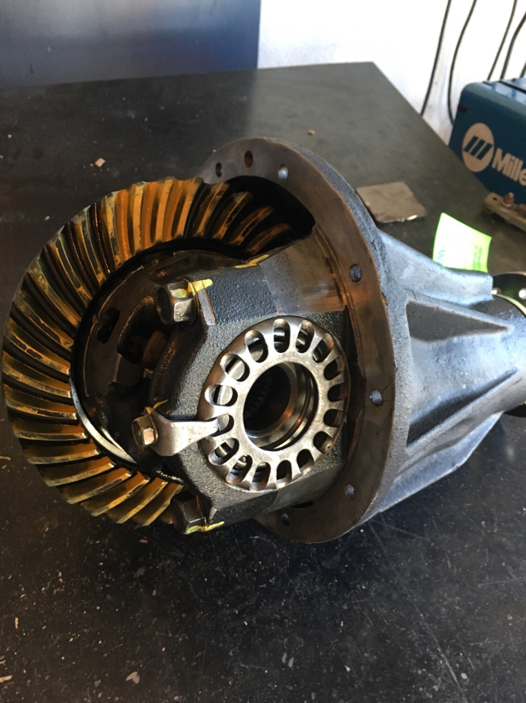

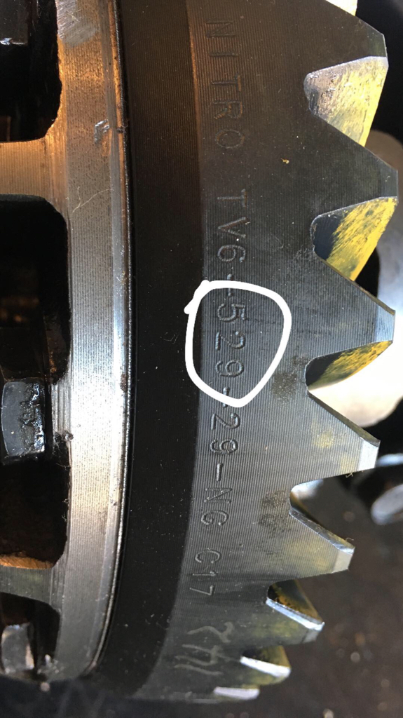

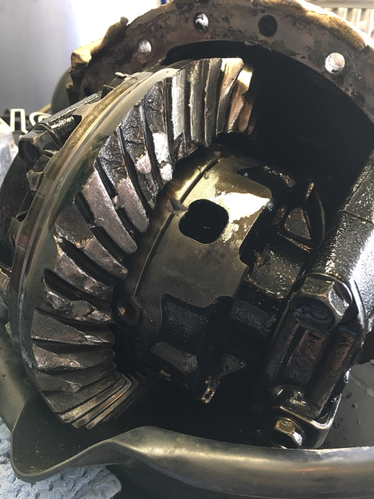

Got my rear 3rd member back from ECGS over the weekend. Took much longer than it should have and ECGS admitted that, so they didn’t charge me the $50 for the double drilled flange needed for the 5.29 gears. They also didn’t charge me for the shipping too them, which should have cost roughly $50. I spoke with Kevin last Wednesday about an update and he said they totally dropped the ball and have been super swamped. He promised me that the diff would be shipped that day. ECGS definitely has some of the best customer service around. I will definitely continue to use them from here on out for all my gear and axle needs.
So in total this whole ordeal cost me a few weeks without my rig and $5 for a Home Depot bucket to ship the diff in. My neighbor even bought my gear oil for helping him with a project of his since he was already at the auto parts store. Not bad at all!
Now I need to decide what to do about my front end. I’m debating on an ARB or Lunchbox locker. I was gonna just do the lunchbox locker to save money since I knew I wanted to cut the front end off anyways, but then reality kicked in and I know I won’t have the time (or money) to tackle that project anytime soon. Trying to be 100% debt free and buy my wife a new vehicle first. Maybe summer 2019 I can tackle that project. So now I have a longer term plan to keep my front end the way it is for at least another year, I might as well spend the extra money on an ARB up front. I don’t really have an extra $1500 laying around (to spend on the 4runner), so once I save up some 4runner funds, I’ll be going with an ARB up front.
So far I am really enjoying these 5.29 gears. I’ve got about 100 miles on them so far but most of them are city and only a couple miles at 70+mph on the highway. Definitely glad I went with 5.29 gears. The BeerRunner is still slow but it gets up just a little better off the line and it’s shifting points are back to where I feel they should be. I don’t feel like I would have been happy with 4.88. I honestly thought that the 5.29’s would be more noticeable based on what some folks were saying. 35’s + Auto trans = 5.29’s IMO.

Cleaned and Rebuilt 3rd Member

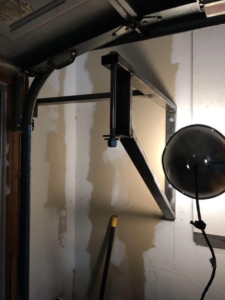

Project I helped my neighbor with. It’s a bracket for his air hose reel.

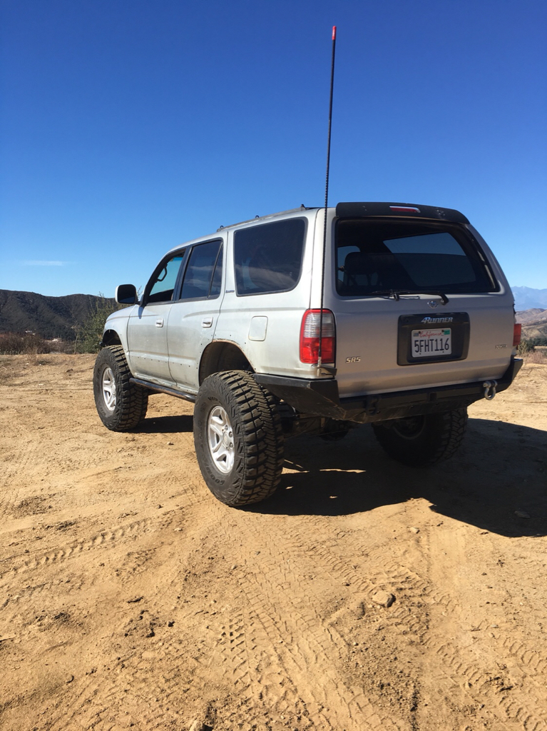

Quick celebratory test in some dirt by my house.
