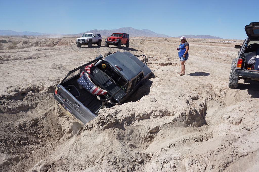

So all that fun didn’t come without any damage. If you haven’t been out to the Truckhaven/Ocotillo Wells area, it’s all big mud hills, washes and notches (which are giant ruts that can start from being a little rut that you can drive over then turn into a 10-15 foot deep mini canyon that a vehicle can barely squeeze through). Well there were some spots that were just that, squeezing through and hitting body panels. Got a nice set of scratches along with a dent on the rear passenger side quarter panel from Friday night. Then on Saturday I cut the corner just a couple inches too close to the wall and blew out my drivers side rear window. Then rubbed the wall again shortly after than in the same spot. Good thing there was no window to break that time! Then what ended the night for be want blowing out my rear end again going up a sandy hill coming out of one of the notches.

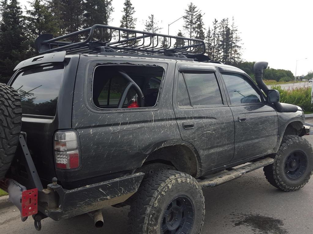

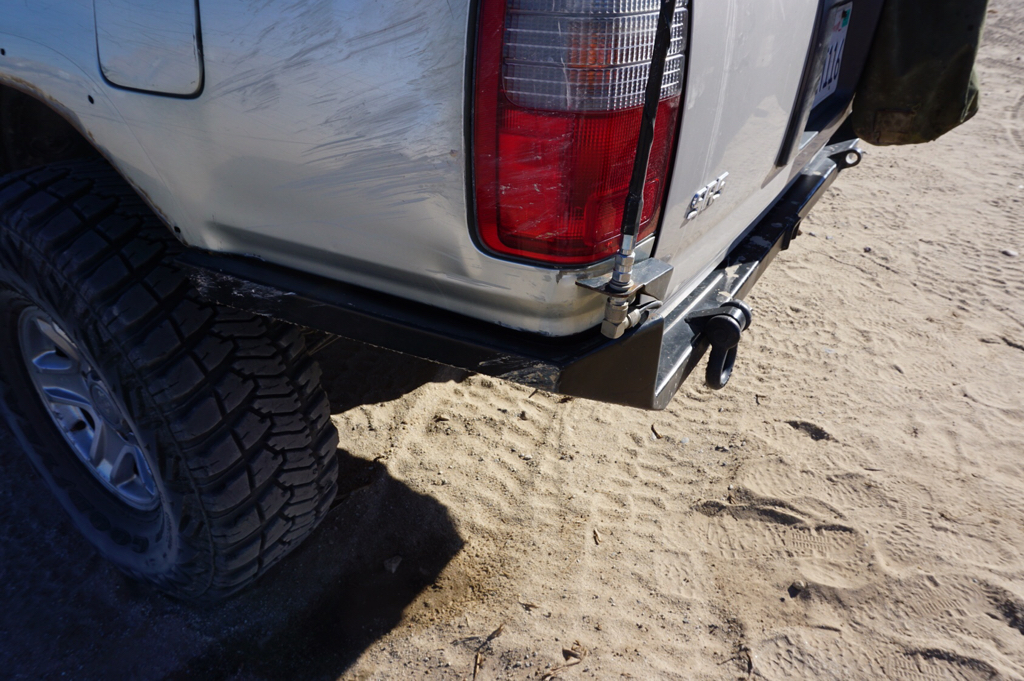

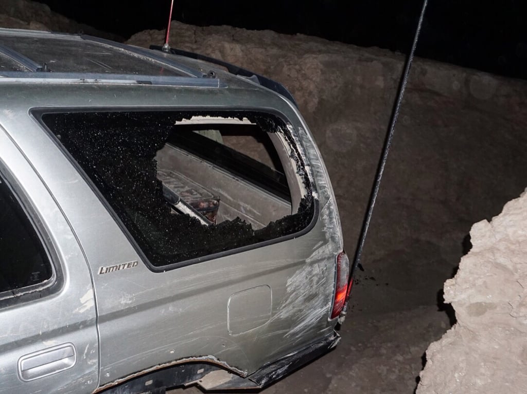

This was right after blowing out my window and hitting the quarter panel again. The notch finally opened up enough to get out and check it out.

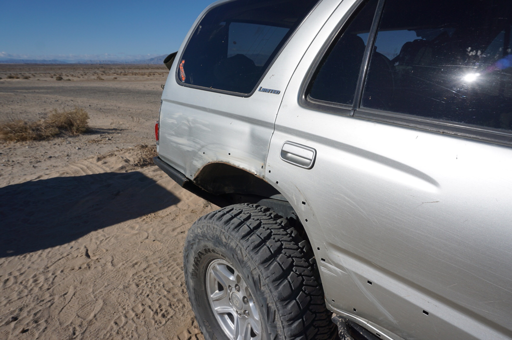

The new dent above the fender from Friday night

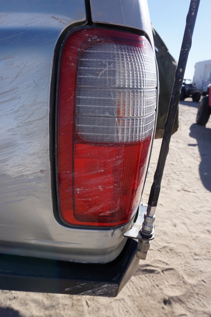

Tail light got some fresh cracks in it.

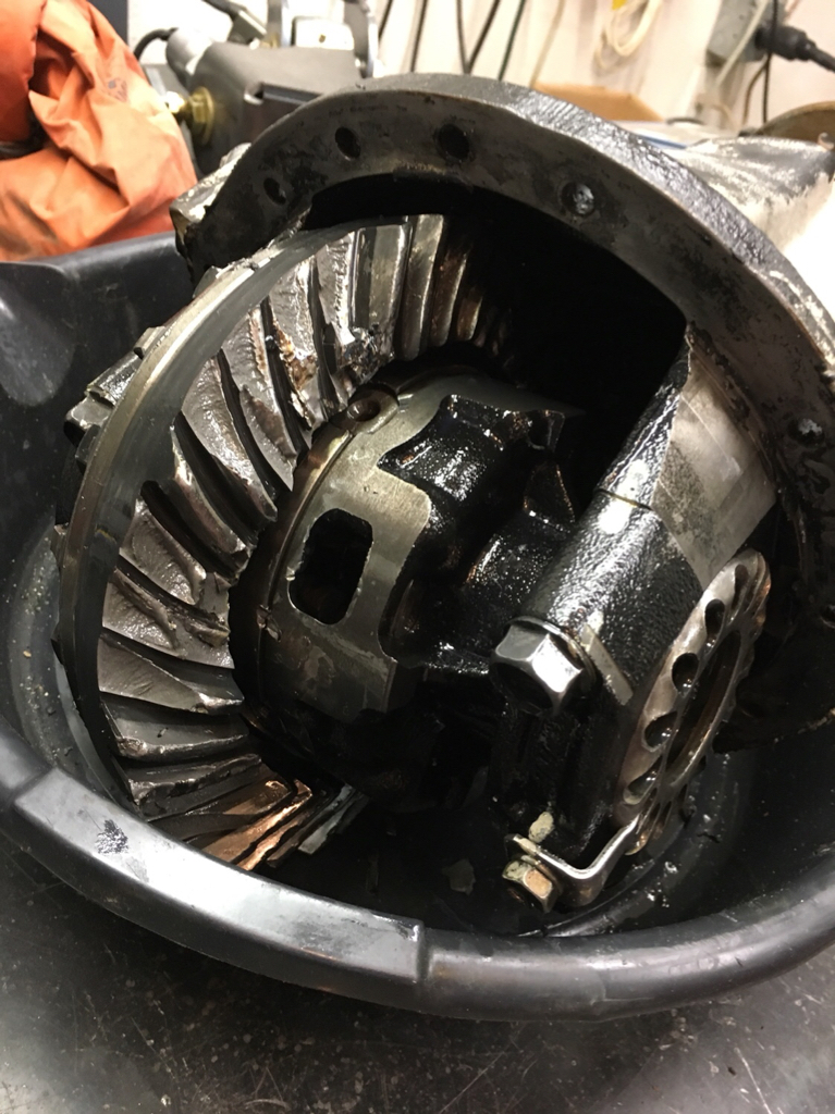

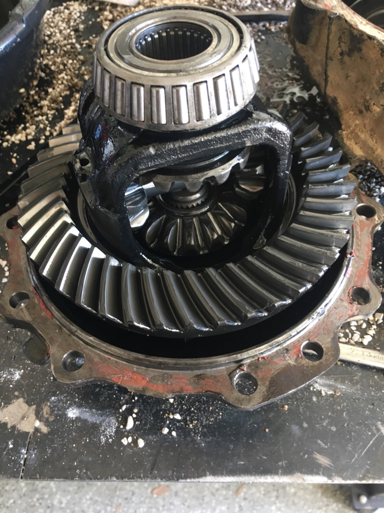

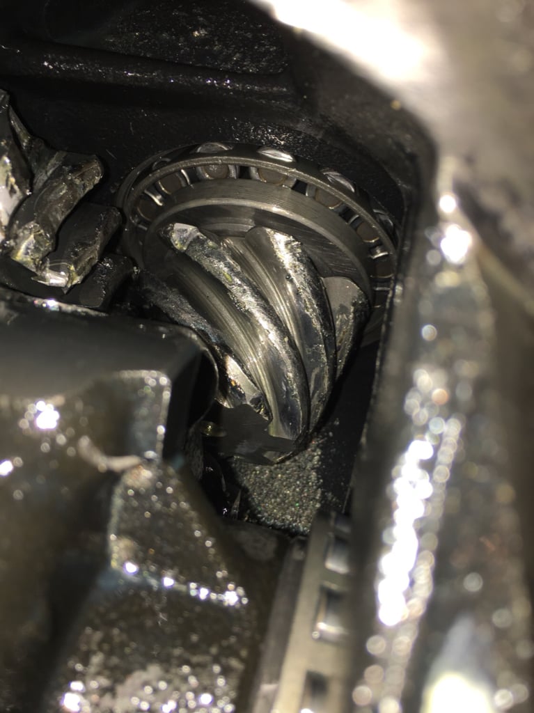

Blown out ring gear.

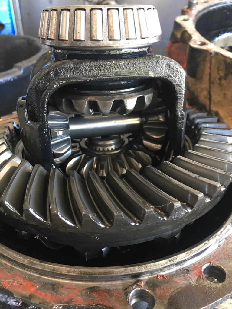

Pinion has a couple small chips but no broken teeth.
Video of the broken diff. No idea how this happened.

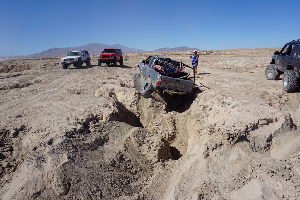

Those 40” tires make the ledge look tiny.

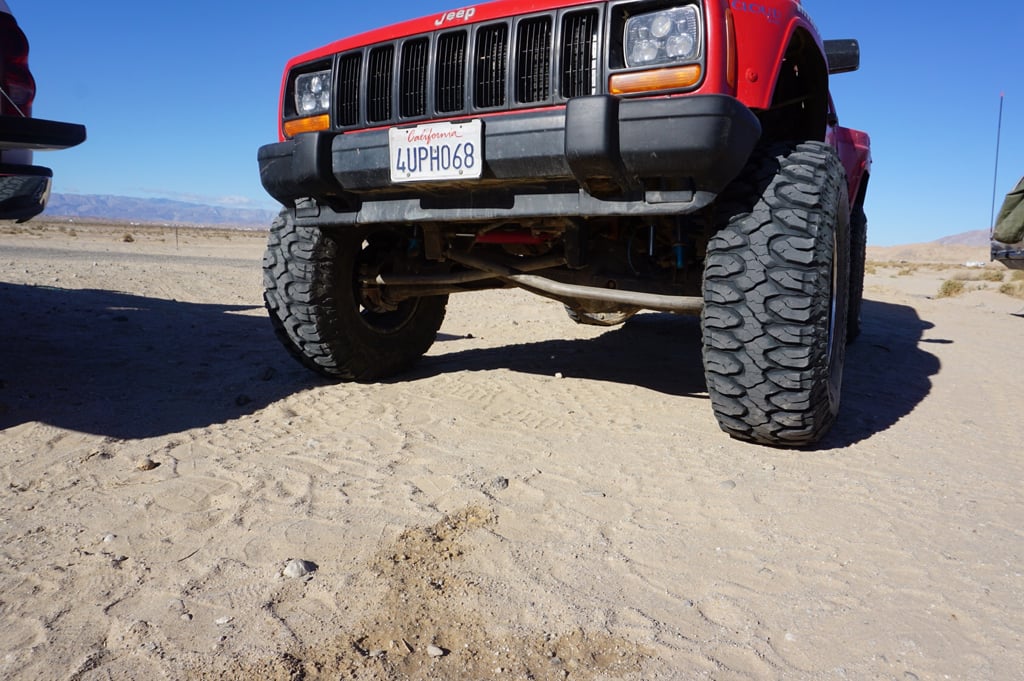

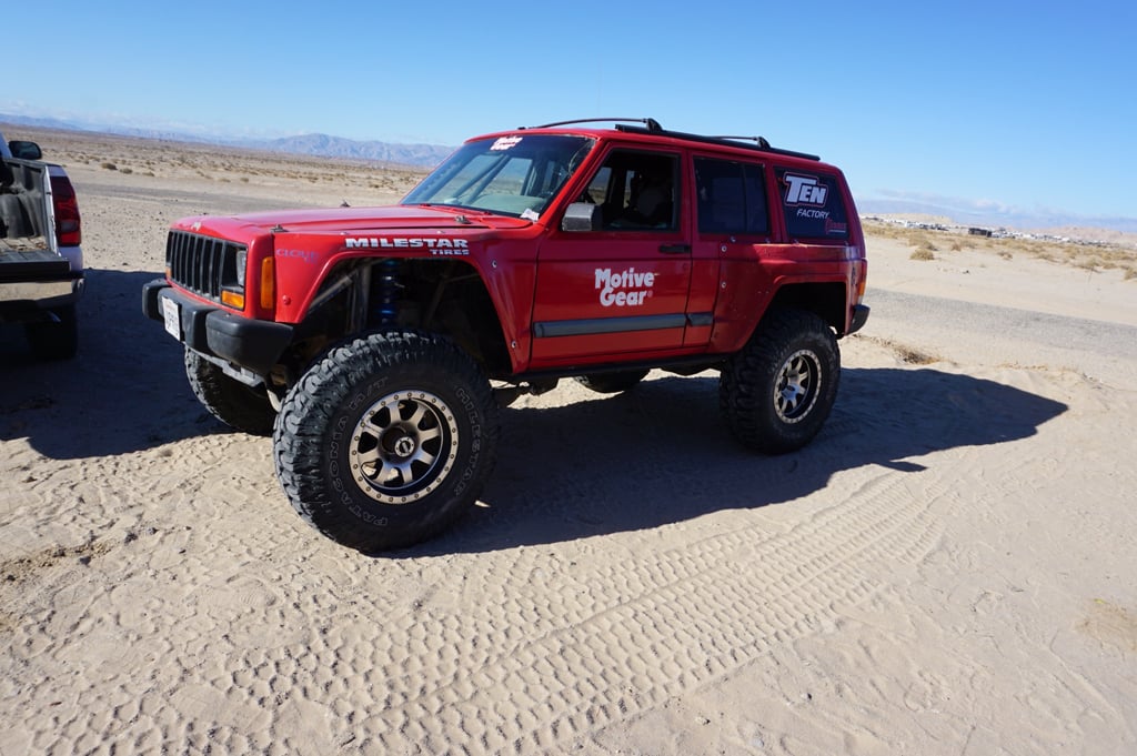

A TTB swapped XJ [emoji1619]
Some inspiration right here!
Talk about getting after it. Your living up to my mantra. Build it, beat it, break it, repeat.
Are the bearing caps bolts still tight? Maybe they came loose allowing play in the bearing then total destruction?
Seems like our windows always take a beating. I've seen quite a few of these on this forum, mine included. Always wanted to weld up some armor to protect them.
Not super proud of it at the moment. Sometimes I'd rather just spend my time wheeling or upgrading, not repairing breakages again and again.
The bearing caps are still tight. All the painted bolt torque marks were still lined up.
I spoke with ECGS today and they said - "All the pressure is on that side. When it shock loaded it jumped the threads, that’s why the lock is still in place but bent way out. It never spun just shot out.
You can send it in again and we will go through it. Be advised do to the short duration of the diff life you need to either get a bigger diff or change driving style.
What size tires are on it?"
I'm not sure if they believe me when I told them the hill I was going up wasn't bad enough to cause this IMO.
It would be cool to have some sort of way to protect the window, but anything I can think of would look retarded or just get in the way. I should probably just pay closer attention to things when I'm wheeling in tight situations.
wait you took out another diff?
Yeah I don't feel like this one was completely my fault though. Could be, but I don't think so. :shrug:

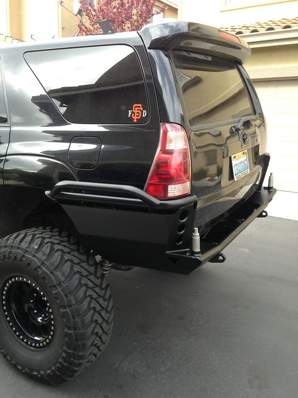

4x4labs makes a rear bumper for 4th gens and they have 'side sliders' on the sides of the bumper wings. Should help push your rear end off of obstacles.
3rd gen rear bumpers aren't as huge as the 4th's but they still might help. Should be easy to weld on to yours.
I've seen those things before but I doubt that those would have helped in this particular situation since I think the body actually leaned into the wall pretty hard, not just rubbing along it. Some of those tubes seem like they would just end up getting in the way and getting caught up on stuff. Good idea for folks that want to protect themselves from body damage, but I just don't want to break windows really. I'm assuming you are talking about something like this? https://forum.ih8mud.com/attachments/rearbumber2-jpg.55693/
Yes, but more angled outwards to push off of trees. Like you said though they could get caught on more stuff but 3rd gens are narrow right? I've seen a guy weld them on at even more of an outward angle than this:

Lastly and most importantly was fixing my diff. Initially I was going to have a really good buddy fix it for me since he knows how to set up a diff and was is able to get a really good deal on some gears and install kit. I figured it would save me some time since shipping the diff back to ECGS was going to take 4 days minimum each way plus time to get it fixed there. He let me know that he would be super busy all week at the MINT 400 and would be able to help me on Sunday or Monday, and should have the parts by then. Well I spoke to him Wednesday right before he left for the MINT 400 and haven't heard back from him since. No response to my calls or texts. The whole idea for me to go through him was to save time. Now I can't expect to wait on him any longer so I will be shipping it back to ECGS tomorrow. Luckily they are super awesome to deal with but now I will still be looking at another 2 weeks minimum to have my diff back in.
I'm pretty frustrated right now. Mostly at the whole diff thing. What a waste of my time!

And tell ECGS to set your diff up correctly this time [emoji849]

Well as for updates, not a whole lot going in over here right now. Window is fixed. The new rear end is back in and just about done with the 500 mile break in. ECGS is still super awesome! Not only did they rebuild my diff for the second time, but they also sent me 12 quarts of Lucas Gear Oil for me to flush the fluid after 500, then every 1500 miles after to make sure all the shavings get out. They absolutely did not have to do that, but they wanted to make sure their customer was taken care of. If you haven't heard me say it already, I'll say it again. If you are looking for gears or lockers, send your stuff to ECGS. They have not only the best warranty policy, but they also have the absolute best customer service I have ever dealt with as a customer.

Well now on to some somewhat good but also extremely frustrating news. I finally got around to pulling the front diff back out again. This time I actually split the clamshell to assess the damages. So, I was expecting to find some broken spider gears or something else broken. I opened it up to find that everything seems to look perfectly normal. I cannot find a single flaw in that differential. That's pretty good news in a way, but it is frustrating that I still have not pinpointed the cause of my CV's binding and breaking. What is weird is, I didn't do anything different to anything when all this started happening. I was out at the desert and broke a CV like I have before, but this last time I couldn't keep the CV's from breaking anytime I was in 4WD even on flat ground. My only other though is possibly something in my T-case ins binding the front output shaft side of things. Idk... For now, I will be cruising around with no front diff until I figure things out. 2LO FTW
