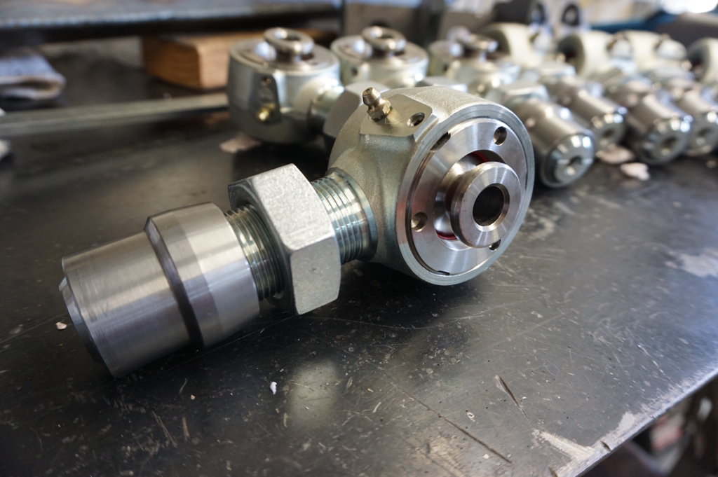

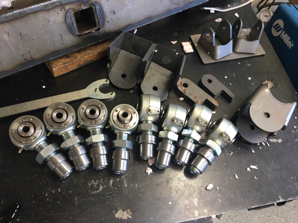

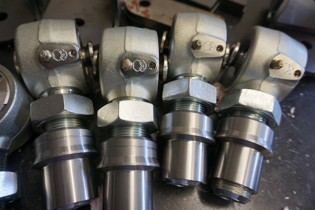

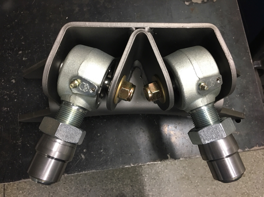

Speaking of 4-link... these came in yesterday [emoji1591]
These things are beefy for sure! Super stoked to get this project started. Got a lot of work ahead of me to get things going.
The list includes:
- move and replace my muffler to where my 2nd cat currently sits
- cut out the crossmember behind the t-case and make a new one out of 2” x 6” x 3/16” rectangle tubing.
- cut out the rear crossmembers, and make a new crossmember a few inches back.
- cut out stock coil buckets and move them a few inches back.
- cut off stock link mounts off axle and frame
- cut off stock bump stops and move them a few inches back. (Or possibly upgrade to hydro bumps)
- cut out wheel well and bumper to make room for the axle to go back a couple inches.
- make/buy truss for upper link mounts to weld onto.
- mock up, weld and finish mounts and links.
- head to the desert.[emoji1619]

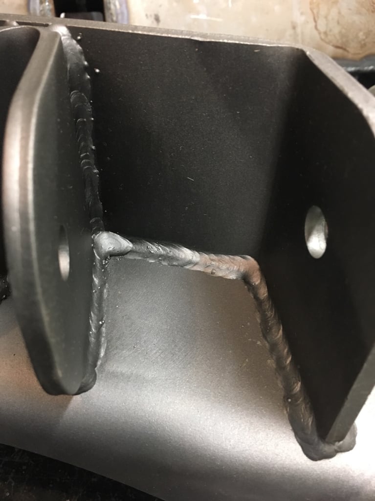

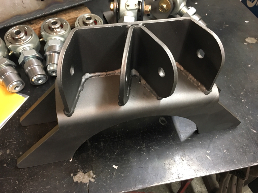

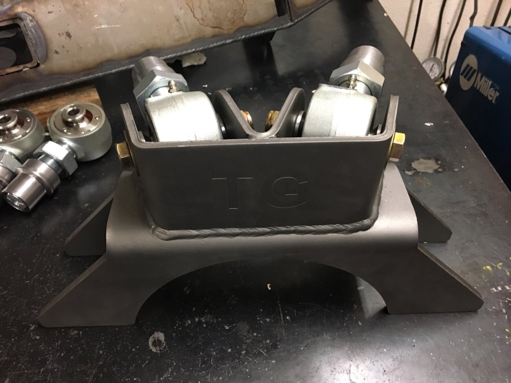

My Trail Gear upper link tower came in today from Low Range Offroad. It’s definitely pretty damn beefy but just slightly throws a wrench in my design. It’s overall height is about 1.5” higher than I was hoping for. I can grind it down a .5” or so, or modify it to make it a little lower like I originally had planned. But that’s probably not gonna happen. More work, and I probably won’t have a whole lot of time to knock out this project, which is why I’m not making all these parts myself in the first place. The good thing though, is that it raises my roll center about 1.5” which will be super nice for controlling the body roll. The part I don’t like is that it limits my future up travel since the upper links will contact the body sooner. Right now I have about 6” of up travel at ride height, my future plans were for my up travel to be around 9-10”. Now I’m probably going to be stuck with 8” at the most without cutting into the floor of my cargo area. I really don’t want to do that if I can avoid it.
The tower being that little bit taller also changes my anti-squat, making it even higher. This causes me to have to mount the lower links further forward or lower on the frame side to level out the lower links and lower the A/S. Therefore less ground clearance. Really it’s not that big of a deal but I’d rather see it go the other way if possible.
Another thing that kinda bugged me about this part is that it came pre-welded, with kinda crappy welds. I would have rather had it come as separate pieces and weld it up myself. Oh well, it’s not that big of a deal.
