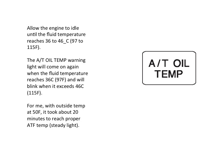

Can I skip the ATF Temp Check Mode, & read tranny temp on my Ultragauge blue instead?
Steps for ATF Temperature Check:
13. The fluid temperature must be between 36C (97F) and 46C (115F) to accurately check the fluid level.
So here's my question... Does activating the ATF Temperature mode do anything special, OTHER THAN CHANGING THE BEHAVIOR OF THE DASH LIGHTS TO LET YOU KNOW WHEN THE TRANSMISSION FLUID IS IN THE CORRECT TEMP RANGE?
Here's why I ask. I have an Ultragauge II Blue, and it reads out Transmission temp fairly accurately. So, I can already measure my temp, and wait until the fluid is between 97F and 115F to check the fluid level after a fluid replacement.
So, my only concern is if activating the "ATF Temperature Check Mode" does anything else in addition to using the dash gauge to let you know the transmission fluid temp. For example if the Temp Check Mode caused the fluid to circulate differently through the tranny, or allowed fluid to flush out the valves, then I would still need to activate this mode, but if all it does is let me know the tranny fluid temp, then my Ultragauge Blue will give me that information easily, and I can just warm up the truck in place and not deal with the jumper wire, the song-and-dance with the shifter lever, and the cryptic on, off, flashing behavior of the lights.
Anyone with knowledge on this would help me a lot. [MENTION=66389]BlackWorksInc[/MENTION] , do you think you could shed some insight (or anyone else)... I know your a competent tech who's top notch on these issues.
-Phil
No. In fact,
http://www.toyota-4runner.org/4th-g...r-ways-check-ws-transmission-fluid-level.html
But if you're confident in your ultragauge, it will be even easier for you.
As long as you work fast and you're confident that your temperature readings are correct then you should be fine. My understanding of the ATF Temperature Mode is that it activates or deactivates other things that keeps the transmission fluid in the correct range for a longer period of time.
I'm not a mechanic, however. I just ran across that tidbit in another thread.
No. In fact,
In addition to the ultra gauge, I also have an IR thermometer, so I can take readings as indicated in your thread and cross check the IR with the ultra gauge.
Thank you for the link, and more importantly, thank you for the research you did in that link.
JB, you sir, are a gentleman and scholar. :thumb3:
Check out the thread that @JB created and linked to.
No need for temp check mode: Eas(ier) ways to check WS transmission fluid level
It's excellent work, and I think it gives sound advice on an Easier alternative method for checking the level of the trans fluid. I'll cross check my Ultragauge reading against my IR thermometer reading, and if they are close, then I can just rely on my UG.
Anyway, JB's thread should answer all of the questions. Great work JB. Thanks!

Well shit. Owning an 05 gx470 and an 07 4runner has just put a wrinkle in my knickers. I used the temp check range of 115 to 130 recommend for the gx. Not the 97 to 115 recommended for the 4runner. Guess I will have to bite the bullet and do the temp check and see where I am at tomorrow morning.
Ok so a couple of things. 1. My odb done and torque app measured 98 degrees right after the light went off so now more using that stupid wire, that was weird! 2. When I opened my overflow and nothing came out. So I turned it off and added 1/2 a quart. When I started it up I hot the whole 1/2 quart back. So I guess I was good to go.
Not sure where you got the 115~130°F range from, the FSM (and TSB for updated temperature ranges for both Lexus and Toyota) specify 97~115°F as the temperature tech range. It's the same transmission for the GX470 as the V8 4th Gen.
[MENTION=70631]pjbrownva[/MENTION]
As far as I can tell, "ATF Check Mode" is meant for "intelligent tester" (scantool); it doesn't really explain what it does exactly as far as I see in the FSM. But if you're just shorting the two pins on the OBDII connector to get the dash light to turn on, it's not needed.
Using an IR Thermometer on the fluid pan isn't super accurate, but since you have about 18°F to play with; you should be fine if you shoot for the middle of the min/max.
