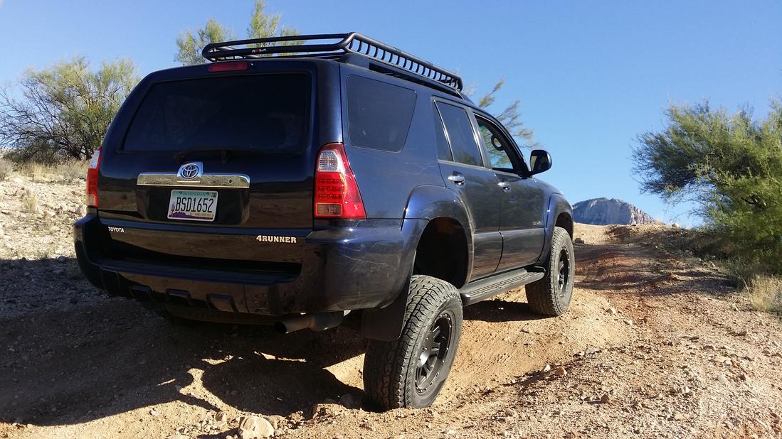

well people, after several more obstacle tests I have determined that Atrac just plain sucks! I am saddened to say that a 2010 Explorer, and all honda/acura awd systems I have tested performed better when 2 or more wheels start to loose traction. I now have zero confidence in atrac and am too worried to try a true track so the aussie it is! Just ordered it though amazon and everything cost me about 1000.. I have not had the time to take someone with me who could record some the testing I did but I will just leave you with this picture and let you know that it took 4 attempts to make it up this small hill and it finally made it after I began the hill at no less than 10mph and just stayed on the gas and Atrac barely was able to keep it moving.. Just to compare, neither my 2005 LR3 or 2010 LR4 ever broke a sweat getting up this thing.. I was alerted to the weakness of Atrac many months ago when I was guiding by friend who just bought a brand new taco TRD offroad (2014 model year) and damn near had to activate his locker to make it up this tiny hill.. I just though it was just him at first.. sadly it wasnt
Yeah, cross-axled and stopped is the worst case scenario for the way the 4th gen atrac works, but I gotta ask just to make sure -- are you giving it some gas and just holding steady while letting the unweighted tires do their obligatory 1 or 2 spin rotations before the atrac grabs and the truck vibrates and sounds like a giant coffee percolator before crawling forward?
If so, pardon the interruption but if not, give it a try.
On a separate note, some aggressive tires at about 18psi would probably do as much or more for you there as a rear locker. Could be I'm talking out my a$$ as I've never had a rear locker, but I'm also unfamiliar with the severity of problem you seem to be describing.
I've not had a chance yet to test ATRAC in that situation, since I just got my '06 in December. I do know, however, that cross-axled like that was a "stop dead in your tracks" situation for my '94 until I put the Aussie locker in the front. With the locker you don't even notice the obstacle - you just keep going with absolutely no drama.
My guess is OP won't be truly satisfied with anything but a locker - might as well pony up and do it.
as i got into bigger and bigger rocks my atrac just couldnt help enough (a lot of stop and start on obsticles and what not), so i bought a used elocker from a 96 runner on ebay for 330 bucks. had it rebuilt and installed it with a 12vguy harness. the difference is night and day vs just Atrac. honestly modifying the housing wasnt too bad. just 2days with a dremel and a good drill was all it took. and i love it. however the actuator does take some maintenance to keep it 100%, but being a EE student helps with understanding what the issues could be and how to address them, so its not a big deal to me either.
