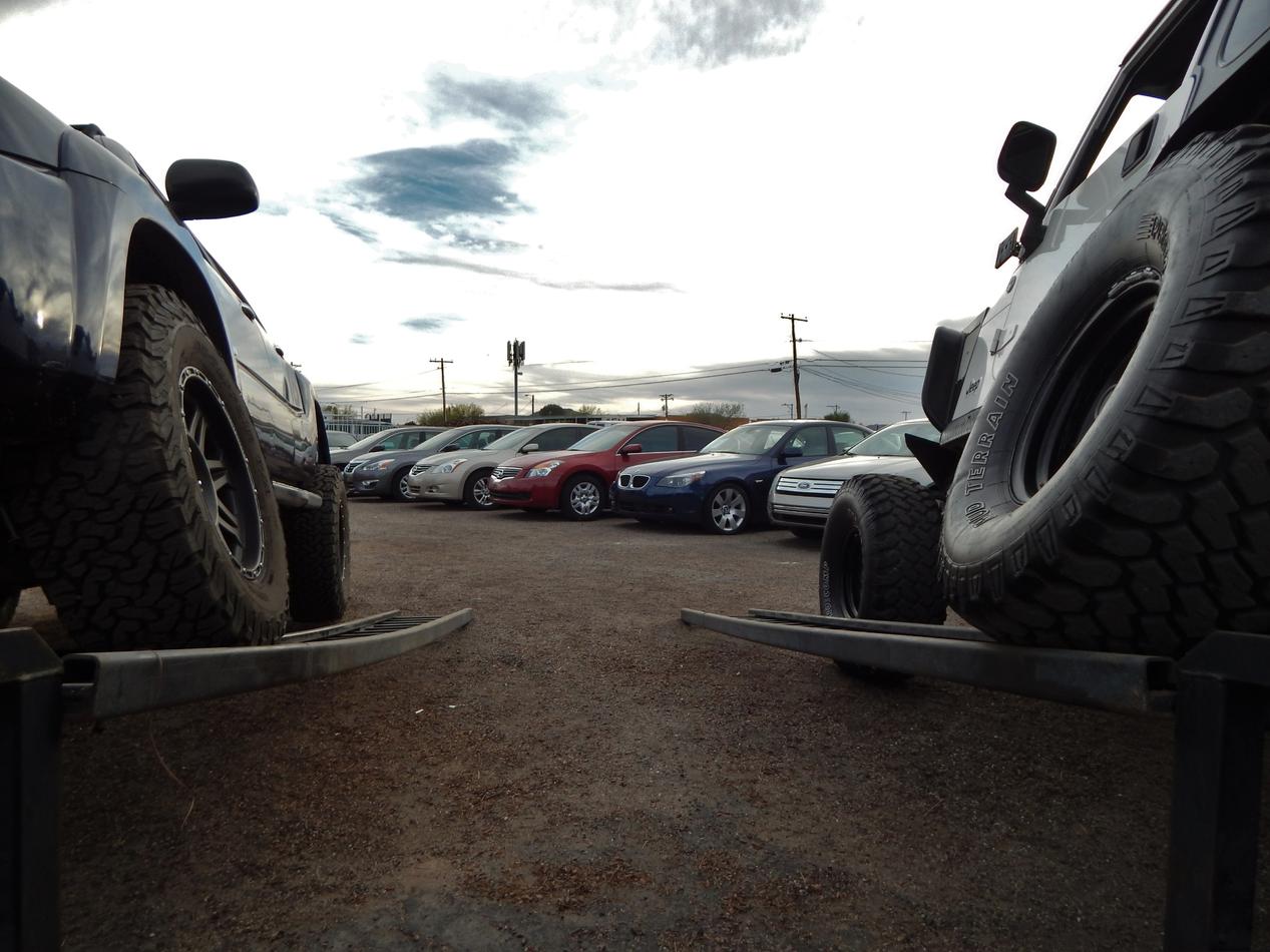

well people, after several more obstacle tests I have determined that Atrac just plain sucks! I am saddened to say that a 2010 Explorer, and all honda/acura awd systems I have tested performed better when 2 or more wheels start to loose traction. I now have zero confidence in atrac and am too worried to try a true track so the aussie it is! Just ordered it though amazon and everything cost me about 1000.. I have not had the time to take someone with me who could record some the testing I did but I will just leave you with this picture and let you know that it took 4 attempts to make it up this small hill and it finally made it after I began the hill at no less than 10mph and just stayed on the gas and Atrac barely was able to keep it moving.. Just to compare, neither my 2005 LR3 or 2010 LR4 ever broke a sweat getting up this thing.. I was alerted to the weakness of Atrac many months ago when I was guiding by friend who just bought a brand new taco TRD offroad (2014 model year) and damn near had to activate his locker to make it up this tiny hill.. I just though it was just him at first.. sadly it wasnt
You don't look like you're aired down, and those tires don't exactly look like ATs. To be honest, I've done harder than that and made it up no problem in 4lo and 1st gear w/ center diff locked. I'm talking loose rocky terrain with boulders in the middle of it going straight up the side of a hill.

Yeah, he's convinced he needs a locker. I think better tires and aired down would be a much much better choice as well.

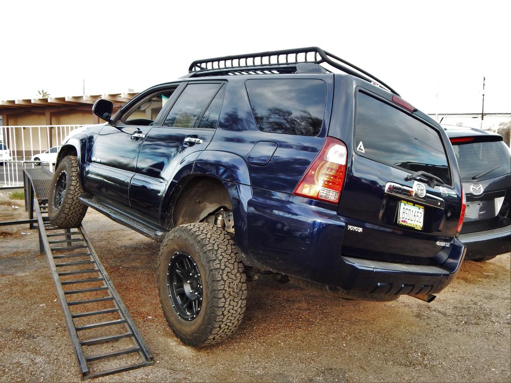

just a quick update, got my ARB rear locker in and naturally it made a huge difference.. Got my new BFG A/Ts KO2 33" tires, and replaced the rear Fox shocks with Icons..

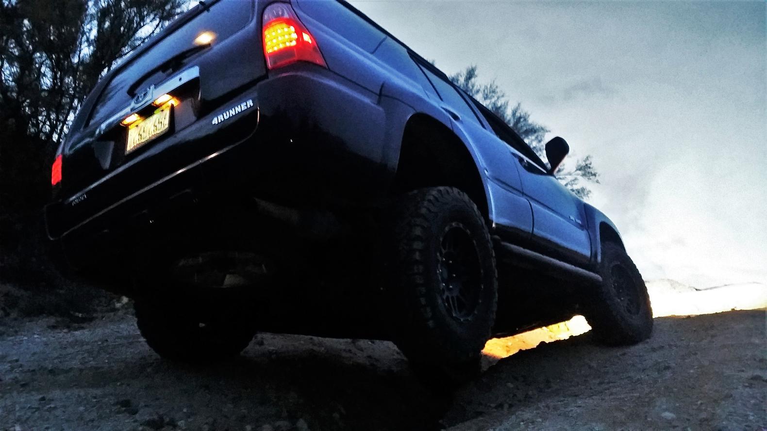

Here is a little something for now.. sorry its so grainy but it was way after sunset already and pretty dark out..

shot a couple of videos in the last few days, both the 4runner and the land rover.. just need to put them together, add some comments and I will post them as soon as have more than 30 seconds to my self.. hopefully soon!

This is with the MT rear + extended icons and both front/rear sway bars removed. Pretty sure your rear tire wouldn't be in the air in that last picture with this setup.
