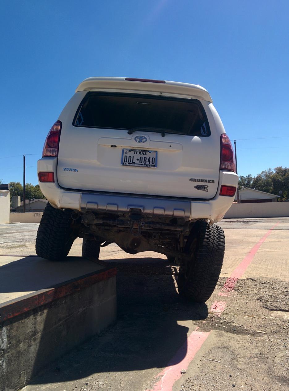

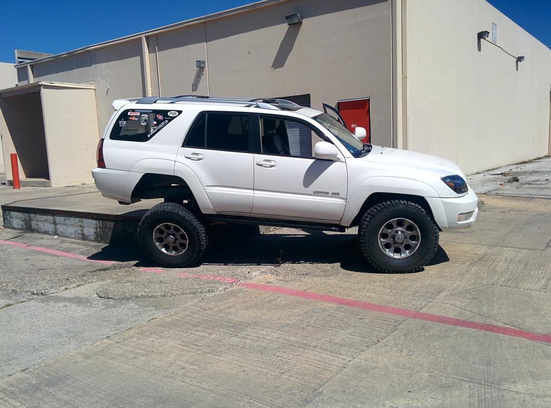

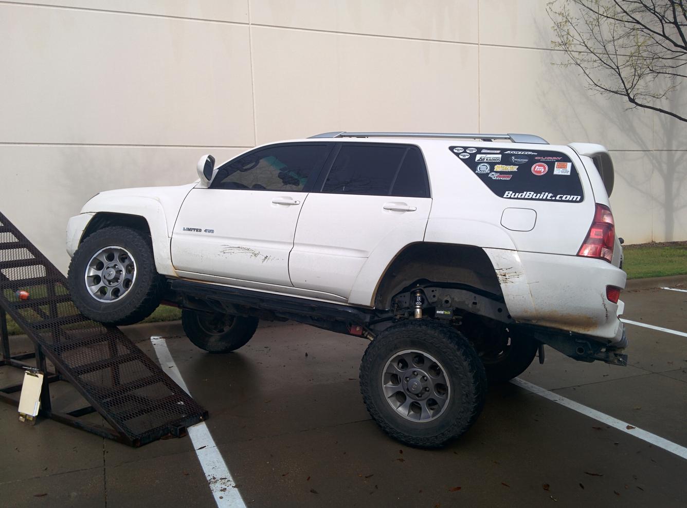

We doin MT LT now? We're doing MT LT now. Still need to max out the suspension with the 35s. I just don't want to drag the ramp out, so I have to deal with partial flex on the dock

Investing in a high quality suspension with the most travel in the most efficient package is always a good decision. All my articulation plus my elocker allow my to run circles around my buddies and my dad's 5th gens. And a good amount of jeeps. I'm not just saying this for you but anyone wanting to know more. If a locker + install isn't in the budget a good set of tires aired down to ~15 psi plus suspension travel will help imensily
